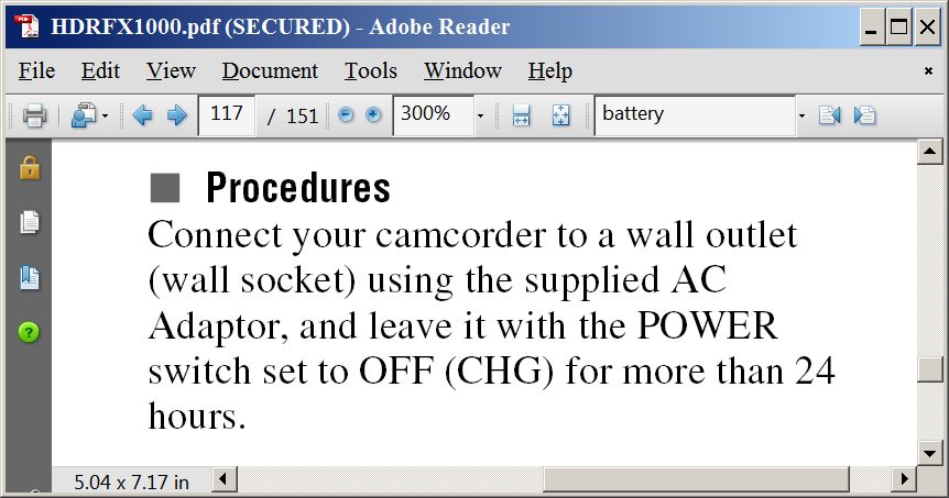

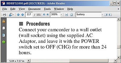

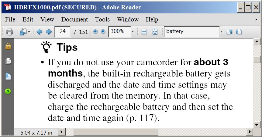

Pages 24, 117 of your manual.
FX1000 not keeping date & time-batt.jpg   FX1000 not keeping date & time-batt2.jpg
