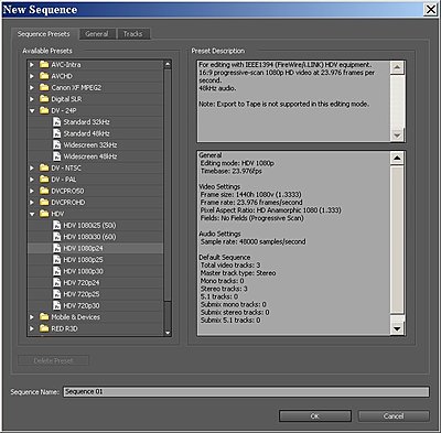

I can see now that my mistake was shooting in 24 p, and once I did that PE was an unsuitable software program.
Chris has offered a glimmer of hope that I might run all my tape through some third party program, but that seems to be pretty unwieldy, especially since this is neither the part of filmmaking I do best, nor enjoy most. More chance for error and frustration. I downloaded a trial of Premiere Pro, and I see I can export in DV 24 p. Problem solved, right? (Except for the difficult conversation with my wife.) I'd hoped I could import in the right setting, but I don't see this option amongst the presets.

Sure, the presets exist. Once you start a new project and name it, Premiere gives you a choice of formats, either DV 24p or HDV 1080 24p. Just click on the appropriate format and it will drop down. Choose what you want and you are off to the races.
