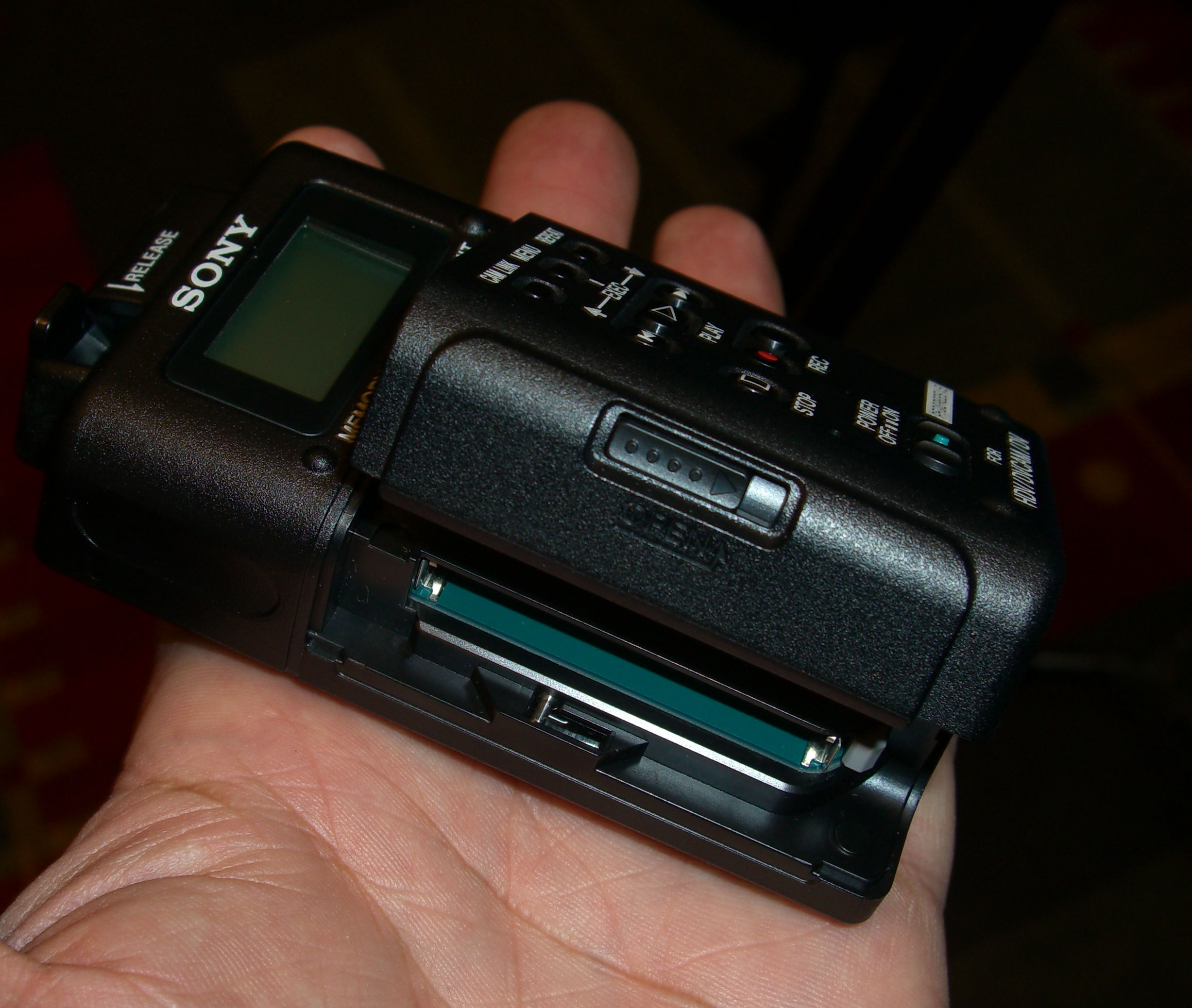

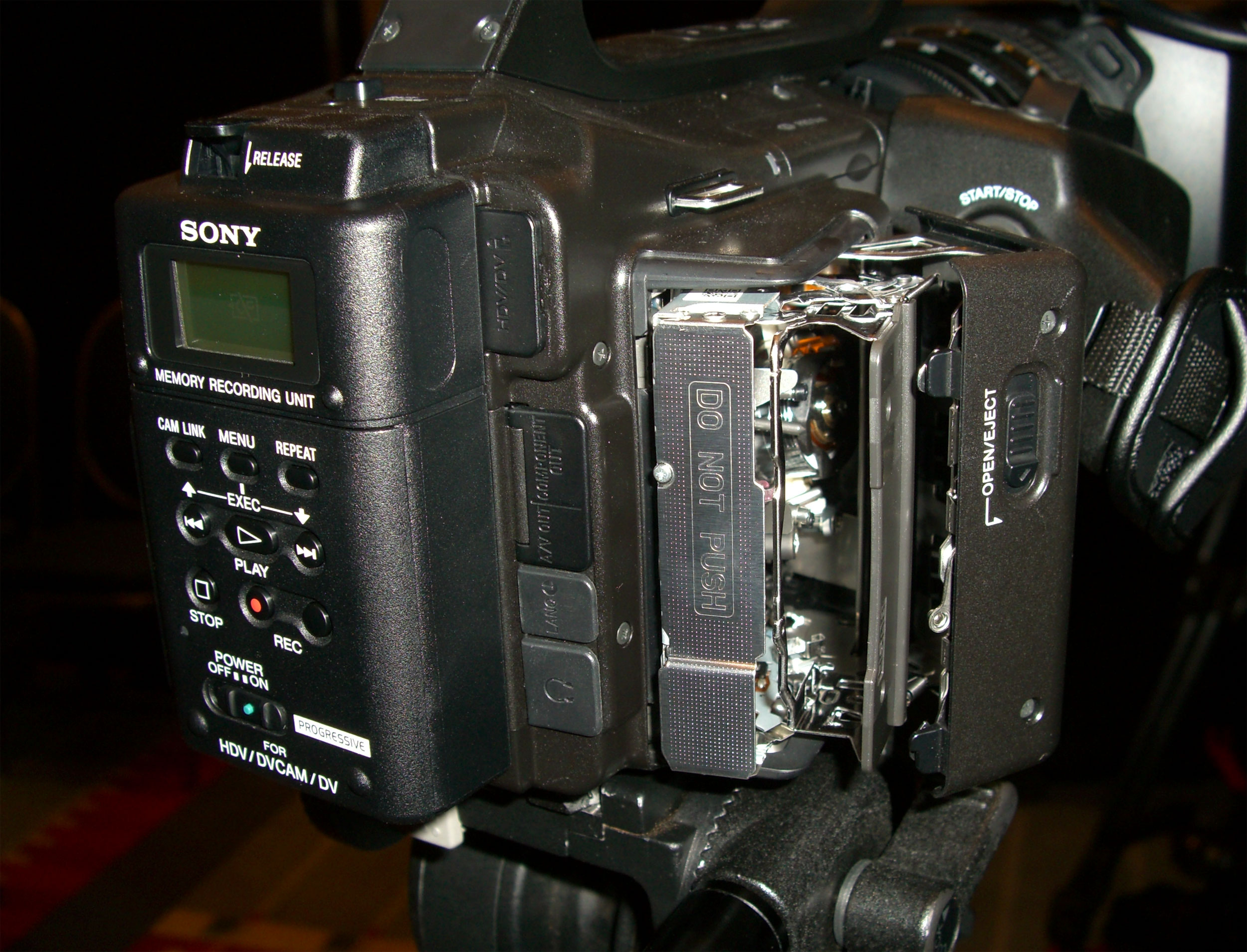

No, it won't be. Its a special item that hooks directly to the Z7 and S270 with a proprietary interface.
Here are some pictures I took at GV Expo.
Flash vs. SxS: what's the difference?-cimg1315.jpg   Flash vs. SxS: what's the difference?-cimg1317.jpg
Flash vs. SxS: what's the difference?-cimg1318.jpg
Alexander Ibrahim
http://www.alexanderibrahim.net

But the Sony brochure for the camera and CF card unit says:
"The Memory Recording Unit can be used as an external recording
unit, just like the HVR-DR60, by attaching the supplied cradle that
has an i.LINK connector, battery attachment and DC power
input. "
It would seem to me that you might be able to connect it to the i-link IO of any DV or HDV camcorder. Just a guess on my part.

That's not correct Alexander, the CF recorder will work with other Sony HDV devices that have a firewire port, just like the HVRDR60 does.
The CF unit comes with a cradle you can dock it into that gives you a firewire connection and a slot to power it using an 'L' series battery. I think the cradle even has a cold shoe on the bottom so that you can attach it to the back of a camcorder.

I don't know what part you were objecting to, but I really did take those pictures at GV Expo! :)
Seriously, I was only reporting IN NOVEMBER what Sony SSE's told me. It was early pre-release information. In fact I think that was the first day or two they showed the camera in public at all. So please- don't shoot the messenger!
I specifically asked about this, and even lamented that it was "too bad." A cradle is a good idea.
At that time there was no evidence of a cradle- it had to be attached directly to the camera at the time. I was also told that the only way to get one of these units was to purchase a camera that included one. Something else I lamented.
As far as the state of affairs now, I don't know.
