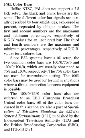

Are Sony Z7 colour bars 75% or 100%?
I've got a broadcast monitor with a 75% or 100% switch for component input, if I am giving it a colour bar feed from a Z7 should it be set to 75% or 100%? Would this differ from a feed from Final Cut through a Blackmagic Intensity Pro component cable?
Jon Oneill is offline   Reply With Quote
Old October 15th, 2008, 09:05 AM   #120
Join Date: Jun 2008
Location: Nottingham UK
Posts: 37
I found this: 75% for transmission, 100% for testing between equipment...? I'm still not sure which one...?
Sony Z7 / S270 various topics-palcolourbars.gif
