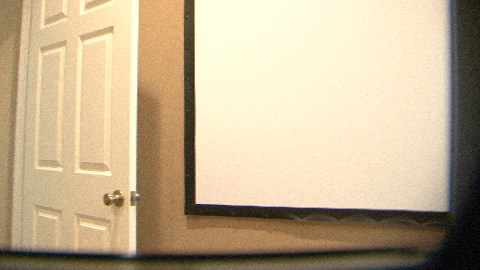

I've attached an image and a quick video of what is being captured. Notice the how the camera now can see the lens cap on the right and bottom? Its the exact opposite when the camera turns on and then it jumps.
The video is at: www.chaddyleproductions.com/2008/Untitled.mpg

I've never known a Z series camera 'see' the lens hood at its widest zoom setting. Also, having seen some jedi-style image shifting by OIS when I accidentally vignetted a shot using a 1.6x extender, I'd say that in your movie, OIS isn't 'on'. It's almost as if the entire lens axis is off to the bottom right.
It has all the hallmarks of a 'return to home base' to me.

I've tried turning OIS on/off and all of the other possible options. I even took the lens hood off, but I could still see a corner of the lens. Something is out of what (sorry for the technical term).

The Sony tech said that it was due to the OIS coming off its gimble or the OIS circuitry. In order for the OIS to be knocked off its gimble, you would probably also notice a big dent in the camera.
