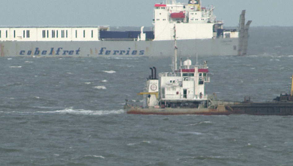

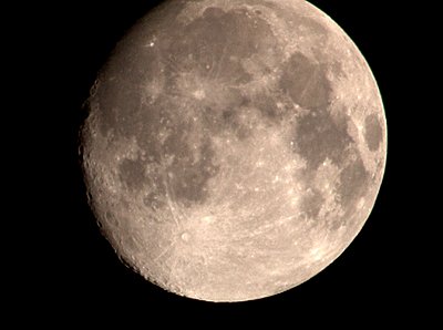

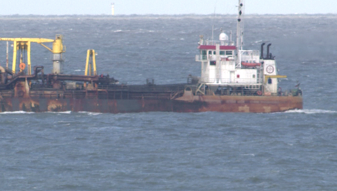

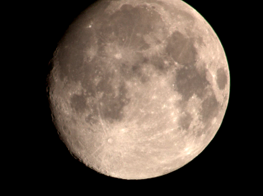

Old October 16th, 2008, 12:21 PM   #52
Posts: 963
As I promised, I tested the Z7 with a Nikon 300mm f4,5 manual lens and these are the results. No chromatic abberration as far as I can see, but some turbulance of the air that causes temporary unsharpness. Generally, I'm very satisfied with the results of this virtual 2100 mm-lens!
Alpha mount adapter-nikon-300-mm-moon.jpg   Alpha mount adapter-nikon-300-mm-ferry.jpg
