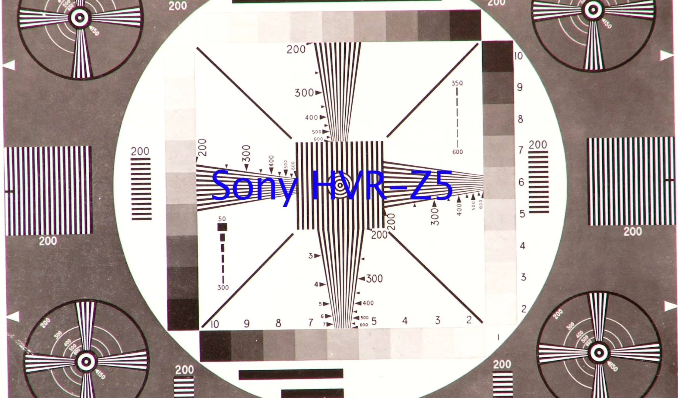

There is indeed noticeable barrel distortion in the full wide position, as well on the Z5 as on the Z7, but at full tele there is no visible distortion. I have a test chart comparison between the two camera's with the wide-angle concertor lens, but it's too big to post, and I have no Vimeo- or Youtube-account

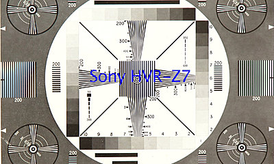

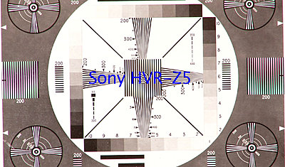

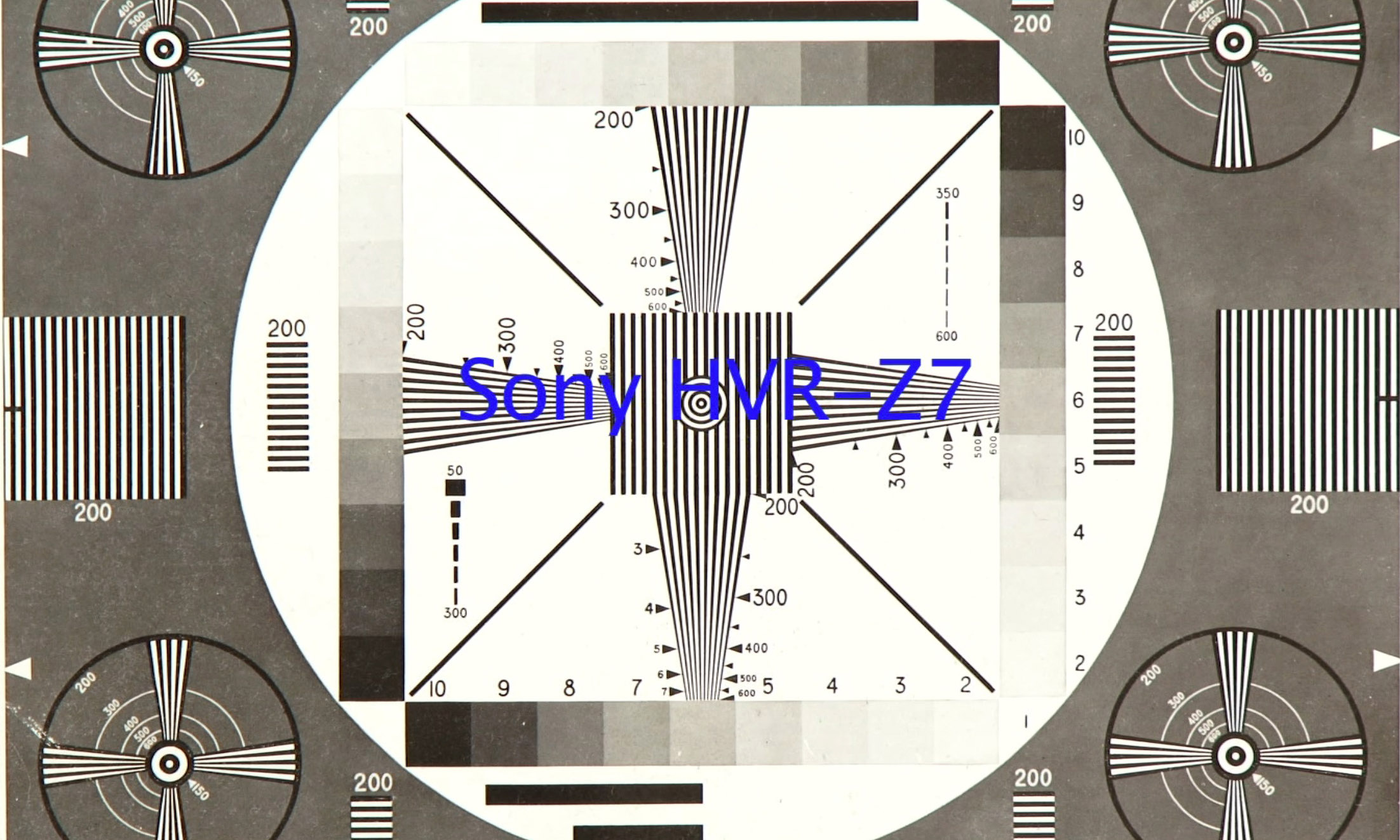

Here are two screenshots, of Z7 and Z5 with the convertor.
Sony VCL-HG0872K wide angle conversion lens-test-hvr-z5-wide.jpg   Sony VCL-HG0872K wide angle conversion lens-test-hvr-z7-wide.jpg

Did some more tests today and the convertor is - besides the barrel distortion at full wide-angle - very good. Superb sharpness, no loss of light, handy to use.
