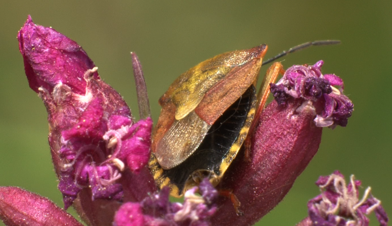

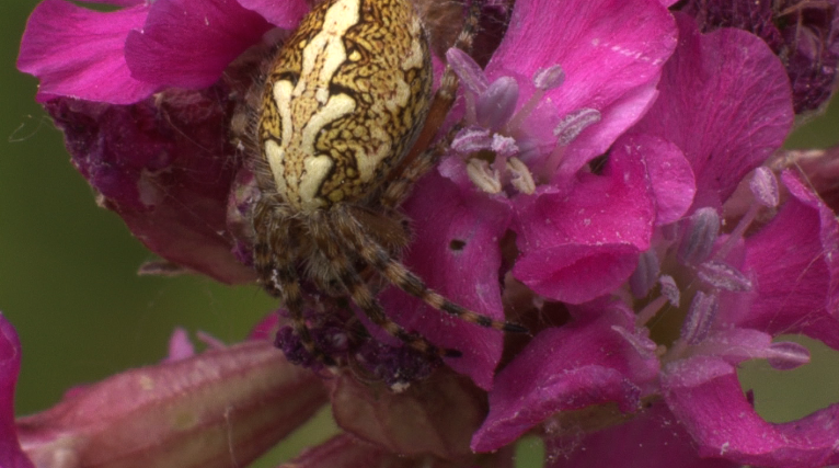

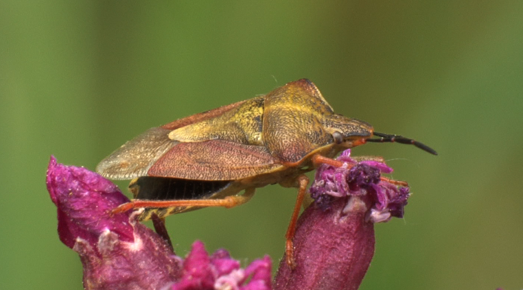

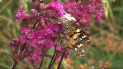

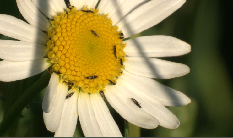

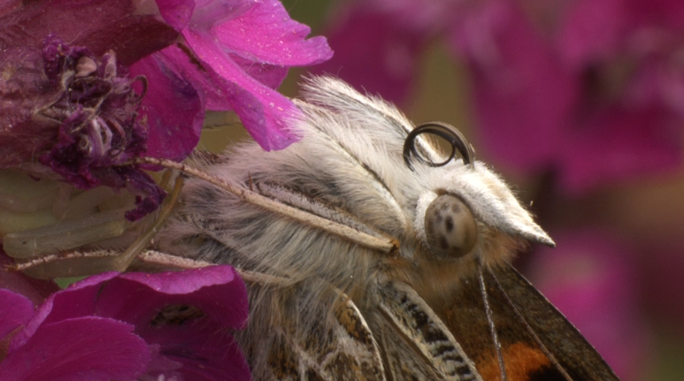

I am using my Sony Z7 with Sony adapter for Alpha lenses and I am mostly working with 70-300 mm/5,6 lens when shooting insects on flowers. I can say that I don't need an extension tube to get really macro of an insect appr. 5 mm big. The focusing distance is shortened from 3 m to appr. 1.1 m thanks to the adapter. I will post some screenshots soon.
Walter Uhrik is offline   Reply With Quote
Old May 30th, 2009, 01:36 PM   #9
Location: Kosice, Slovak Republic
Posts: 15
Some screenshots from my project
Here are some of my shots. I was doing them with Z7 and Sony Alpha 70-300/f5,6 lens, most of the time fully zoomed-in. All shots were taken from appr. 1,5 m. Insects pictured are barely bigger than 1 cm, some of them are less than 5 mm (black on yellow flower). The eye of the butterfly is about 2 mm in diameter.
