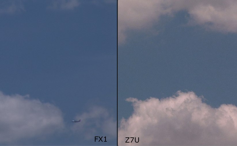

Ok, please bear with me. I just got my Z7U yesterday and am trying it out, trying to get comfortable with it.
I did some tests today outside, a guy riding on a bike. When I came back in to look at the footage I thought it looked pretty dirty, with a lot of compression. So I got my FX1 and went outside to do some tests.
Here's a screen grab of the sky from the FX1 and the Z7U. Both were shooting 60i and 0 gain. I white balanced on the same thing, but as you'll see it's not quite the same.
Please let me know what you think, it's causing me intestinal pain to think that my FX1 has a better PQ than the Z7U. I know this can't be the case, so I'm clearly doing something wrong. Please help me work this out.

Hi there,
Have you....
Turned all picture profiles off (indicated on lcd if on)
Got your ND filter set to '1' (and not half clicked in between somehow)
Got shutter speed locked at 60
Done the lens alignment reset thing (if you've taken the lens off while playing)
Just trying to think of some others for you...
John Knight is offline   Reply With Quote

Originally Posted by John Knight View Post
Hi there,
Have you....
Yes to all of the above. There just seems to be a slight compression haze across the image. Maybe that's CMOS, I don't know this is my first CMOS camera.
I'm mostly pleased with this camera and am in love with 30p. But I was a bit disheartened at the PQ compared to my FX1. Need to work at it some more I guess...

What are your other settings at?
Somethings wrong somewhere - should blow the FX1 out of the water... hmmm....
Well, tell me how to fix it. :D

Ok, went on my first real shoot with the Z7U today. Where do I take my baby on her inaugural gig? A plant where they manufacture shingles. It was dirty, dirty, dirty. I was so concerned with keeping my camera clean I didn't pay much attention to the shots. Just threw it on 60i with about everything in auto.
Came back and looked at the footage tonight, and I'm pretty pleased. I compared it to some similar stuff I'd shot with my FX1 and the Z7 is noticeably better. I'm not sure what was going on in my initial tests, but I think I've come to be happy with the Z7.
I am running it at -6 gain, so that might be helping some of that compression noise I was seeing before.

-3db on the Z7 is comparable, in my experience, to 0db on other cameras. -3 for us has been super clean.
