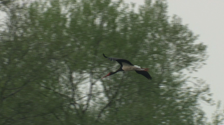

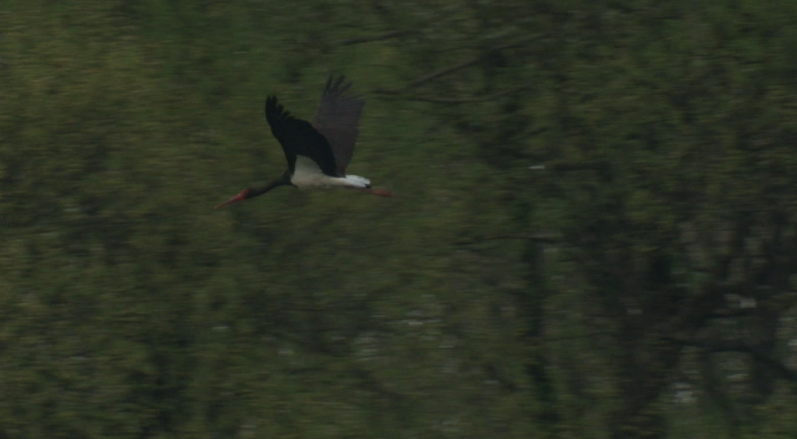

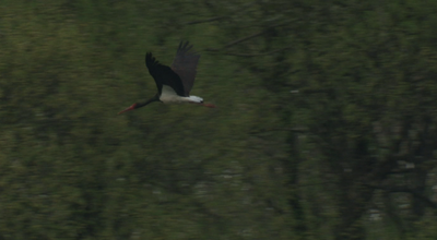

Here are some pictures, screenshots from FCP. I find manual focusing of moving birds (objects) with this lens pretty difficult. I will upload some other shots on Vimeo soon. As to the 5D Mark II I nave no information about wildlife shooting so far.
