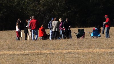

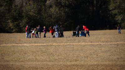

I did some tests with the digital zoom and the supplied 17-200mm lens. I shot fully zoomed in optically (200mm) and then added 2x digital (400mm). The fully zoomed in digital is soft and full of macroblock artifacts. To me it's not usable. I also did the test using the 50mm f1.8 prime with the same results. Image grabs from the 200mm test are attached.

Comparing the stills at the same size, in Photoshop , the digital version is more in focus and cleaner so it does a good job I think. I don't see any real problems other than some edges when blown up that would be acceptable I think in that regard both images look the same. What were the shooting parameters?

Were you looking at both at 100% in Photoshop? If you blow the non-digital zoom photo up to the same size (200 %) then you only have 2 Mega Pixels to work with and it looks worse. If you keep both at 100% then the no digital zoom image is noticeably sharper. I expected the same results as you would get in zooming into a 14mp digital still or 2 to 4K video and that is not what I see. This is even more evident in the moving video.
Here is a YouTube version of the video
You can see that as I zoom in the image softens noticeably. I think that if I kept the focal length at 200mm and physically moved the camera in to the 400mm digital zoom framing then it would be noticeably sharper.

Eventhough it's compressed I do see a loss in resolution when it starts to zoom in, ugh, I really hope I won't have to wait too long for the camera, there are some more user videos appearing on vimeo and youtube and some look great and some not, I saw one yesterday where there where quite bad interlacing artifacts but I saw others where there practically was no sign of it. Now the same with this digital zoom, Robert says it's no issue while I do see issues in Lee's video. As soon as I get the camera I"m out for a whole day test-riding it so I can see for myself what it actually can or cannot do.

I think some of the issue may be the fact there are no ND filters and it was a bright sunny day. I expect the iris was smaller than the sweet spot for the lens/sensor which would potentially cause the softness.

I ran the shutter up high enough to get between f6.5 and 8 which should be the sweet spot for this lens, but I'm not sure with this size sensor and a lens that goes up to f22. Here is another test I did this evening.
