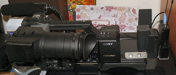

Generic Batteries : Both Don and I have "Sony" batteries on our video lights that are "suitable for F550, 770 and 790" ..I always use genuine batteries on cameras but it's nice to know if you ready get in a mess that, yes, your light batteries in fact DO work in the camera (mine are 4400mah) and also display the battery condition. Useful to know if your genuine batteries fail/go flat/get stolen etc etc
Mounting Accessories on the Shoulder Pad : I first just screwed on my radio mic bracket on the mounting screws and it worked fine but the antennas were tickling my ear so I extended mine back a bit and also so I can use Noa's brilliant battery mount at the back instead of on the light. However when it was in the first position it still was great until I found there wasn't enough space for my fingers to extract the battery for charging so if you mount stuff keep it behind the pad not on it otherwise you will struggle to grab the battery pack!

Ok I modded the receiver mount and added Noa's delightful battery idea and it works well. Shucks the camera is quite long now but I still love the low profile overall
I just made a "T" shaped fitting with 1.25" aluminium flat bar...I not really happy with using the elcheapo charger as a battery holder but it will work for now.
Chris
Maybe it's good if you also post these mods in the " Receiver Mount and Comments in General " section you started where I posted my set-up? Or maybe start a new one with "mods" only? It's not easy to group all these usefull posts so it can be found back for later reference.
I was also thinking to use wing nuts to fasten the audioreceiver and battery adapter to the shoulder pad, now I need a screwdriver to take it off, I only don't know if it still would be possible to take out the battery from the camera but sure will try to see if it works.
