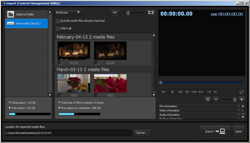

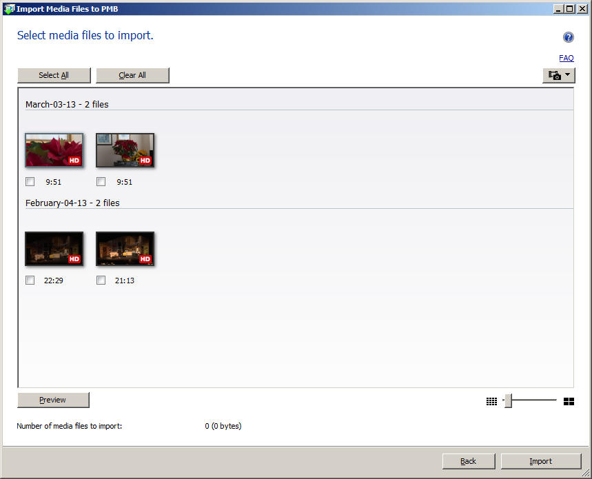

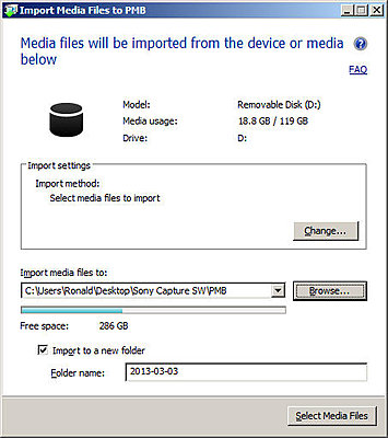

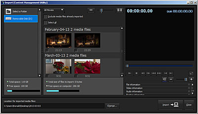

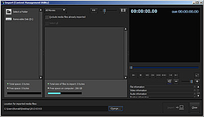

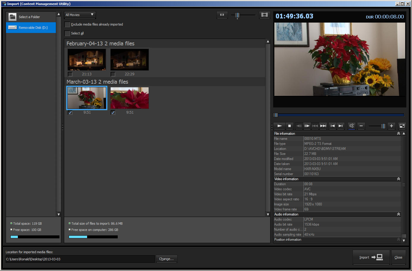

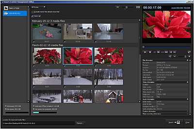

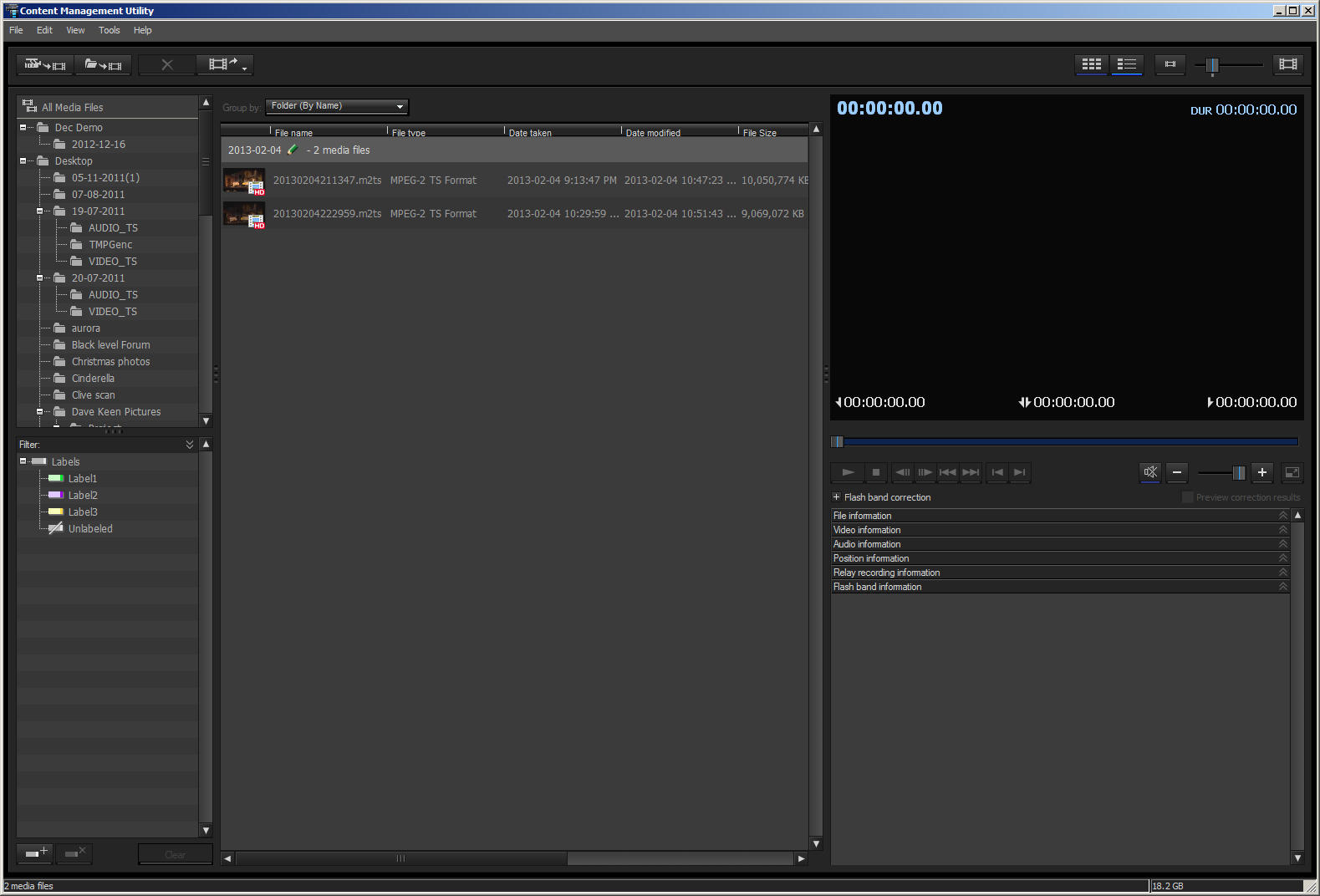

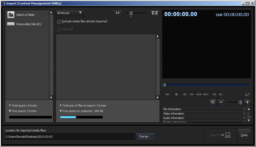

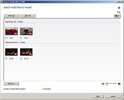

Some screen shots of the browser. There are 2 for the PMB . The PMB capture screen automatically opens when an external drive is attched to the PC that has video and still files on it. The selection screen is obvious I think. You can also see that you can name the directory and location ( or let the program do it) . I usually decide on location but use the standard directory naming of the date of import.
The Content Management has the main screen that has to be loaded like any other program. Clicking on the camera icon in the top left will bring up the import screen and when the particular memory unit ( my FMU128 in this case directly connected) on the left is selected the section screen will open. If there are more than one memory unit all will be visible. In the case of my NX5U there could be 3 memory units of course. The FMU128 and 2 SD slots. The EA50 could have 2 if the FMU128 is also installed. Selecting any of the boxes next to the clips will select for import to the PC. Selecting a clip will place it in the monitor for viewing as I have shown in the monitor screen. On the bottom of the window you will see the location that has been selected for import. This can be changed to any of the registered directories and new directories can be added under the tools menu. You will note that there are no mts files visible in any of these screens and they will not be on your PC after import either only the m2ts files that are the full clip that was shot.

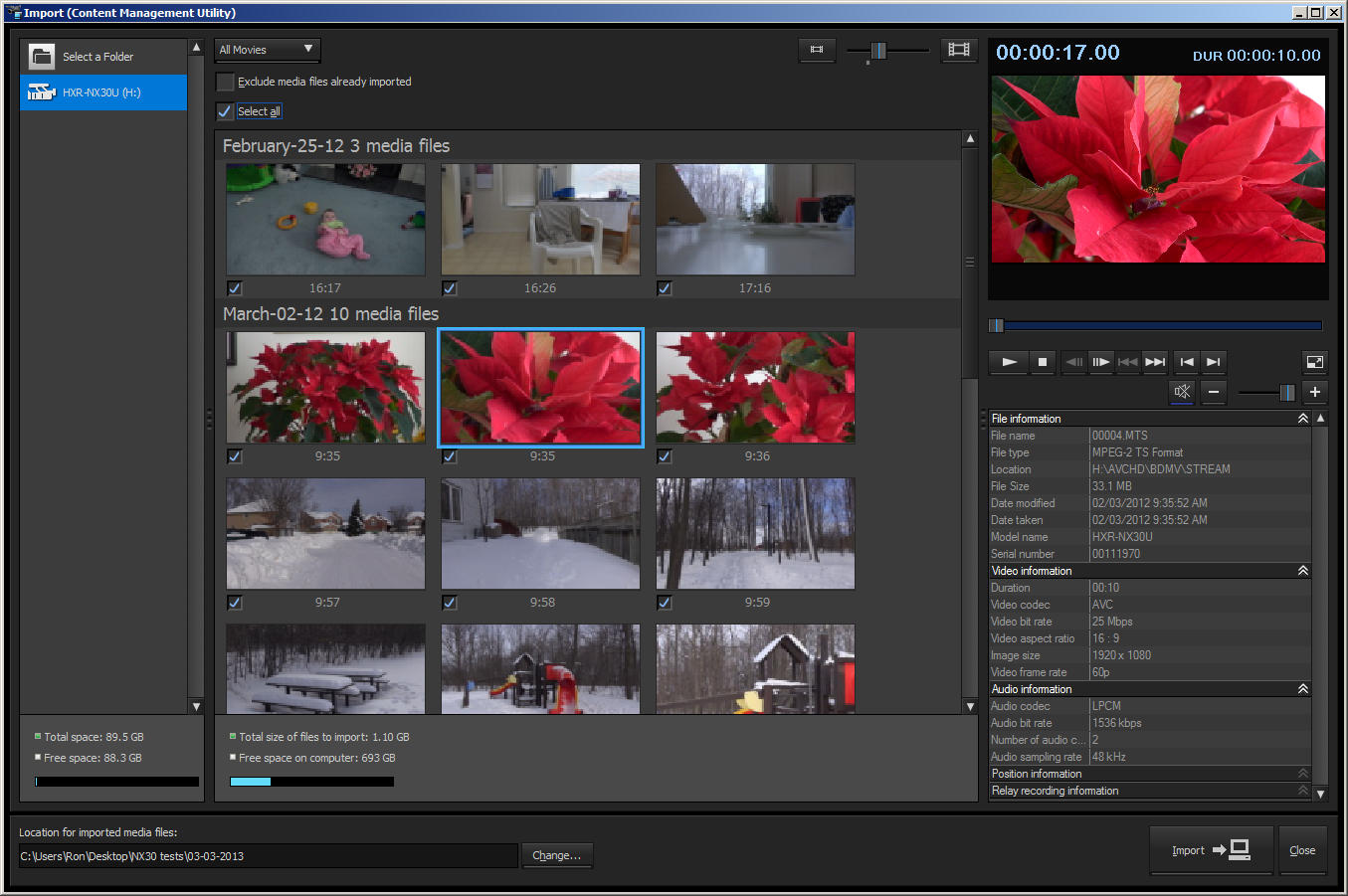

With my NX30 it just needed the camera connected when the software was loaded and I expect it got the serial number from the camera. The version for the NX30 is 2.1.01.11180 and the one I have been using for my NX5U is 2.1.00.05171. They seem to work the same way and so I expect the newer version allows for AVCHD 2.0 60P .
This is how it looks for the NX30 clips selection .

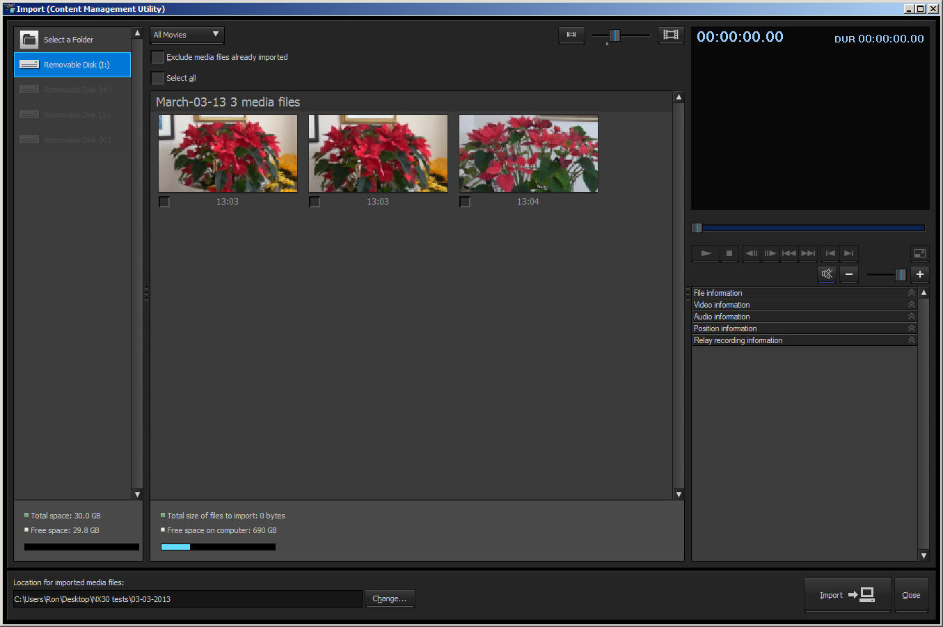

Old March 3rd, 2013, 11:12 AM   #45
Join Date: Mar 2003
Posts: 4,222
Re: content browser

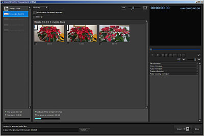

Chris , this is the SD card with some clips from the NX30. Load Content manager, connect the card reader, click on the camera icon top left of screen and then this screen will open for you to select the clips you want to import.
Ron Evans
