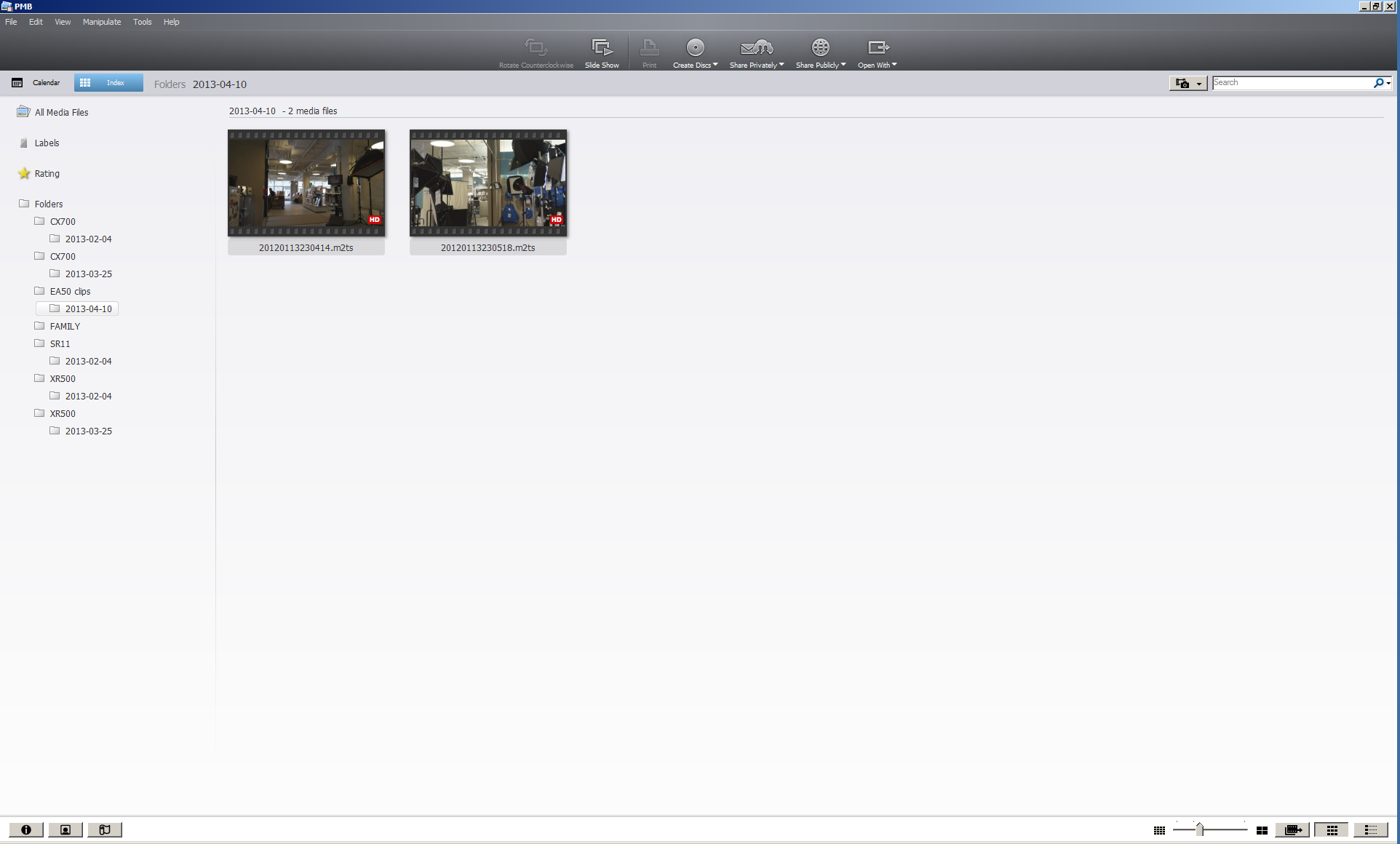

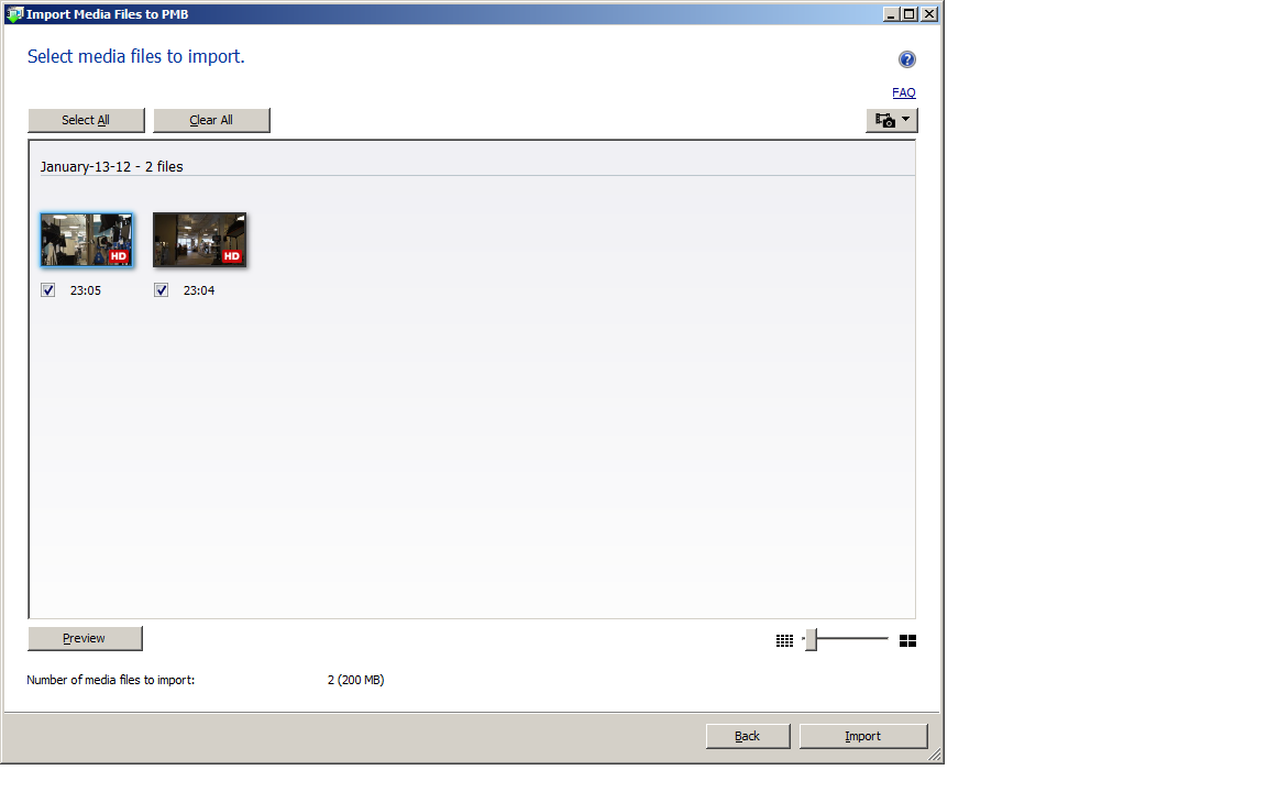

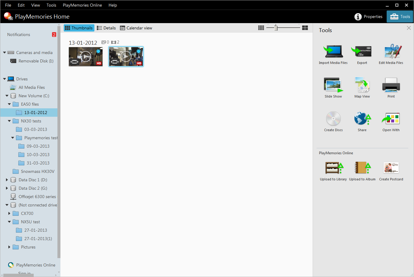

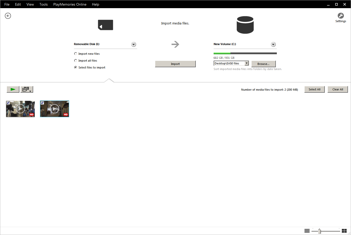

Noa, out of curiosity I went into local store and shot some clips on an EA50. Attached are screen shots of the import into PMB and PlayMemories both programs worked just fine. Source 24p for the first clip and 60p for the second and audio was LPCM. Both these programs have the ability to select files using Windows convention rather than individual files like the Pro versions and they join long clips together too.The first 2 figs are PlayMemories ( the current shipping consumer transfer program) and the 3rd and 4th are PMB ( the original transfer software but the latest version). With both import screens there is the choice to browse for transfer folder and create a new one at that time no need to register a folder like the Pro versions. Both these programs played both the 24p and 60p files.
Ron Evans
Edit: Just noticed I didn't reset the date on the EA50 in the store !!!
content browser-playmemories-import-screen.png   content browser-playmemories-screen-after-import.png
content browser-pmb-import-window.png   content browser-pmb-imported-fiiles.png

No they were just short files, shot in the store. Since both PlayMemories and PMB join files from my NX5U and the NX30U I do not think they would not work for the EA50 . The store told me the EA50 files were the same format as the NX30U, AVCHD 2.0 as I thought. Just wanted to check for myself. IF you do an update for PMB Sony will ask if you want to upgrade to PlayMemories. I did that on one PC and left PMB on the other that is how I have both.
