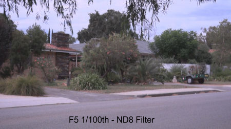

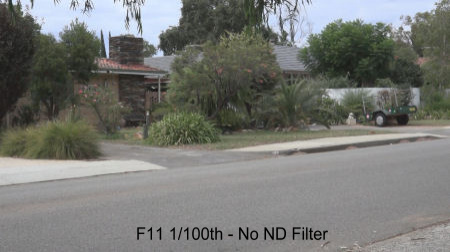

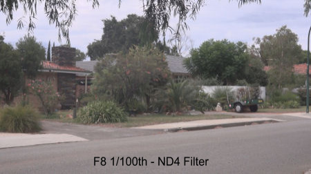

OK , today is just as hot as Saturday but it is a little cloudy and I did a few test shots with ND filters..Now these are "supposedly" top of the range (3 filters cost me $120) so they are no $2.99 eBay cheapies.
I did 3 clips with No ND filter, then an ND4 and then an ND8 .... the footage gets progressively "redder" as you go up and especially with a scene with greenery the green content just starts to disappear.
Judge for yourself with the pics below....the BIG question is : Do you have to go to manual WB every time you use an ND filter ...pretty much the answer would be yes...now based on the fact that the WB gets "redder" as you increase the ND ..what now would happen with a variable ND??? The way I see it is every time you dial a new setting on a variable ND it seems you would also have to re-balance colour which is a pain in the butt surely!!

Problem is sorted !!
Advice (1) : NEVER EVER trust a camera salesman who sells you "the best ND filter on the market"
Advice (2) : Don't buy Green L filters ...that is the issue ..just read a review and on stillcameras too they cause a red cast ..the higher the ND the worst the red cast.
Reading and looking at tests on still cameras the Hoya filters seem to give flawless results so I think I will grab just an ND4 for now and see how that works ...reviews don't show any colour cast at all and the reviewer's test of my filters showed the red cast...they double stacked filters too ND4 + ND8 and the red cast was terrible but the Hoya was still clean and didn't seem to show any image degradation
