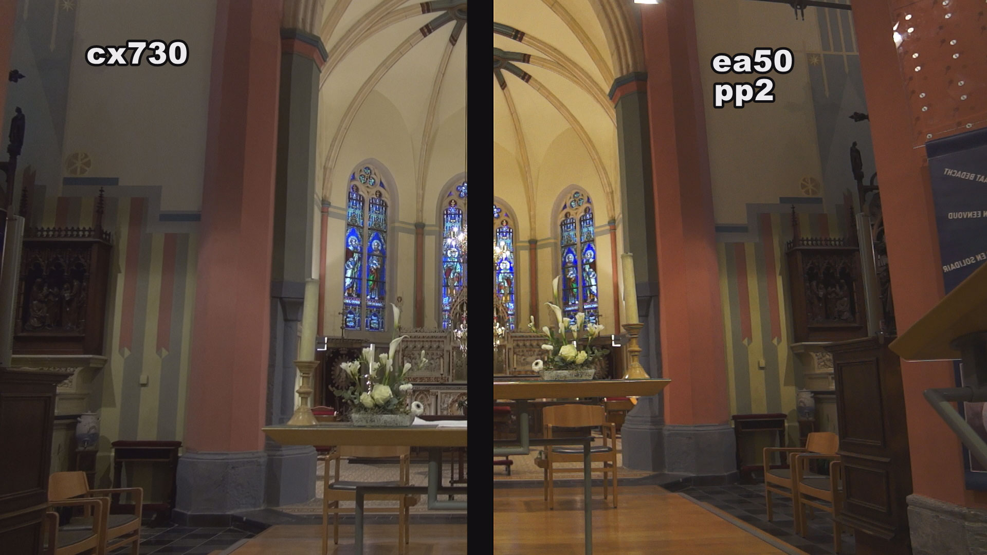

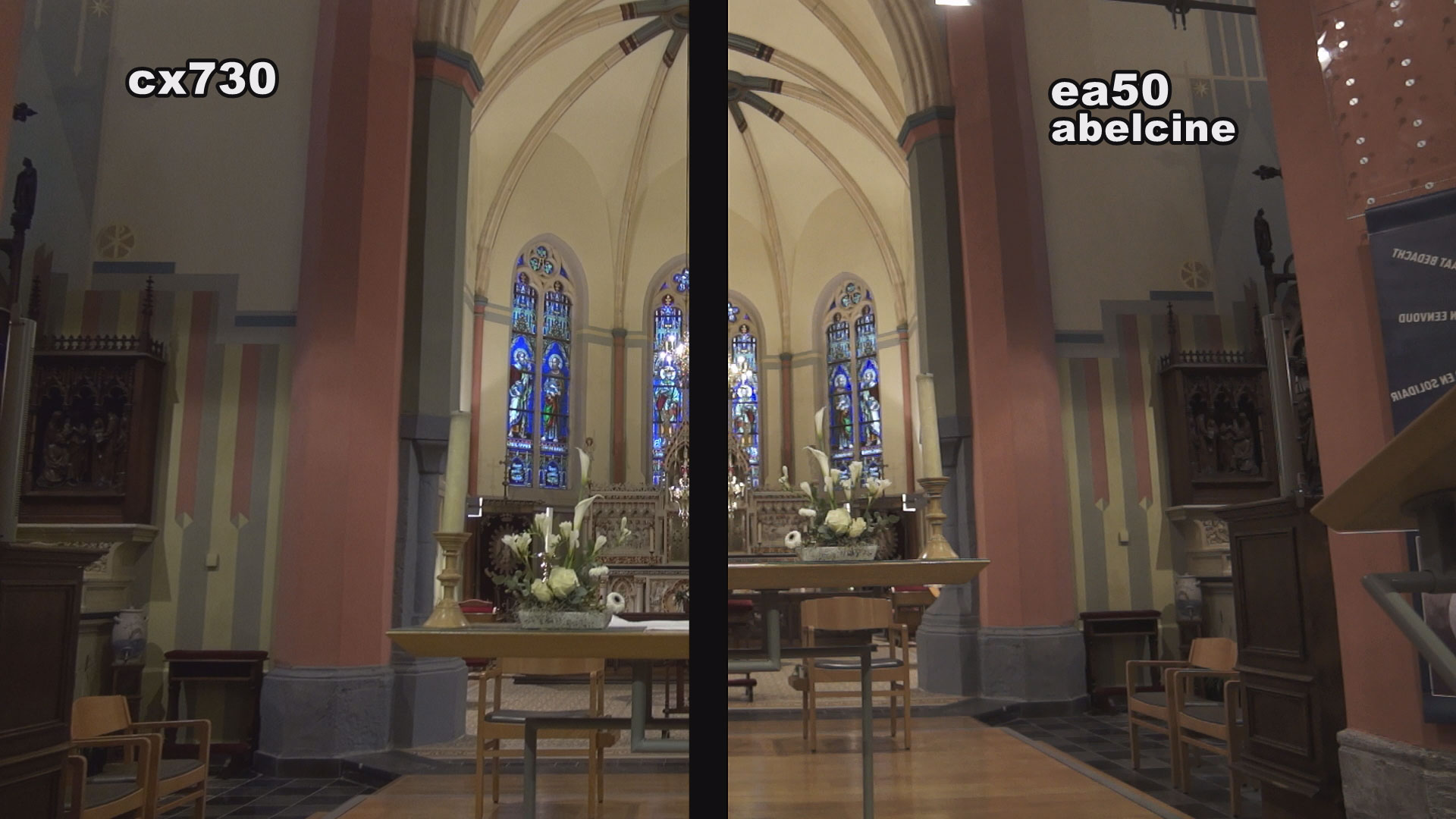

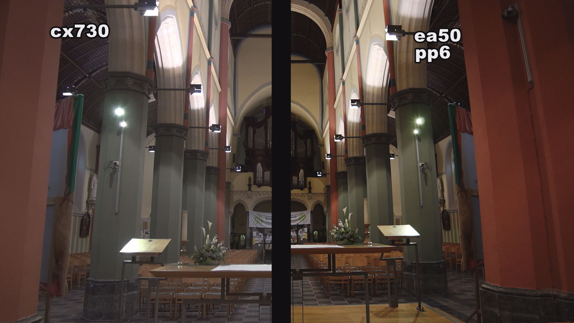

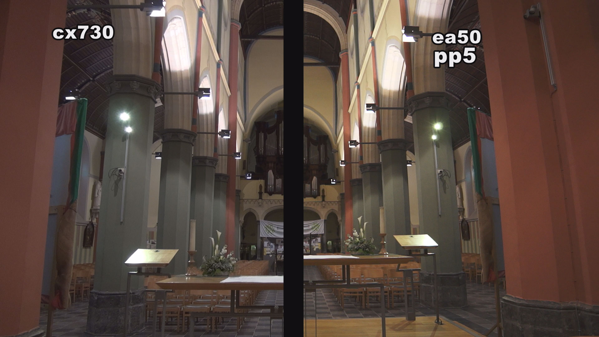

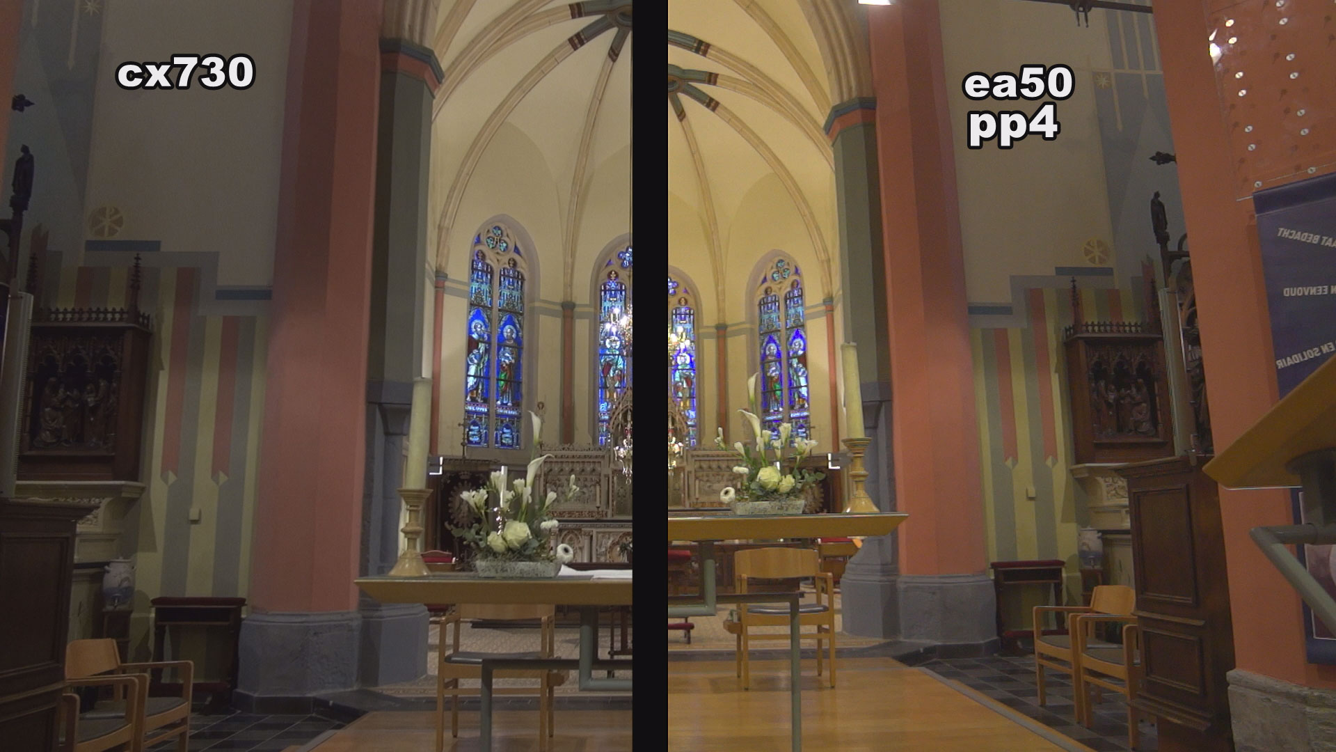

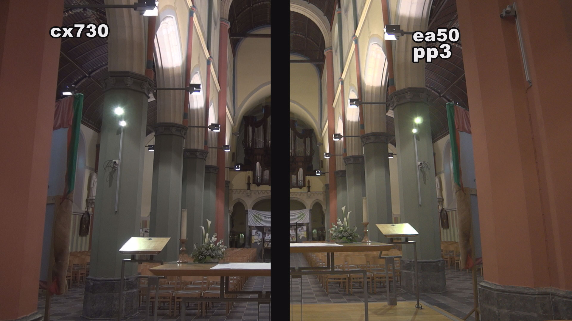

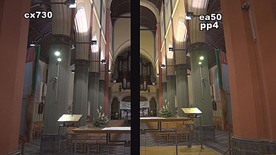

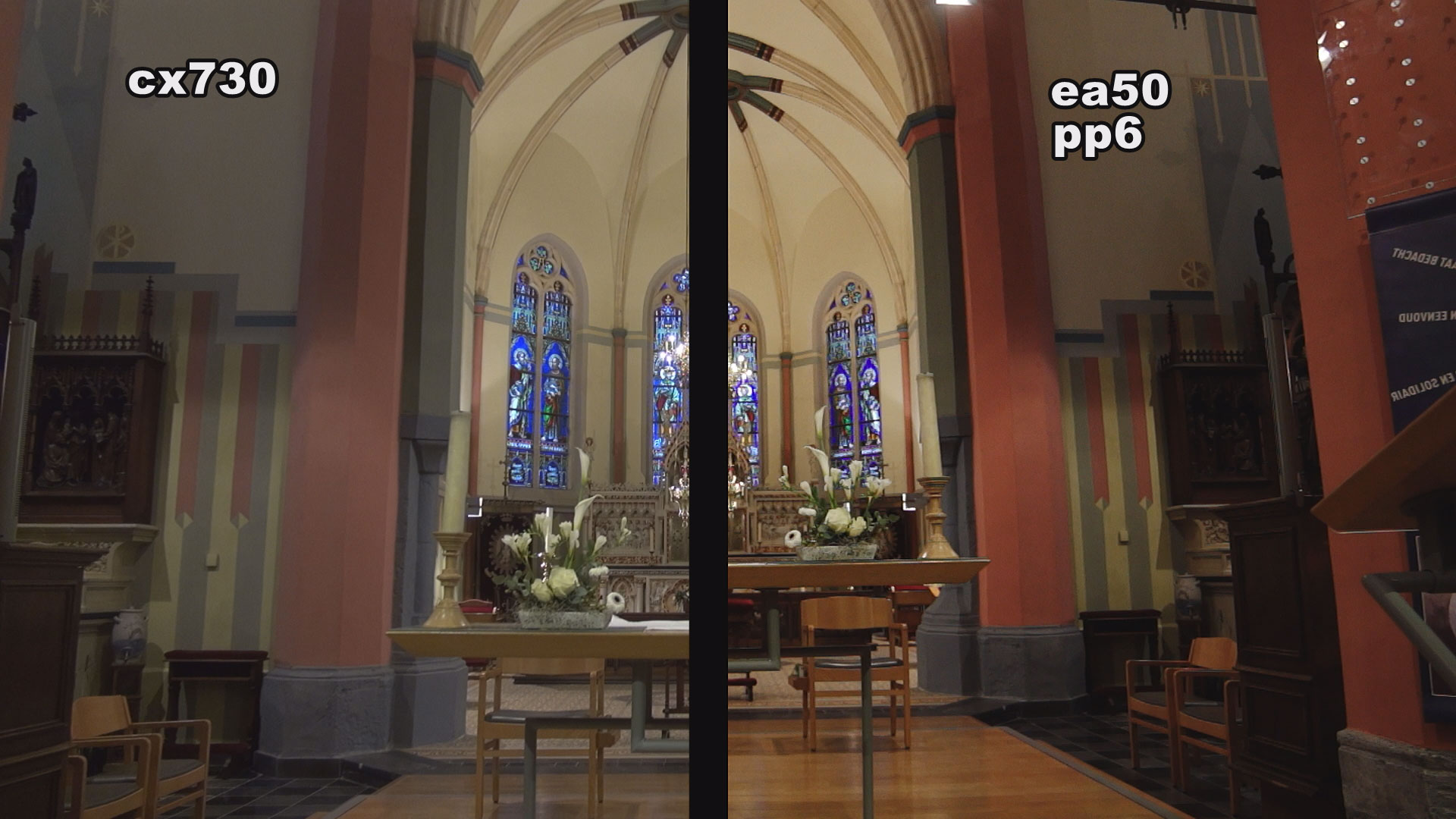

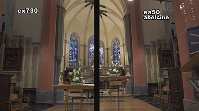

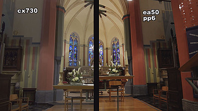

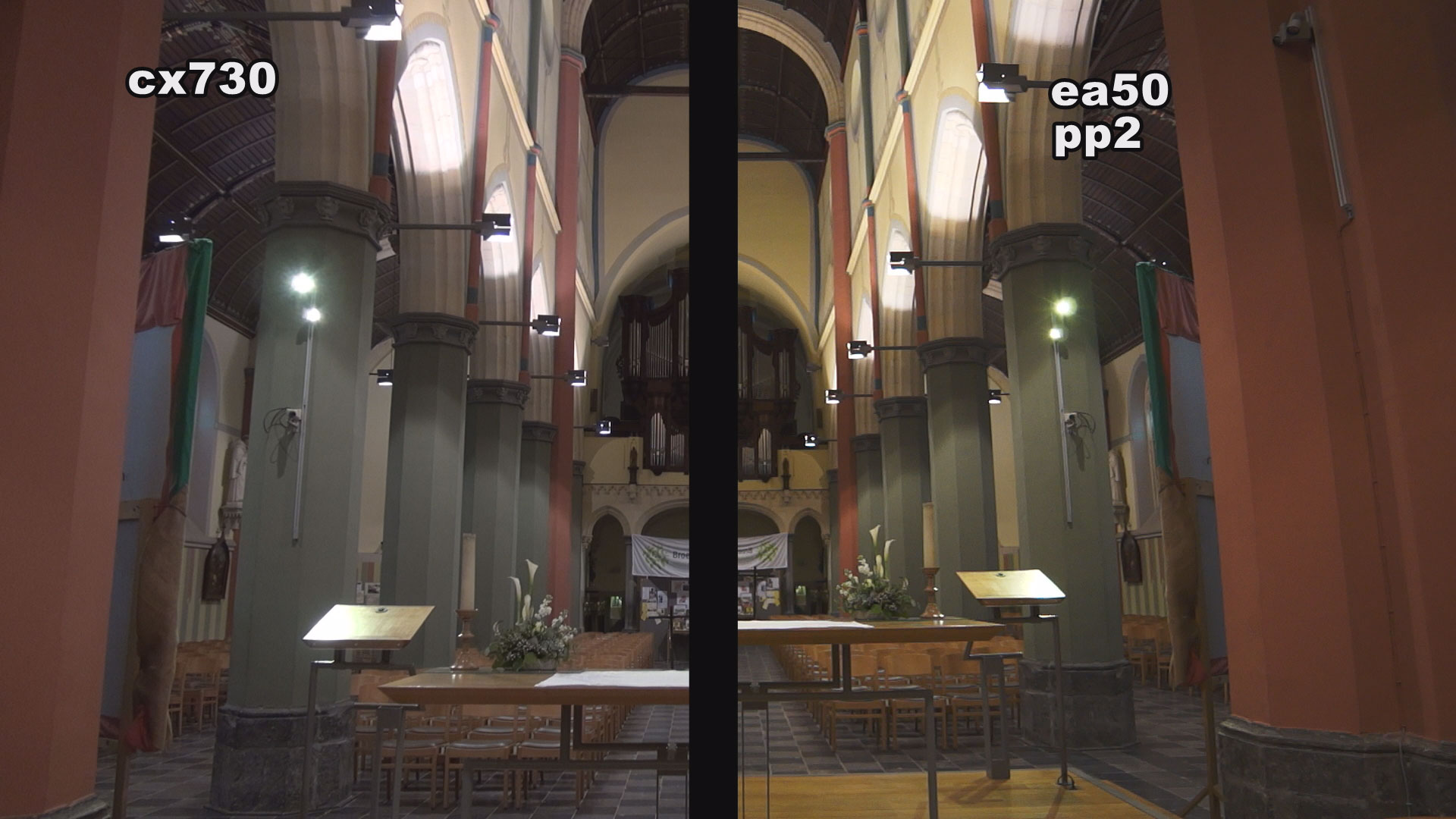

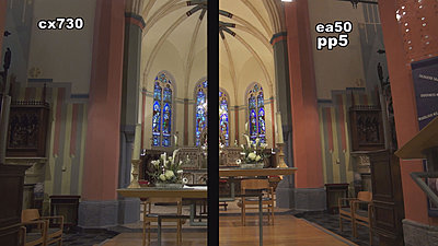

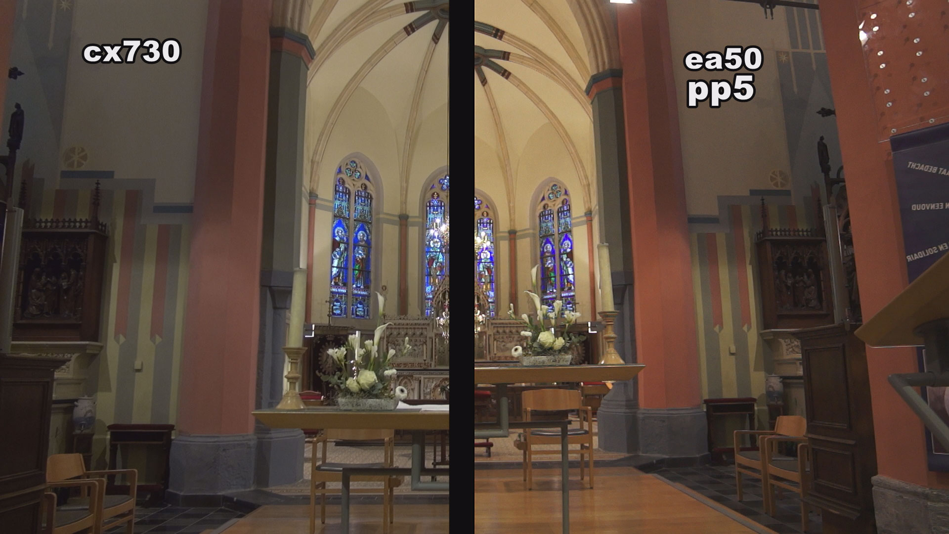

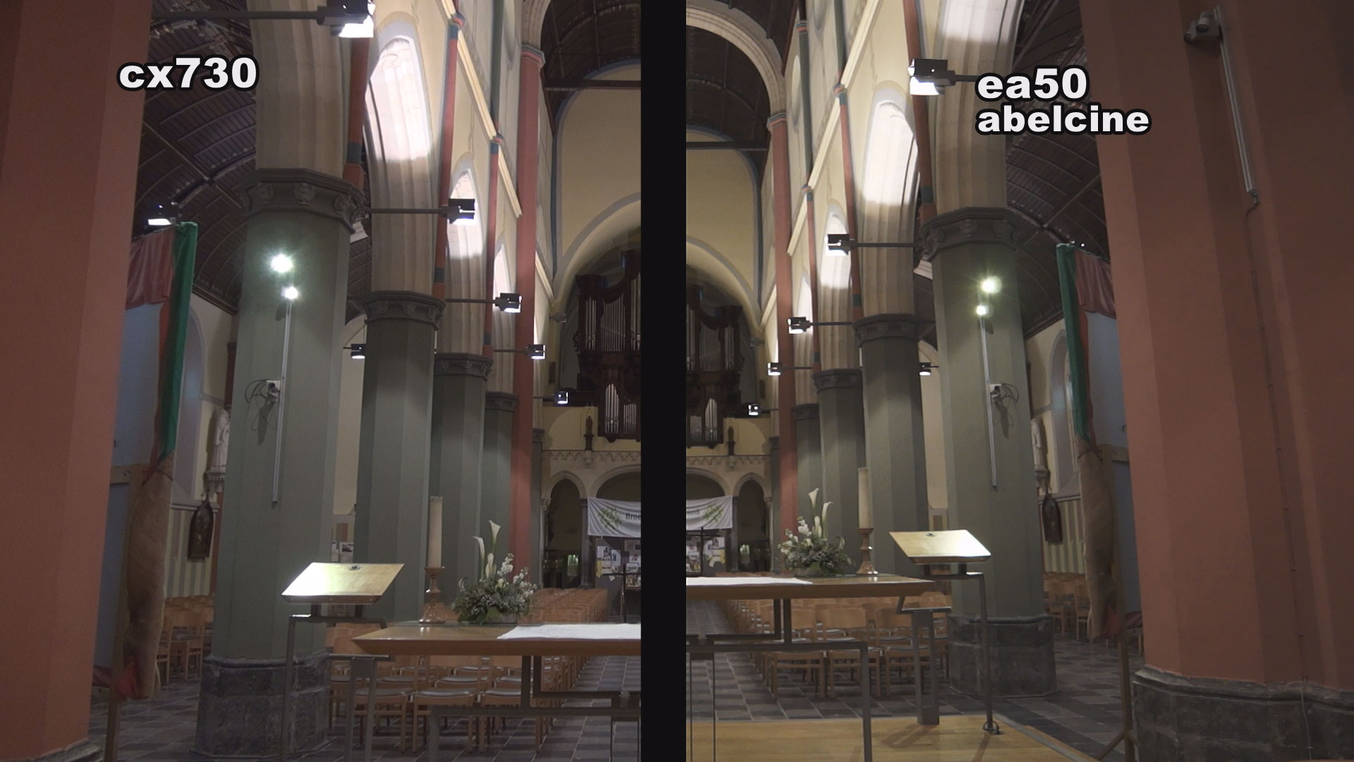

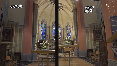

Yesterday when I was filming at the Sint Trudo church I replaced ppt1 with abelcine's preset, when I was at the church I did some side by side shots with my cx730 at it's widest angle and the ea50 with a samyang 14mm f2.8. Then I applied all factory presets, except ppt1 which I replaced with the abelcine one to see which one would match best with my cx730.
It turns out abelcine's preset is a very good match, also ppt3, if you would add saturation and contrast and ppt 5 which has a bit richer color.
I was surprised to see that my cx730 resolved more detail then the ea50, the 14mm on the ea50 however does go much wider which makes the small detail even smaller what could be a reason but still, the overal picture looks sharper to me for the cx730.
I also did a low light comparison from a shorter distance and then the ea50 stayed a bit sharper at high gains.
Below several frame grabs for those who are interested to compare:

Excellent!! Pity you didn't compare the default as well...that is a LOT different I found to the presets. It has a much deeper colour too.....Guess you never shot anything in the Church with the camera in "OFF"???
Chris

Thanks Noa,
That was a lot of comparison! I will try the abelcine preset on my next indoor shots - it looks excellent on this monitor.
Dan

If you look casually at all Noa's shots there isn't a huge amount of difference between the profiles actually in indoor shots so for the average viewer one could probably get away with any of them.
The big difference happens with high contrast, bright light shots more than anything else. Using the "OFF" setting and the standard PP3 there is a massive difference in colour, especially the greens which with PP3 tend to lose a lot of the correct colour and show up more as if the shot was done on a dull overcast/rainy day ...bright green tress and grass tend to revert to a dull grey/green and they lose all their sparkle. If you are Summer shooting then a comparison of profiles is definately a must!!
Chris
