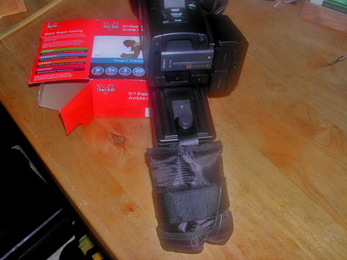

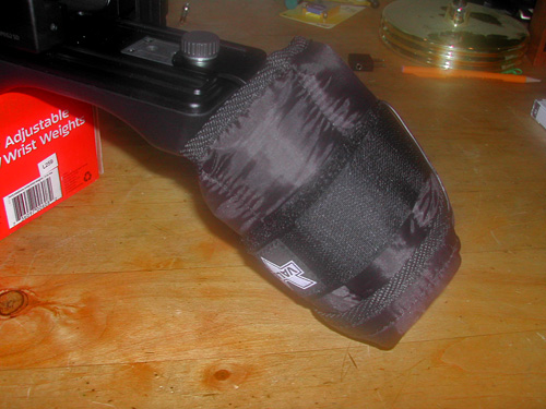

I found a much less expensive and equally effective counter weight alternative on Amazon - wrist and ankle weights. Perfect size to mod to spare parts from my parts box. Just $12.39 for two (only need one) + free shipping with our Prime account.
The one wrist (ankle) weight is max 2.8 lbs. and can be adjusted down from there...makes an awesome difference in the balance for shoulder shooting!

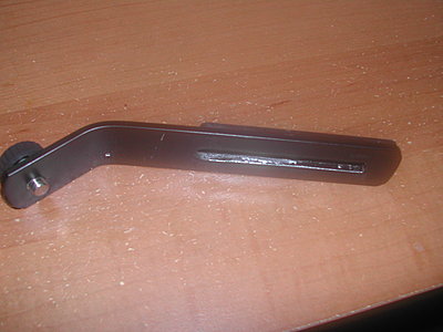

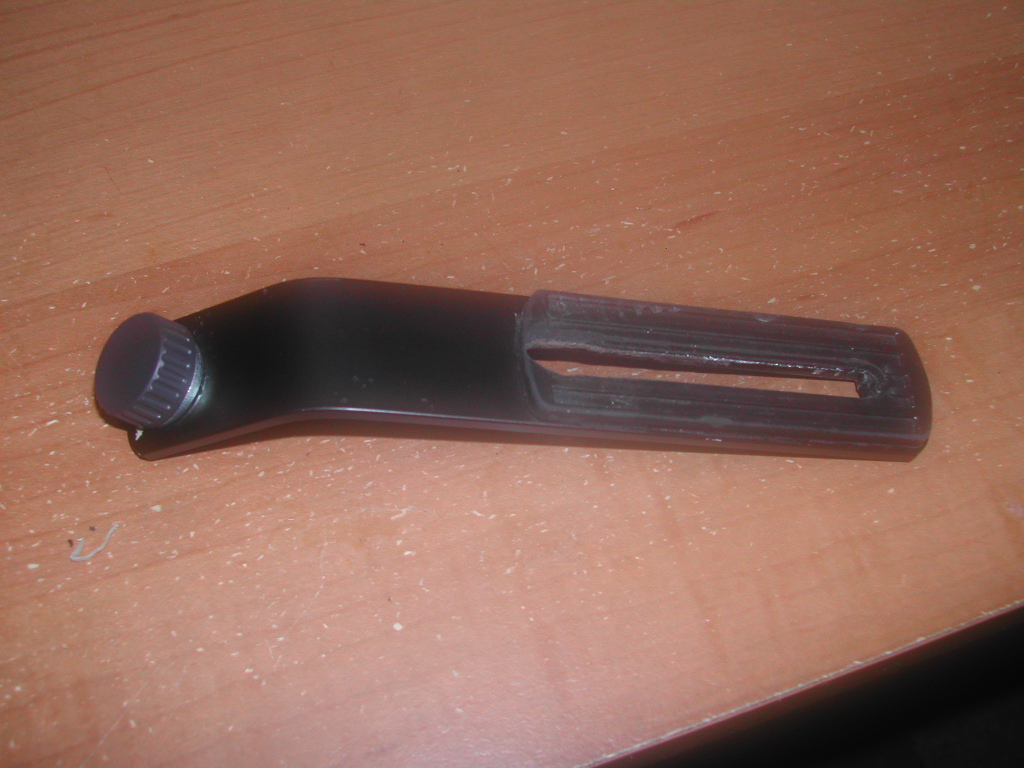

Dan, what does the part look like that is screwed onto the extended shoulderpad? Do you have any details on that?

Noa,
Here's a couple photos of that part...not sure where I first got it, but anything similar that can accommodate a screw with right thread size to fit into the shoulder support will work. I bent the piece in a vise to angle slightly downhill. The ankle (wrist) weight was simply wrapped tightly around this bar, secured with its own strap and then further secured with a piece of 18-20 gauge insulated wire. Let me know if you have more questions.

There's a couple of accessory brackets here that could work: Amazon.com: Camera Flash Bracket

Thanks Wes, I think one of those straight brackets is what I used. Minimal expense.
