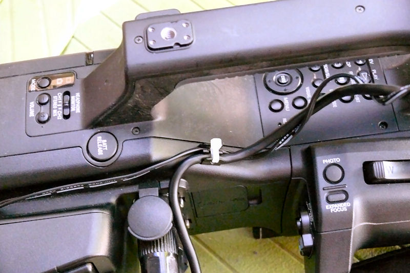

Hi All
I have done a simple but effective mod on the mic cable clamp on the EA-50. What happens is the soft plastic edges simply bend outwards when you push the cable in and it falls out. I unscrewed the plastic clip with a tiny phillips screwdriver and then drilled a 2.5mm hole in each side of the clip. Then the clip is screwed back into the body and the cables pushed back in and you then push a cable tie thru the holes which when tightened, pulls the edges up straight and forms a barrier as well for the cable so it doesn't jump out.
Works perfectly!!
Chris

Re: Fix for the cable clamp
You are now the official Sony mod man here :) The only issue I might see with this is if you have to take of the microphone during a shoot that you need to cut the cable tie. I have only set up the microphone and my swit battery once and then the cables didn"t come loose but I didn't shoot with it like that, it was just to make photo's from that setup. Does it come out that easily? I already asked it in the viewfinder 'stopper' thread you posted but can I use this photo as well to publish in the "mod" section of my blog?
Sweet mod.
What's that additional cable running along with the XLR mic's cable if you don't mind me asking?
My guess would be for the power supply for his light.
Quite correct guys!!
It was Noa's idea actually and I copied it!! All credit to Noa...it balances the camera a lot better with the battery right at the end.
and Noa ...use any photo you wish for your blog. There actually should be 3 cables there but my receiver cable on that camera is a little short so it goes direct to the XLR ..it was made to fit the Panasonic.
Chris

What light and power supply are you using?
Hi James
I use eBay PowerLED lights that have either 6 x 3W LEDS or 8 x 3W LED's and run off Sony F550 batteries which clip on the back of the light and the whole thing sits on your coldshoe.
If you search for "5010A videolight" or "5080 videolight" on ebay you will find them!!
They also have a DC input so I removed the battery and stripped a spare charger and use that and the battery as a power supply running from the back of the camera simply to distribute the weight better.
When I saw Noa's light done the same way I just HAD to copy it!!
Chris
