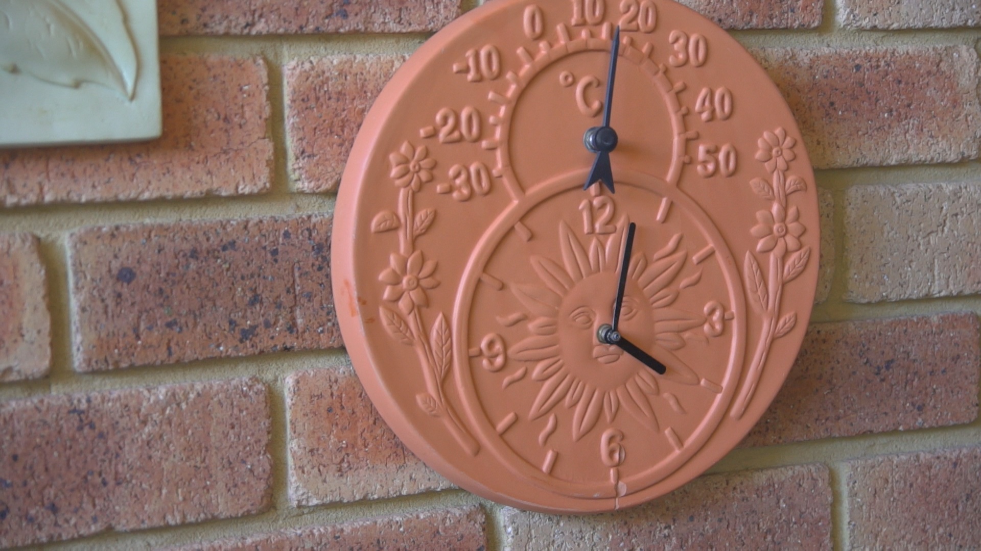

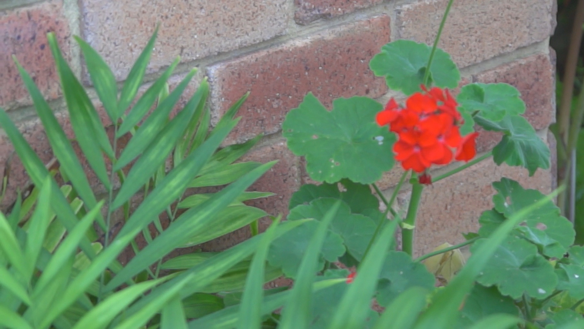

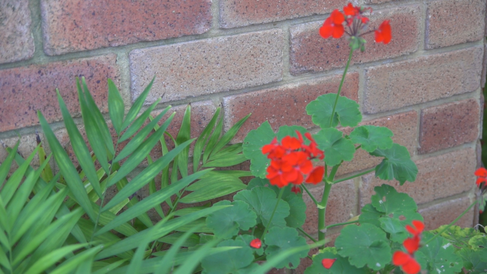

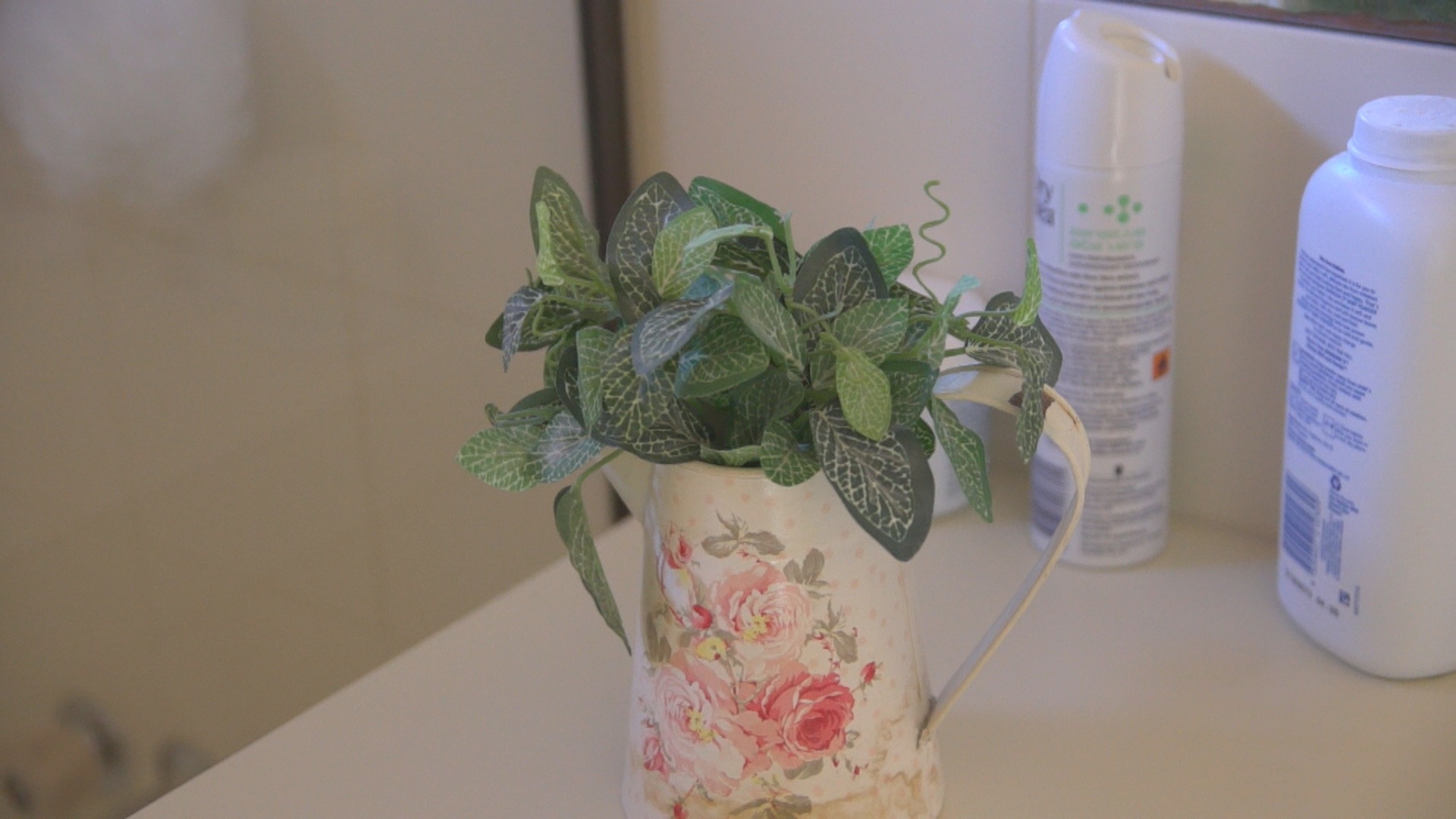

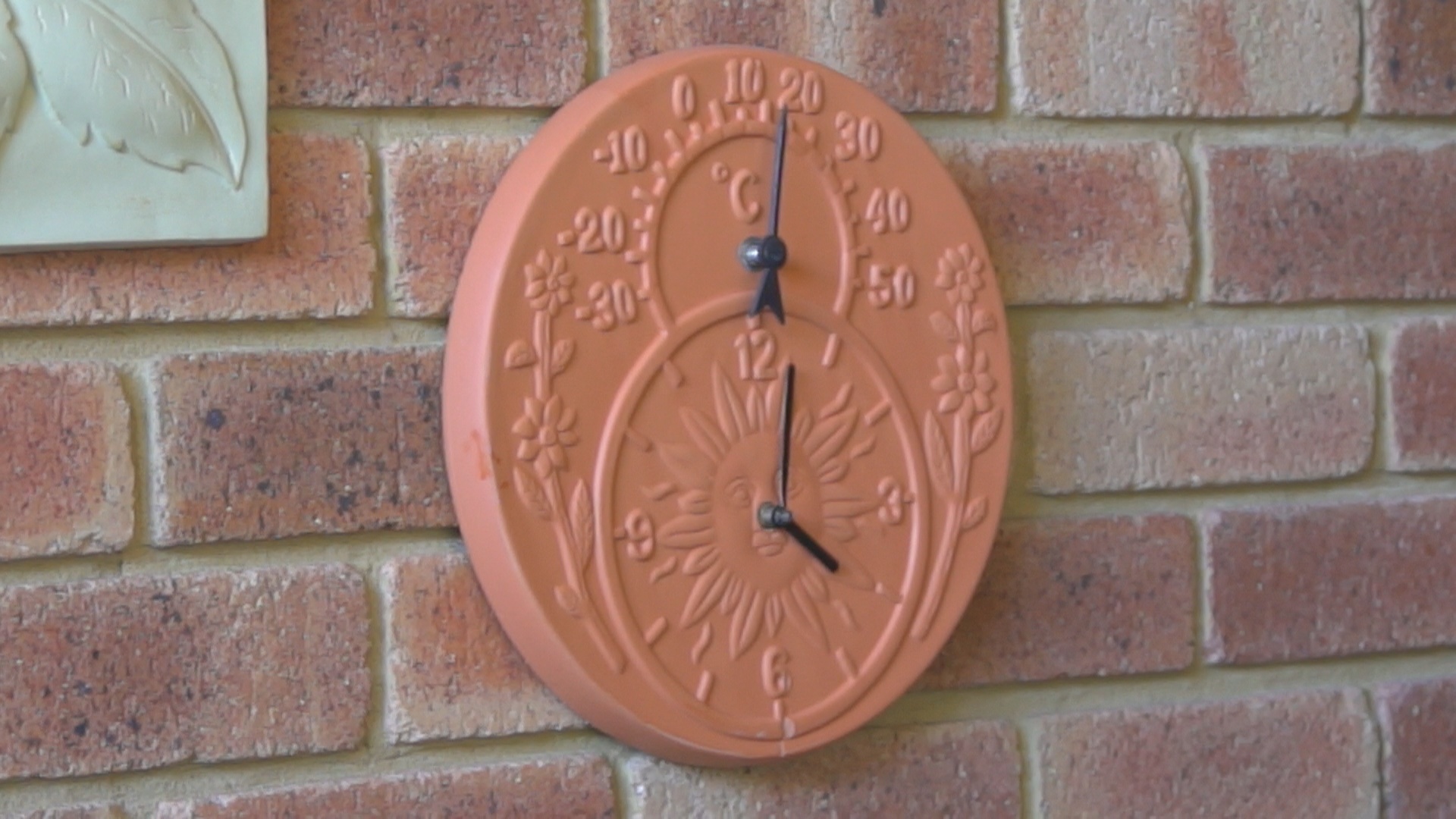

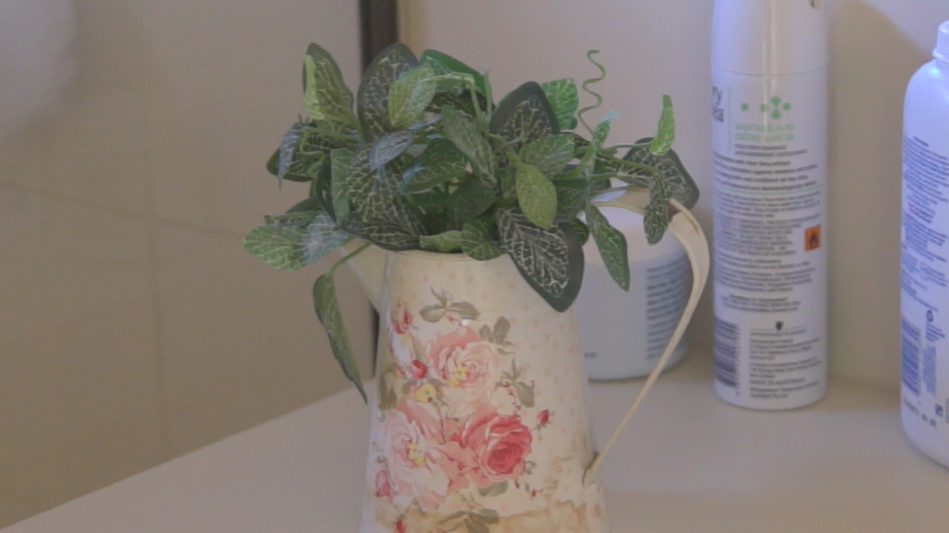

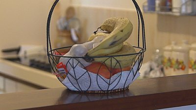

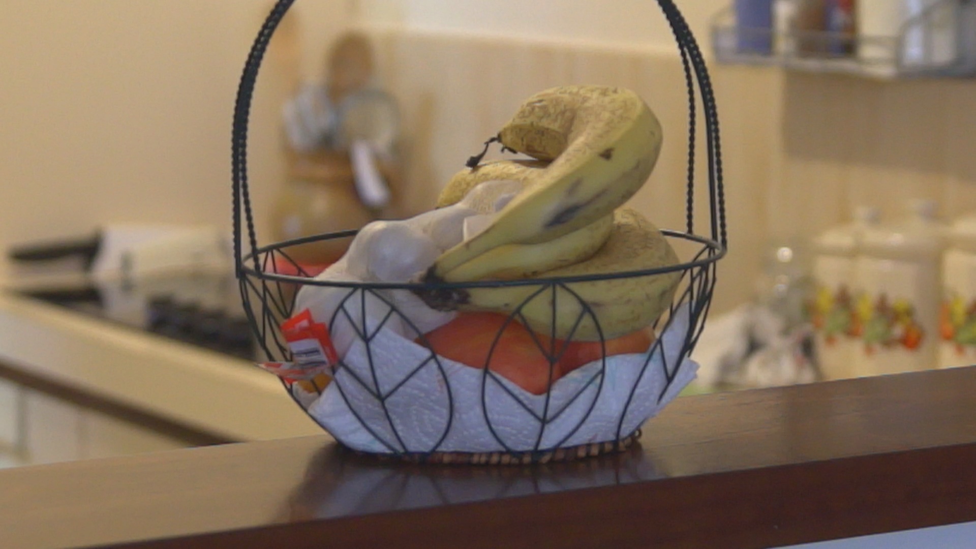

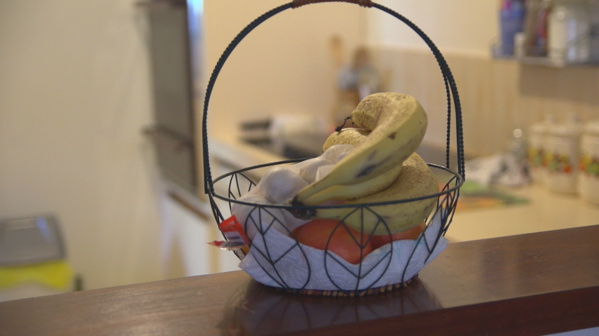

I used my Tamron 17-50 at full zoom on a few outdoor objects and also some indoor up to 15db gain and then did 2X digital zooms of all of them so you can compare the resolution with and without zoom.
Shot at 1080 50P so I had full res frame grabs.
Tell me what you think??
Chris

I"m not Randy but just thought it would be good to say that these test photo's don't show the apparent resolution loss the digital zoom causes + the subjects are not that suitable for a clear view, it would be better if you choose a scene with more fine detail or patterns that are subject to causing moire, also fine print like text on books are a good way to see the difference. Best would be to first shoot the scene without DZ and then use the 2x DZ but move the camera back to get the same frame because then you can compare better.

I did actually move back when I digitally zoomed in so didn't bother to be technically perfect regarding distance!! I think the only REALLY practical test would be inside a Church locked onto a bride and groom at the altar as that's what Randy wants to use the digital zoom for. Yes, I do agree that arifacts and moire will be amplified but not likely at a wedding ceremony unless the groom has a pinstriped suit!!
I looked carefully at the images side by side and the no digital zoom images are definitely a bit sharper than the digital zoom ones. Putting moire aside I think one might get away with using digital zoom especially if the end result was DVD....A little bit of sharpening in the NLE should suffice.
It certainly would be better if you simply don't have enough zoom apart from using the stock lens. I think I would prefer to use the Tamron 17-50 with some digital zoom and be able to stay at F2.8 rather than introduce noise when the stock lens has to zoom and only can manage F5.6 in a dingy Church!!!
It would be the lesser of two evils I think!!
Chris
