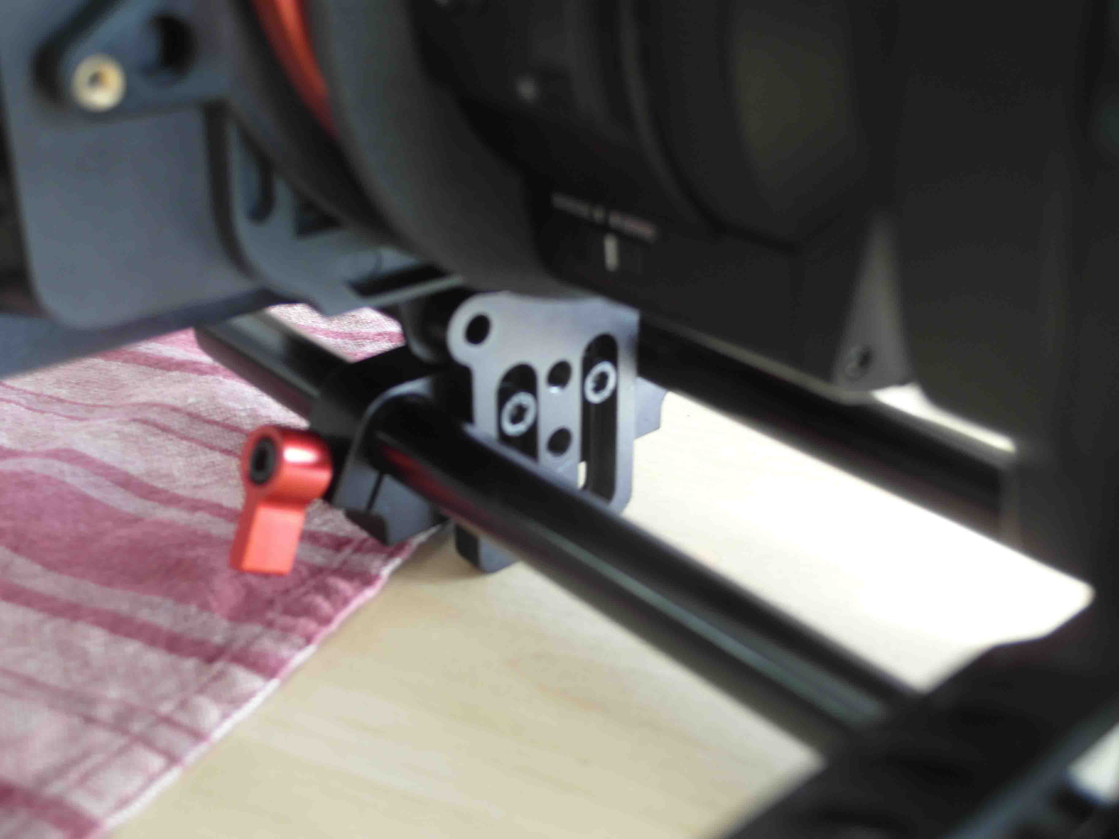

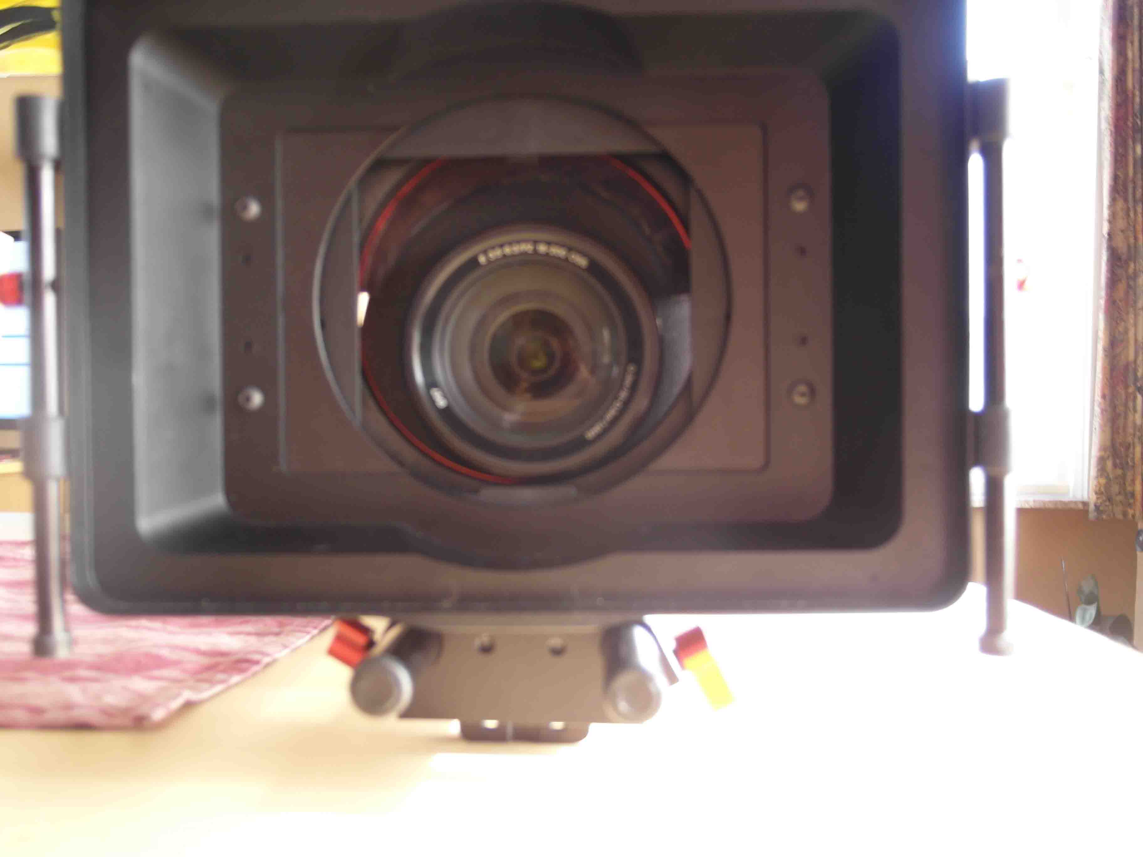

Chris, my problem is that the lens is not in the middle of my mattebox. It's almost on the bottom of the mattebox. I don't understand it. Don't you have this problem?

Under the Camshade is a mounting for the rails and it has 2 allen screws in it. Loosen these and the whole matte box slides up and down so you can adjust the height. Adjust it so the lens is in the middle of the big hole and you are done. I found that the factory set position is way out!! I had to go almost to the other end of the adjustment to get it central. If you are unsuccessful let me know and I'll take a pic of the adjusting piece?

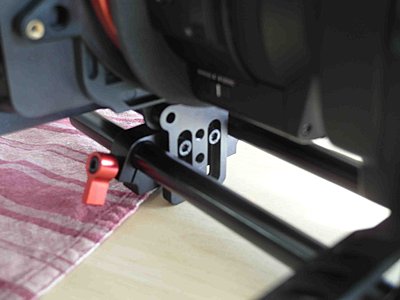

CHris,
I can't slide the mattebox lower than this (see pictures) I don't understand what i'm missing.
I have a handmade counterweight that's heavy so there is no front weight anymore. Yes it's heavy but I do gym every week (lol)

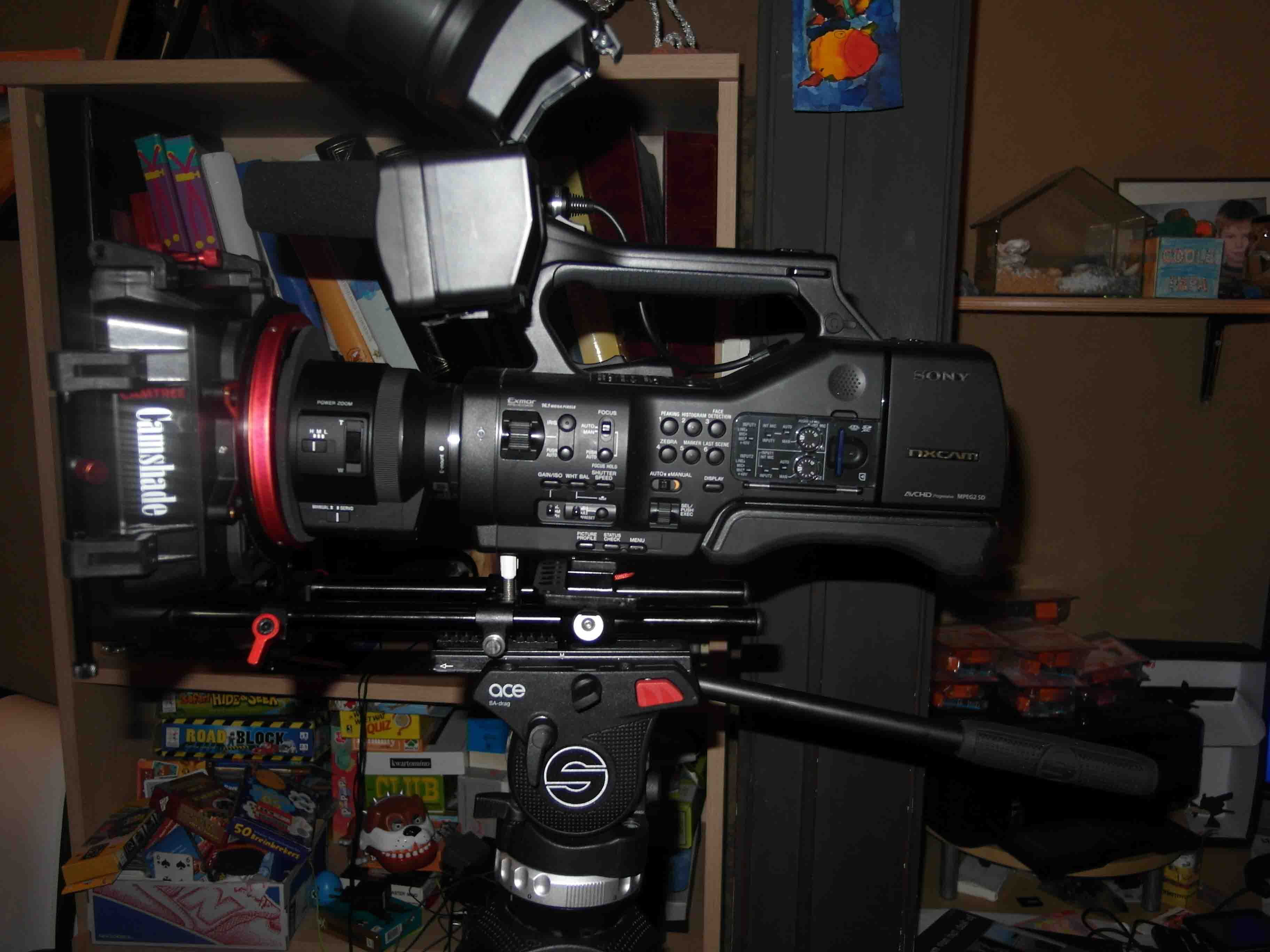

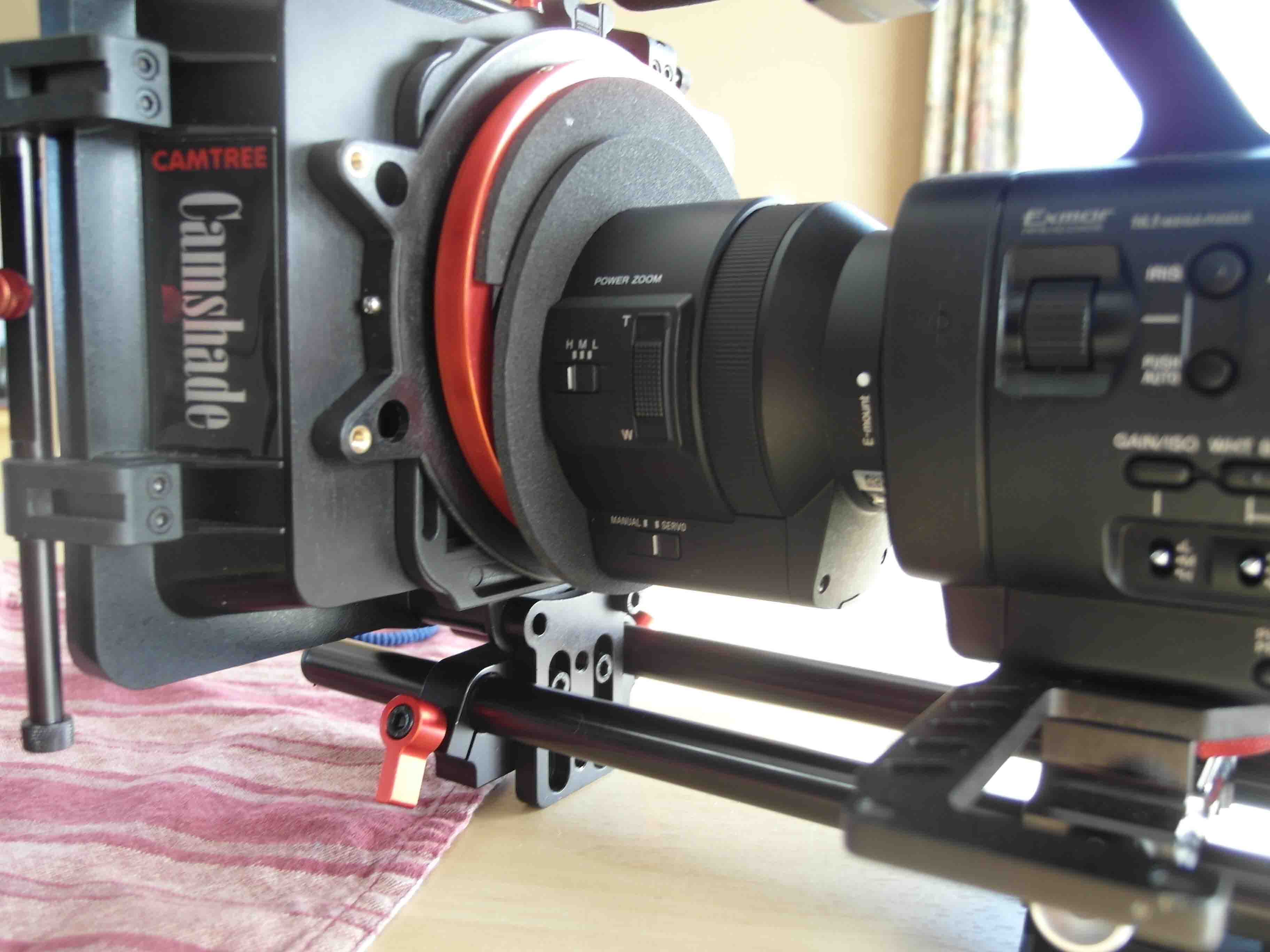

Re: Matte Boxes Feedback on the EA-50
now the lens is in the middle but the camcorder is not more horizontally...
It's ugly for me. the baseplate needs to go higher but it's not possible.
The mattebox is already on his lowest possible setting.

The front plate can go down a bit more ..take it off the rails and loosen the allen screws and it will drop an extra few millimetres.
You camera should be horizontal unless something is not sitting right? The Camtree camera plate should be flush against the camera base .... that, or the tripod QR plate are the only two places that can cause the cam to not be horizontal. Are you sure your camera rail fitting is clipped correctly onto the rails ...If you grab the front of the camera can you move it up and down ....mine initially wasn't in correctly and wobbled up and down. Apart from those items the rails have to be parallel to the camera base!

can you post some pictures of your setup please? the bars in the base plate are a bit wobbling.

Yours looks like it's assembled correctly. I also found some play when the QR camera mount was on the rails. That camera side QR plate is the one you need to look at. Take the rig off the camera and loosen the silver thumb screw that locks the adapter onto the rails. If you loosen the thumb screw the unit can snap on and off the rails so first of all make sure than it snaps on correctly and that the little spring inside is doing it's job. If it sits snuggly on the rails and can still move up and down the rails then it's sitting correctly. I had to undo the thumb screw a couple of times before the camera plate clipped onto the rails correctly. Once that's right then tighten the thumb screw really tight and there shouldn't be any wobble in the plate and with the camera back on you also shouldn't have any forward back rocking. I found the screw has to be REALLY tight !! If you camera plate doesn't snap onto the rails accurately and still wobbles with the silver thumbscrew done up tight, then you have a badly engineered unit and need to sent it back to your supplier and get a new one.
