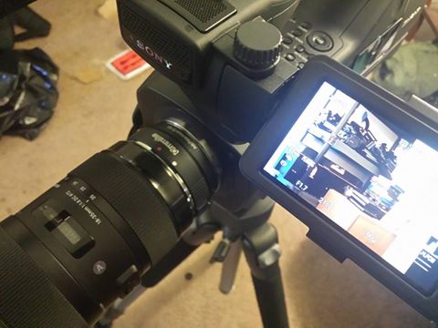

How's it going guys. Just got my "EF-NEX EF-EMOUNT FX Lens Mount Adapter for Canon EF EF-S Lens to Sony E Mount" for about $105.
Here's what I bought:
Amazon.com : Signstek Newest Version Electronic Auto Focus EF-NEX EF-EMOUNT FX Lens Mount Adapter for Canon EF EF-S Lens to Sony E Mount NEX 3/3N/5N/5R/7/A7 A7R Full Frame Frame : Camera Lens Adapters : Camera & Photo
(sorry don't feel like HTMLing)
My experience so far. Only the F control works. Although it says auto focus and even IS is suppose to work with some lenses it hasn't for me. But really though I am happy enough knowing F control works. Also when changing F Stop on my camera you can hear it and its probably going to be loud enough for the mic to pick up.
The lenses I tried it with
Sigma 18-35 F1.8
tammy 24-70 F2.8
canon 18-55 F2.8
I read something in some of the reviews about an issue with reflective lighting when using full frame lenses but I haven't experience any of that yet..

Re: cheapo NEX to Canon EF lens adaptor with F Control
Hello Chris
When you switch from Manual to Auto itll go into auto shutter and auto gain but F control will stay manual which is nice. no error messages.
When you press the Auto Iris button itll give you a lens error message that you can just X out of and stays in manual iris.
When you switch to auto focus on the camera itl give you the same error message.
The error message doesnt seem to disrupt recording.
When you switch to auto focus on the lens the lens will just go to some random really out of focus spot. best to just keep the lens on MF and turn off IS.
IS seems to just stay off the entire time.
I read reviews about this causing other NEX devices to lock up when switching to auto something which forces you to hard restart the camera. So ill probably use it when filming shorter clips at first and be cautious.
I am trying to think what else I should test. Wouldn't want any surprises at the day of an event.
expanding focus, changing PP, and digi zoom are working.
I also honestly don't feel the need to updating any firmware. iam happy enough F control works.
Hello guys
Chris, yes it will only control Iris. I tried fooling around with AF around for a bit but I don't think there is no chance AF will ever work. (not that I would trust it if it did)
Woldgang, that was the other one I was looking at. It seems to be newer but I think its the same. Its got the same brand, text imprints, dots and screws. I guess the only difference is the color. I suppose having the white one is more useful in finding it when you have a million other black colored things in your camera bag.
OK UPDATE. I had no problems with it on a wedding I did last night. I wouldn't have thought that I would need iris control that much but I ended up using it when I alternating between shooting a bright stage and the darker dance floor. Or when I walked out to the lobby area where the lights were turned on more. I haven't check the video yet but I'll update this post if I do find something.
