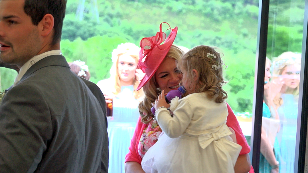

Here's another example - The marquee was quite dark so I let the outside over expose - look at the bridesmaid's face! This was using PP3
Pixellation in 50P/60P mode-casa_2.jpg

I looked thru all my corporate footage from Sunday and there was plenty of faces from the fast changing light and not a single issue with the no profile so it must be the PP3 setting that doesn't like bright conditions in any part of the frame. Mine was all in PS mode too ! I did another shoot today with a talking head and again clean as a whistle so I really think that it's the profile that's causing the issue as it's designed to lift detail out of shadows and when it gets an over-exposed shot it also lifts the detail and causes the posterisation issue. Part of my shoot today was also indoors and yes, the blacks are crushed but I'd rather drop their level than have to contend with the weird colours. The no profile also pushes the range quick hard and I find that sometimes blacks seem to drop below zero and whites go over limit on my vectorscope waveform so I have a colour curve corrector have kills the top and bottom levels to keep them in limits and the pull the black level just a wee bit.
I think it's definitely the PP3 lifting the shadow detail too much. I'm shooting everything with no profile now. The curve is really simple ..it kills blacks below the 16 level and kills whites higher than 234 ...without the curve blacks go all the waway to zero and whites to 255

+1 Chris - I'm going to continue using PP3 for indoor work but will use no profile for outdoors - a bit of tweaking in post and it's good to go - think I'll keep the EA50 for next season as well - loving it with my Canon lenses!

i have Pixellation and blur video in Night Scene low light,with the stock lens,I do not have another lens 2.8 to compare.The Pixellation comes from the lens or the sensor camera?
I didn't see that example before, it must have something to do with how the camera processes overexposed areas, I have not seen this kind of behaviour yet on my 1080p 50p camera's.
