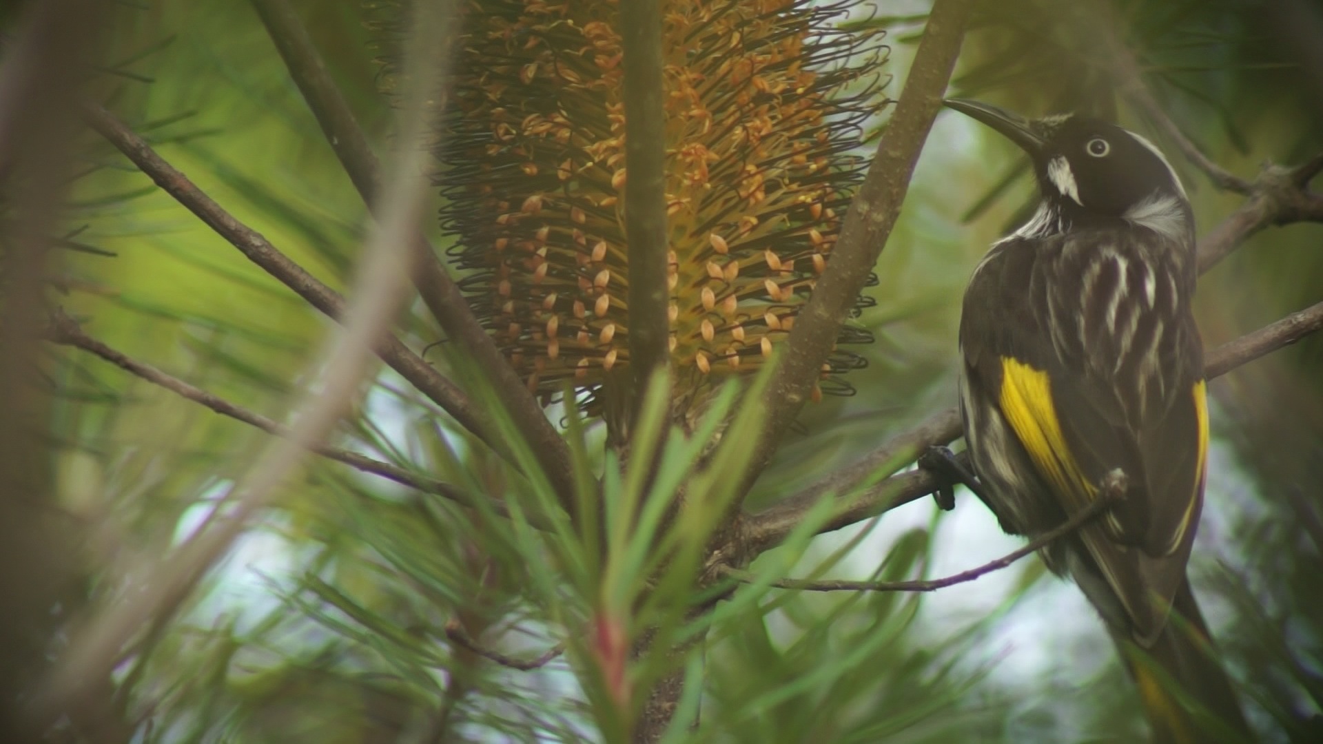

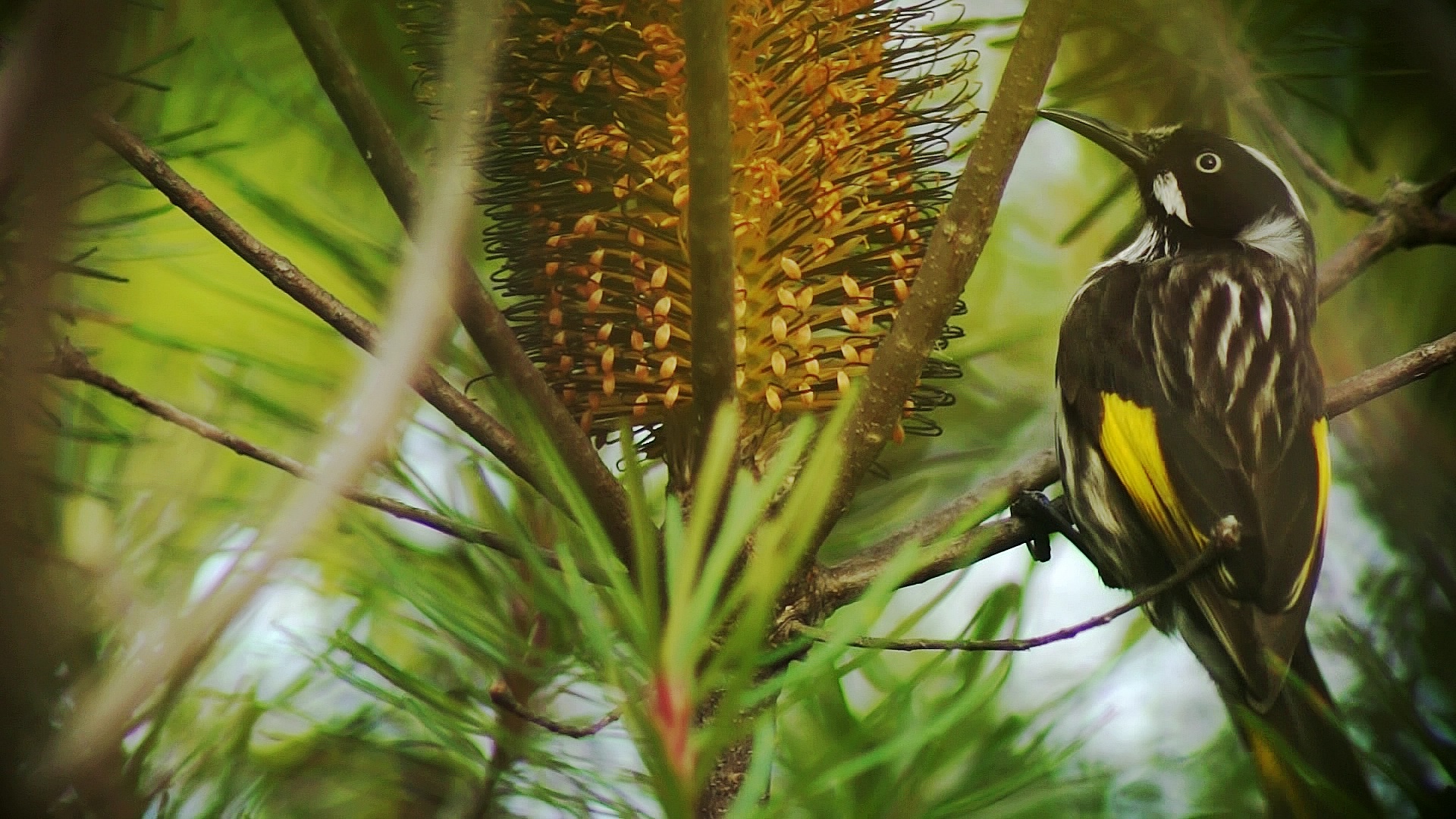

Here are some HD frame grabs from a recent wildlife shoot. They are from a compressed 4:2:0 AVCHD stream recorded at 50i (so they are 'field' grabs actually) shot with my VG20 (Shutter @ 1/50th, 0dB Gain) adapted to my heavy Carl Zeiss 600mm F4.0 telephoto lens.
The first shot shows the result of using the Schneider Optics Digicon 1/2 filter. This filter reduces highlights and lifts shadows by 1 stop respectively, thereby compressing the picture and preventing highlight blowout. The second shot show the result after minor Lift/Gama/Gain adjustments (plus a tiny bit of sharpening) were applied in Post. My tests indicate this filter is one of the best ways to improve pictures shot with any with 8bit camera as the flatter picture profile is created 'before' the light hits the sensor, not after the event.
Anything new with picture profiles?-digicon_50i.jpg   Anything new with picture profiles?-digicon_50i_corrected.jpg
