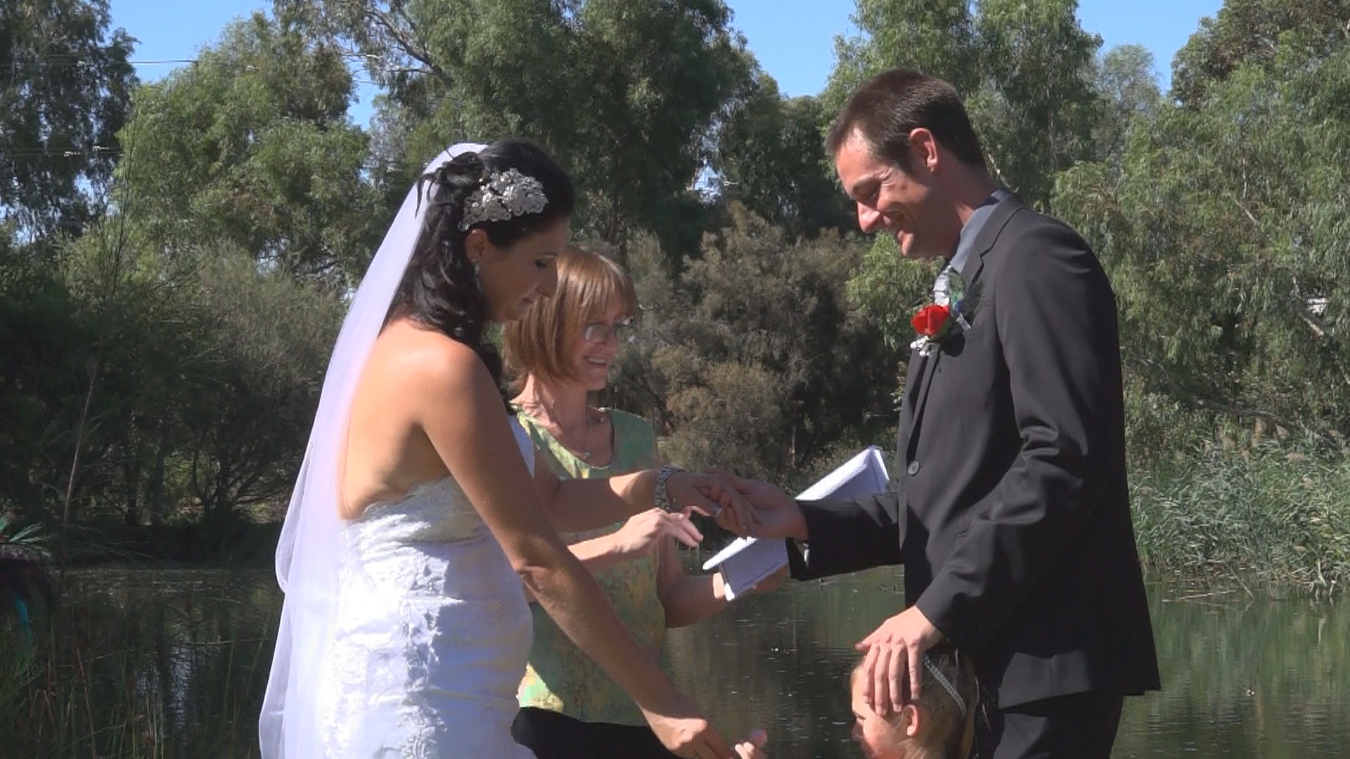

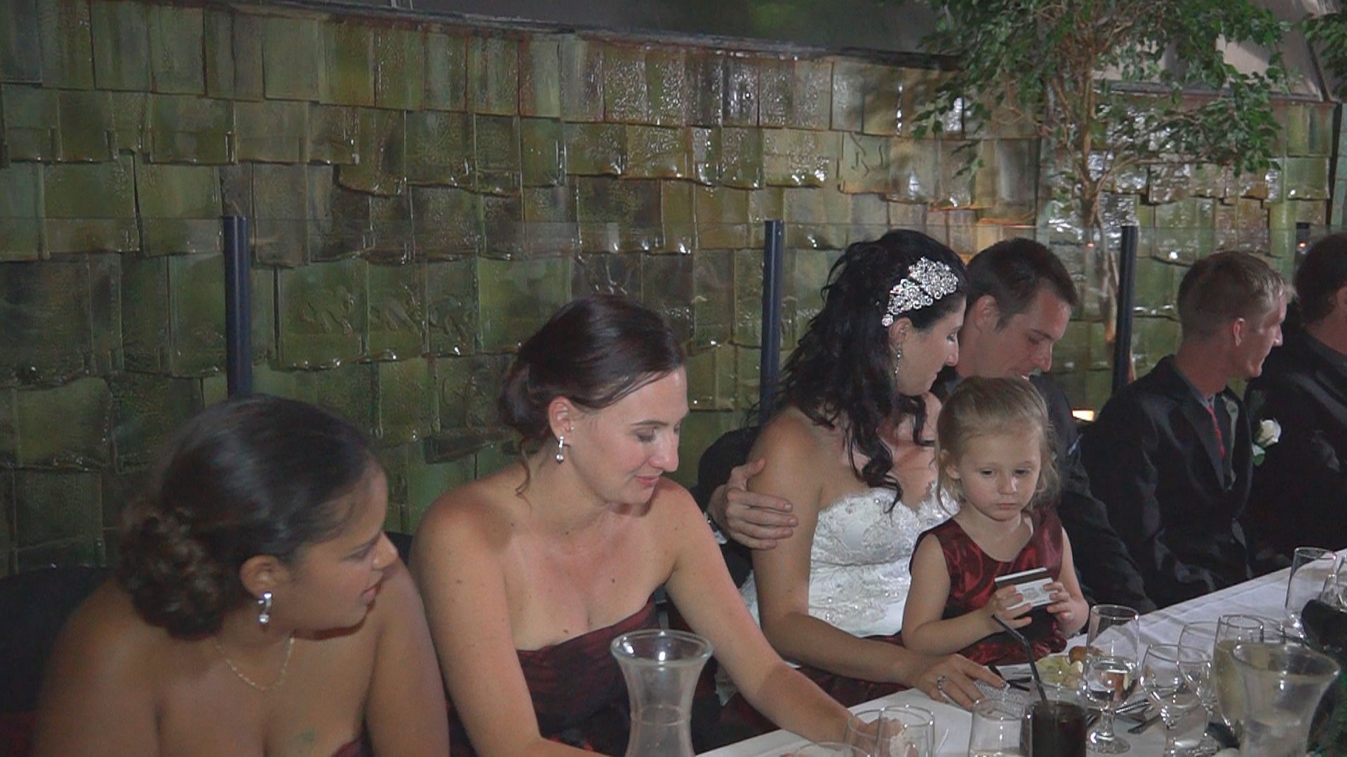

I have attached 4 1920x1080 frame grabs .. Image PP31 is just PP3 with the Colour Level pushed +2, Image PP32 is the same frame with the outdoor saturation corrected in Sony Vegas. Image PP33 is an indoor shot at the reception with uncorrected PP3 and Image PP34 is a corrected frame in post with the saturation level boosted only 50% od what I boost in Vegas for outdoor shots.
Pete?? These look a lot flatter in colour than your samples you posted or am I wrong?? Yours already looked pretty much ready to use. Would that be because 50P produces maybe more saturation than 50i footage??

Chris I think your indoor PP3 shots are similar to mine - very flat and need lifting - A apply a setting of 120% saturation using the fast colour corrector in PPro and adjust the input levels a little to give it a little 'punch' and restore some contrast - never use the 'brightness and contrast' filter though as it's quite destructive - levels are better for this job.
For some reason though my outdoor shots using PP3 seem to need less in the way of adjustment.

Now, I find the complete opposite to you. I did a Church wedding on Saturday and the indoor shots needed very little boosting but the outdoor shots were very flat indeed (probably due to the rain?)
When I'm doing colour correction I tend not to use levels at all ...I was told use the Corrector in Sony Vegas and adjust Saturation, Gamma and Gain. However I do have Brightness and Contrast (never us e that!) and also levels so I must play with that as sometimes my footage needs a little bit of punch!!
