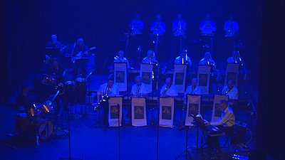

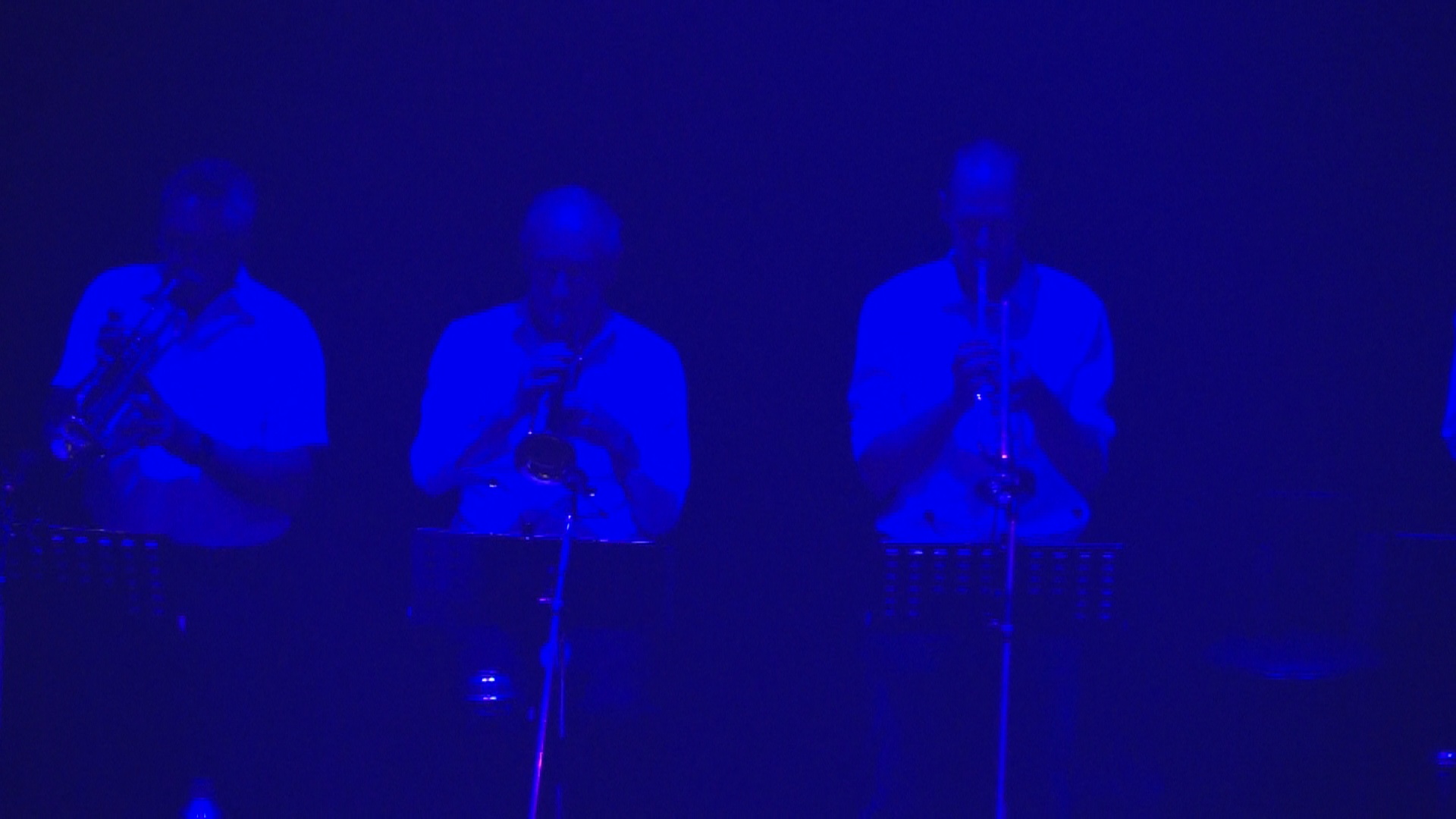

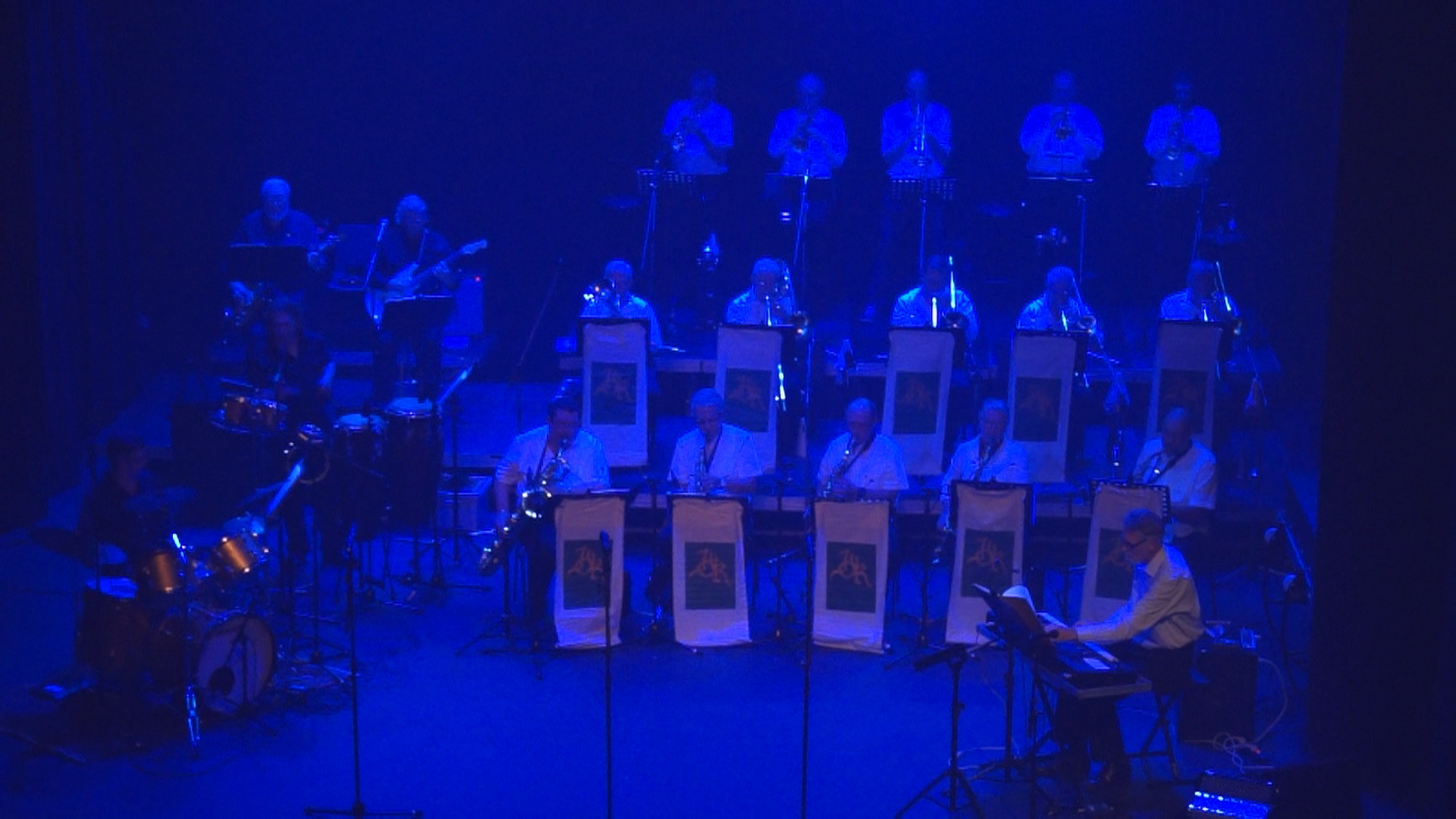

I noticed everytime I film something with fluo lights the image is much too saturated. It blows that fluo color too much.
I always film without a preset. Didn't had time to test presets.
I attached 2 samples. How I can avoid this?
My previous cam sony HXR-NX5 had an ioption in the menu "reduce flicker" for that. I can't find that option into the nex-ea50.

Hi Tom
Were you in full auto or totally manual ? That whole image looks like you have 30db gain and the white balance has gone out the window ... Sure it was fluro? That to me looks like the horrible cast you get from blue LED lighting and it's a killer too ...the cameras white balance cannot handle it and some theatres have started using LED lighting because it's so energy efficient. In very low light not only does the autofocus not work well at all, but the white balance also has issues.
Those are stills so we cannot see any flicker but if you are filming in progressive (like 25P or 50P) then yes, you will get flicker with a shutter at 1/50th in Europe cos the mains frequency is 50Hz ... the only solution for progressive to stop flicker is to use a shutter of 1/100 which drops your light a huge amount so you would need a much faster lens!! I do indoor stuff with lighting all in 50i and interlaced footage can handle flicker much better and you then drop it into a 25P timeline after de-interlacing and you have no flicker.

Looks like the dreaded LED to me - a lot of DJs now use them but worse is when a band a wedding reception use them - renders a lot of the footage of the band themselves useless IMO - impossible to white balance :(

Guys - you are going to have to get used to this. Blue has always been a desired colour - pop/rock concert Lighting Designers have used it for years - Lee 181 Congo was the solution - BUT - it passed less than 1% of the light going through it, so getting decent levels was impossible without big budgets, and lots of kit.
Now with LED, they have for the first time a bright saturated blue - exactly what they want. The fact that some video cameras cannot handle it, is not their fault. If the video is more important than the effect to the audience, then the lighting can be adjusted in the planning phase. All my work is in this area, and for years, the BBC turning up at a theatrical event meant blasting the hell out of the levels, removing shadows, and giving people suntan! Then cameras became more sensitive and normality returned, but now you have colours to contend with.
It does seem that some cameras have poor handling of colour when it comes to auto exposure, deciding the illumination is wrong, and adjusting the exposure badly.
We have lighting, sound and video people, and they all get compromised by each other. In the end somebody suffers. Video often was considered the primary medium, so sound couldn't get their boom in, and the lighting was 100% for the picture. That is NOT the case any more. Tungsten lighting isn't being dumped for economy reasons, but for performance reasons - RGBA colour mixing means the designer can have whatever they want, and at the moment, they want blue.
It is not going away, and to be honest, I rather like the blue look on those musicians - sure the camera needs looking at. Focus and exposure are important things to get right. Some cameras do handle the blue ok. My HD JVCs are not bad at all on auto exposure.

I suspect they do. The trouble is that the output spectrum is just huge spikes of colour - so there is a massive burst of blue at a very tight range of wavelengths, and the rest is nothing. I'd assume that the measurement of light level from a typical camera is designed to look at a range of wavelengths, so the exposure indicates it's not what it really is. I think some brands respond quite differently. Panasonic and JVC (what are available to me) are quite happy, but I did try my old Betacam, which was never that comfy with red, and red LED light sparkles amazingly, while the blue kind of glows.

Chris, I was in full auto and gain limited @ 24db. Was filmed in 50i this time. final product will be dvd.
not fluo but blue led lightning I suppose. So next time film in manual and set white balance at indoor?
You will not get flicker shooting 50p and by choosing a shutter of 1/50, I shoot like that a lot and don't have any issue, unless they use cheap led's, but then 1/100 shutter doesn't solve the problem either but often I have to choose 1/30, 1/40 or 1/60 to get rid of it.
Tom, was that blue color the only color used? you could try to use a very flat preset and dial down the saturation as much as possible as you can still add that a bit in post. You could also dial down saturation in post on the recording you have now, that will bring back detail as well.
