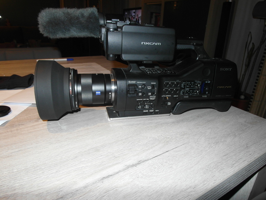

I just bought a rubber lens hood for my variable nd filter from genustech. looks great. Will test this weekend because it's winter here and still to fast dark outside.
it's a 77mm genustech variable nd filter. The rubber lens hood is a 82mm and it fits. So the inside of the nd filter is 77mm and the outside is a 82mm?
Without the nd filter the rubber lens doesn't fit a 77mm step up ring.

Looks good. Im interested to hear how it performs. I wish the EA50 had built-in ND. It's easier to shoot with out in the field than the FS700
