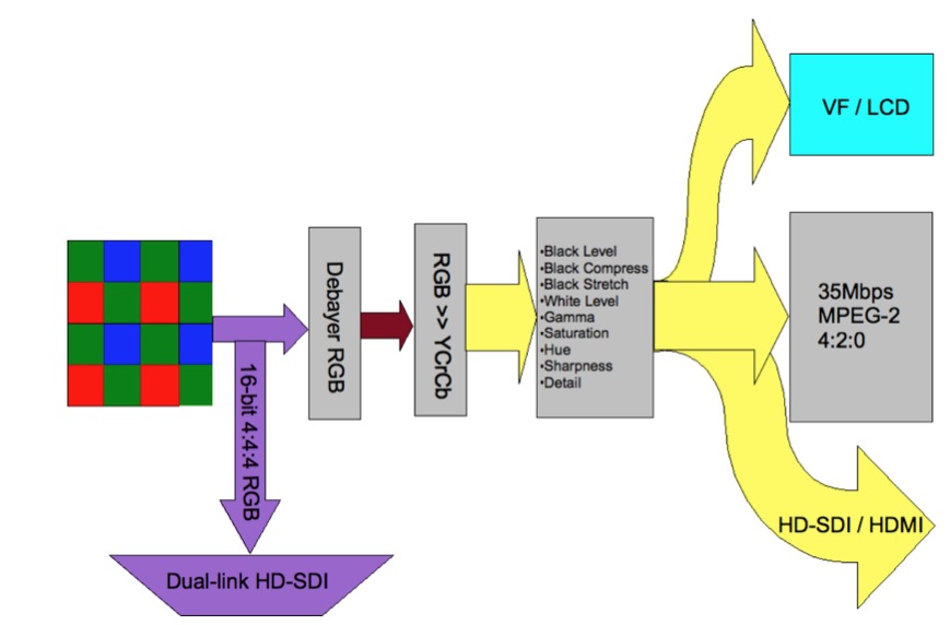

My FEELING that the chip had many more pixels was Juan's comment that Sony won't allow him to give the sensor spec. Why I asked myself? My GUESS was that the the chip had enough photosite resolution to support 4K2K in a future camera and Sony didn't want to make it obvious they would have such a camera announced in the next year (NAB 2012).
I was mainly looking at the FS100 which -- as you said -- seems to be "different."
But the Service info seems to eliminate my idea of a super high rez chip. pixels = photocites -- I guess. :)
So same chip -- perhaps two radically different ways of debayering? The F3 can output RAW S-log 4:4:4 data. That means the debayer likely can't be done as part of the readout process. It would be a post readout process on a FRAME of sequential RGB data. By hving a complete frame of data both the debayer and downscale can be performed over many pixels in all directions. A powerful DSP could do real magic in turning these data into 2MP of YCrCb values.
The FS100 might not do this -- so less heat and power and lower cost. It would need only a few video-lines of memory and so the debayer interpolation would be restricted to nearest neighbor.
Since the sensor line is longer than a recorded line, YCrCb vales must interpolated to create a downscale. That's EZ. Harder is the fact lines must interpolated to downscale the number of lines. This might require 3 lines of memory.
New NEX camcorder on March 31?-screen-shot-2012-03-17-6.49.37-pm.jpg   New NEX camcorder on March 31?-screen-shot-2012-03-17-6.39.45-pm.jpg
