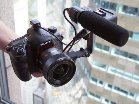

SONY NEX 6 have the n1 Multi-Interface Interface connector integrated @ Flash Shoe
Maybe it works with 800$ XLR-K1M Phantom XLR Adapter
Some sources says yes others denied it
1:30
Here an adapter for older stuff = SONY Bluetooth Wireless mic?
Sony Multi Interface Shoe Adapter | ADP-MAA | Sony USA
Sony also used a variety of other proprietary hotshoes for other digital cameras and camcorders, including the ISO-based 6-pin Cyber-shot hotshoe, the 16-pin Active Interface Shoe (AIS) and the ISO-based 16-pin Intelligent Accessory Shoe (IAS). Some of their NEX cameras used a proprietary Smart Accessory Terminal (versions 1 and 2). In September 2012, Sony announced a new ISO-based 21+2 pin Multi Interface Shoe for use with their future digital cameras and camcorders of the Alpha, NEX, Handycam, NXCAM and Cyber-shot series. This quick-lock hotshoe is mechanically and electrically compatible with a standard 2-pin ISO-518 hotshoe, but electrically compatible with the previous Auto-lock Accessory Shoe with extensions, so that passive adapters ADP-AMA and ADP-MAA allow to use digital-ready iISO flashes on new cameras and new Multi Interface Shoe equipment on older cameras, while providing compatibility with standard ISO-based equipment as well.
Werner Graf is offline   Reply With Quote

That adapter WON'T work with the Somy bluetooth mics - those use the AiShoe on the handycams, which is a DIFFERENT proprietary connector from the KM shoe on the Alphas.
It does appear that there is a mic input in the new shoe design, it may or may not have electronic "triggers" that announce that an audio input is there and the camera should expect it. AiSHoe accessories usually have specific electronic configurations to "tell" the camera what is in the shoe.
