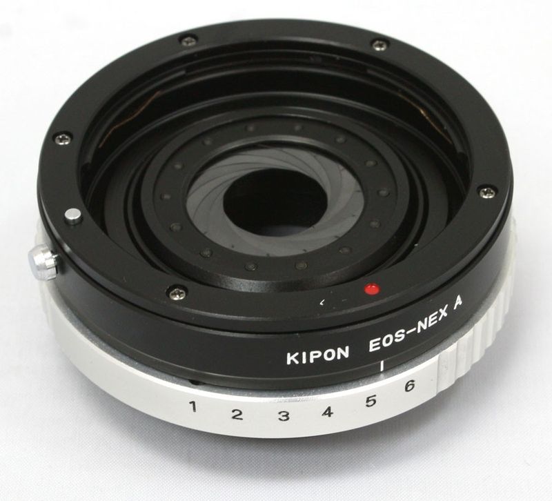

Fundamentally, mechanical-only adaptors don't send information to/from a NEX. The problem comes with -- as you foresaw -- aperture control. When I studied Minolta lenses, the older lenses that never assumed any connection to the camera were simplest to understand. But, see new adaptor below. It seems to have an aperture of some kind inside that allows you to use newer lenses that interact with a camera. I assume the lenses aperture is fully open.
As you might guess, during focusing, you want to open an aperture fully for minimum DOF. The NEX, when set to shutter-priority, will auto-adjust exposure -- if it can. In very bright light fully open at 1/50th a NEX may over-expose. [So you may need to use ND filters -- which you'll need anyway if you will be shooting for minimum DOF.] After focusing, you dial a smaller aperture. IF the adaptor is only adjusting blades you can NOT read the F-stop. :(

You need a smart adapter with canon lenses. There is not a lot of option in the moment. The most promisiong one is the Conurus/Metabones adapter: Sony NEX System : Canon EF Lens to Sony NEX Smart Adapter

Out of stock right now. $400
http://conurus.com/product/sony-nex/ef-e-bm1-detail
AND
sonyalpharumors | Blog | Kipon EOS to NEX adapter with built in aperture control.

And I can assure you that you DON'T want an adapter with a built-in iris. I tried it. It dosen't control the aperture at all, it only cause severe vignette and unwanted ugly bokeh. The iris blade must be inside the lens, between specific lens elements. Not behind it.

"it only cause severe vignette."
Actually it was tested and found this worry to not be founded.
The plain fact that any lens should never be stopped to near close. The tests-- as I remember -- showed the range from 2 to 5 was fine. I did not read the test for detail because I'm not going to buy one.
Did you personally test for "... unwanted ugly bokeh."?
I suspect that MIGHT be true, but claiming something to be fact without a test is bad form.
PS: I guess looking at the diameter of each position one can estimate the amount of light being cut FROM the F-stop of the lens. So for each lens I guess one could chart the f-stop for each setting.
It's very cheap so someone with a collection of Canon lenses should buy one, test, and post. You can return it.

I have bought it and tested it (of course with only a few lens I have on hand, not all the lenses in the canon line) and the center is never affected, just the corners.

This is consistent with my own tests. But the NEX cam have bigger sensors, and the vignette effect is more severe.

Great find. Looks like with lenses under 200mm one can't adjust past "3".
And, the faster the lens, the more one can close, but of course the more one would need to close in bright light.
So the question is what is the F-stop adjustment at 1 through 3?
Were it 2 stops, then it MIGHT work for me if I had Canon lenses.
I use a lightmeter just like when shooting film.
For a shallow DOF, I let the amount of light guide to the amount of ND filtration needed -- and ACCEPTABLE -- with a Vario-ND filter (about 3-stops) to bring camera settings to 1/50th (e.g, 24fps) with an aperture setting starting 1-stop more closed than fully open. (With an F/2.8 lens I aim for f/4.)
I want to keep the aperture no larger than f/8 to keep the shallow DOF.
Since I find no visible difference with shutter-speeds from 1/30th to 1/60th I can tweek speed if necessary.
In super bright light, NV and India for example, I will have to break the rule and add a fixed ND filter to bring filtration to 6-7 stops.
The same procedure works even when I don't need shallow DOF. I then keep the f-stop between f/4 to f5.6 and f/8 to f11.
PS: Obviously, with a faster lens in bright light one needs to cut light more, but it looks like the adaptor allows more with faster lenses.

While I have a few Canon EF lenses that I wouldn't mind trying with the VG20, it seems a bit ridiculous to spend a lot of money for an adapter that seems to be less than satisfactory. Why not consider staying in manual mode and buy some good old Nikon or Pentax glass and add adapters from Ebay for about $ 15.00 each. For $ 400 and proper shopping on Ebay, you could come up with 3 or 4 decent primes or zoom lenses that will suit your purposes well.

... it seems a bit ridiculous to spend a lot of money for an adapter that seems to be less than satisfactory.
Not sure why you say this. From the review, " I like that phrase he wrote: 'The adapter works as you’d expect with no lag, and OIS works fine. It really is like having a Canon mirrorless camera.' ”

It's the same price as the new Sony alpha adapter, less than half the price of the MTF adapter, and gives you more feature. The price is perfect IMO. And the newer filmware (02) seems to have fixed all of the first batch issues.
