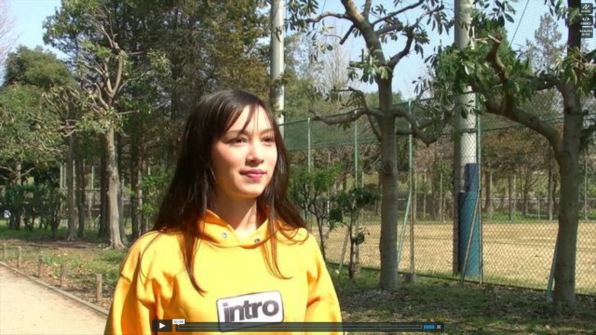

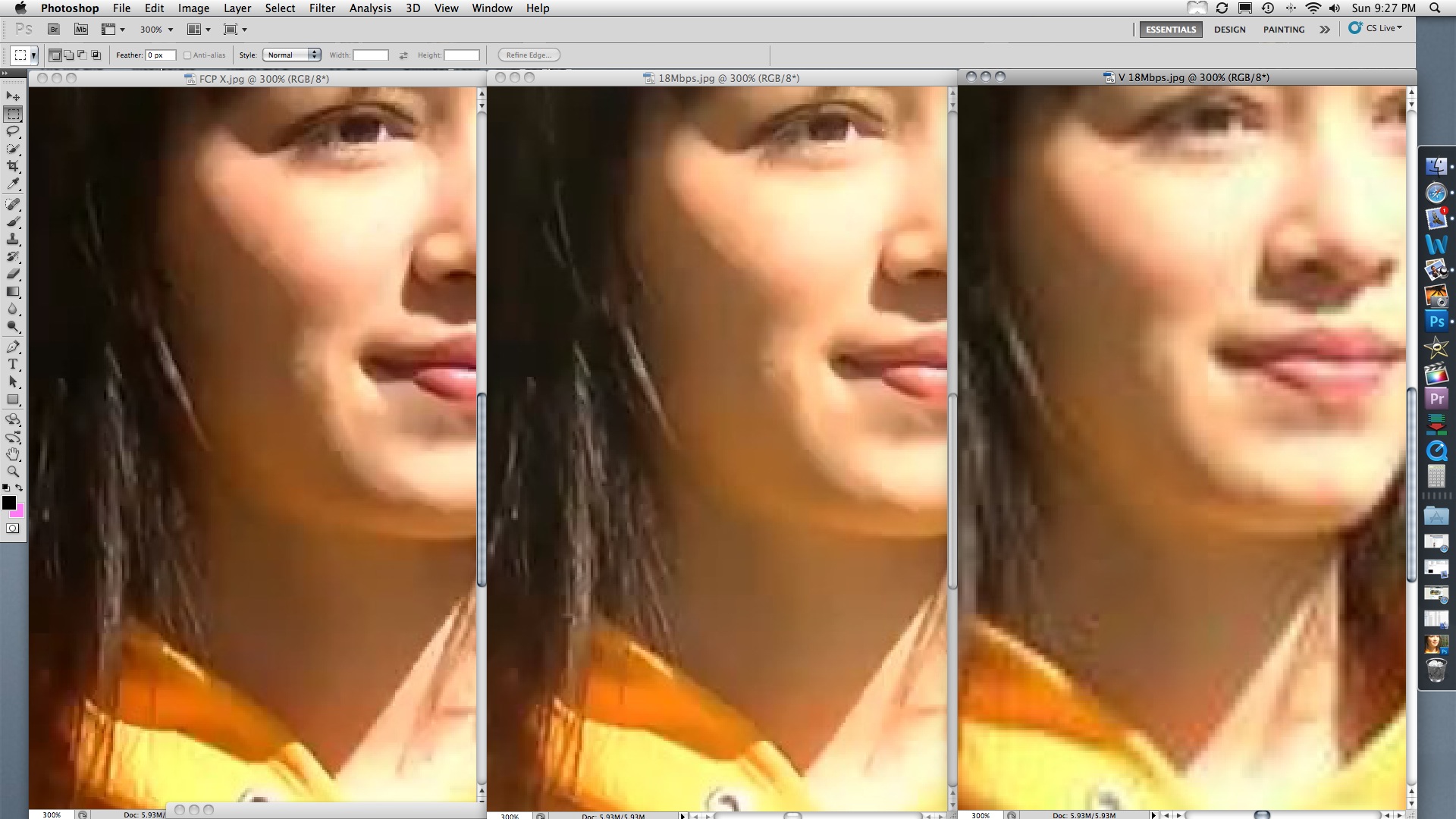

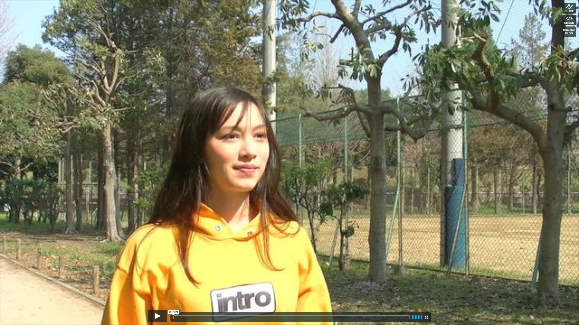

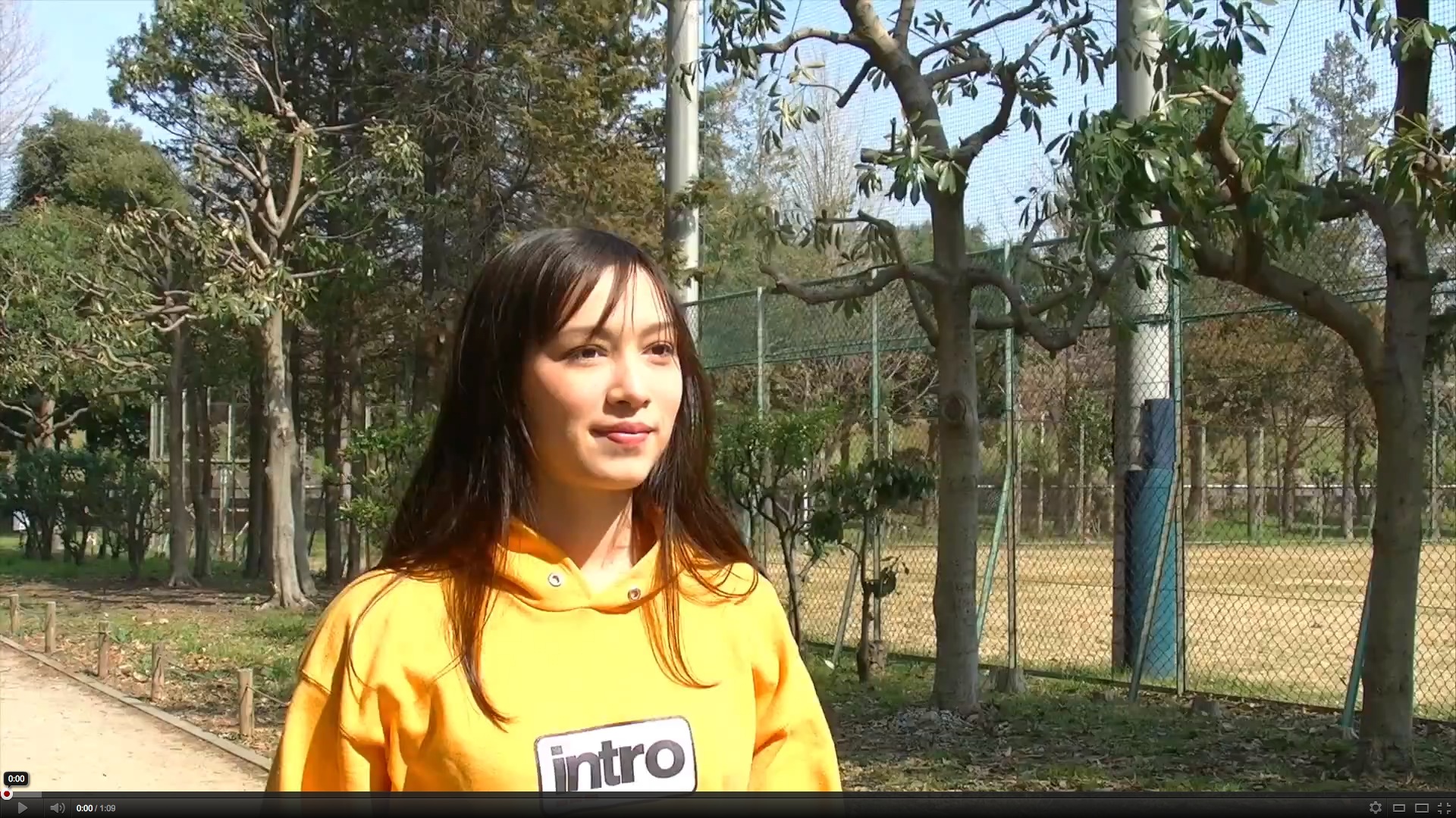

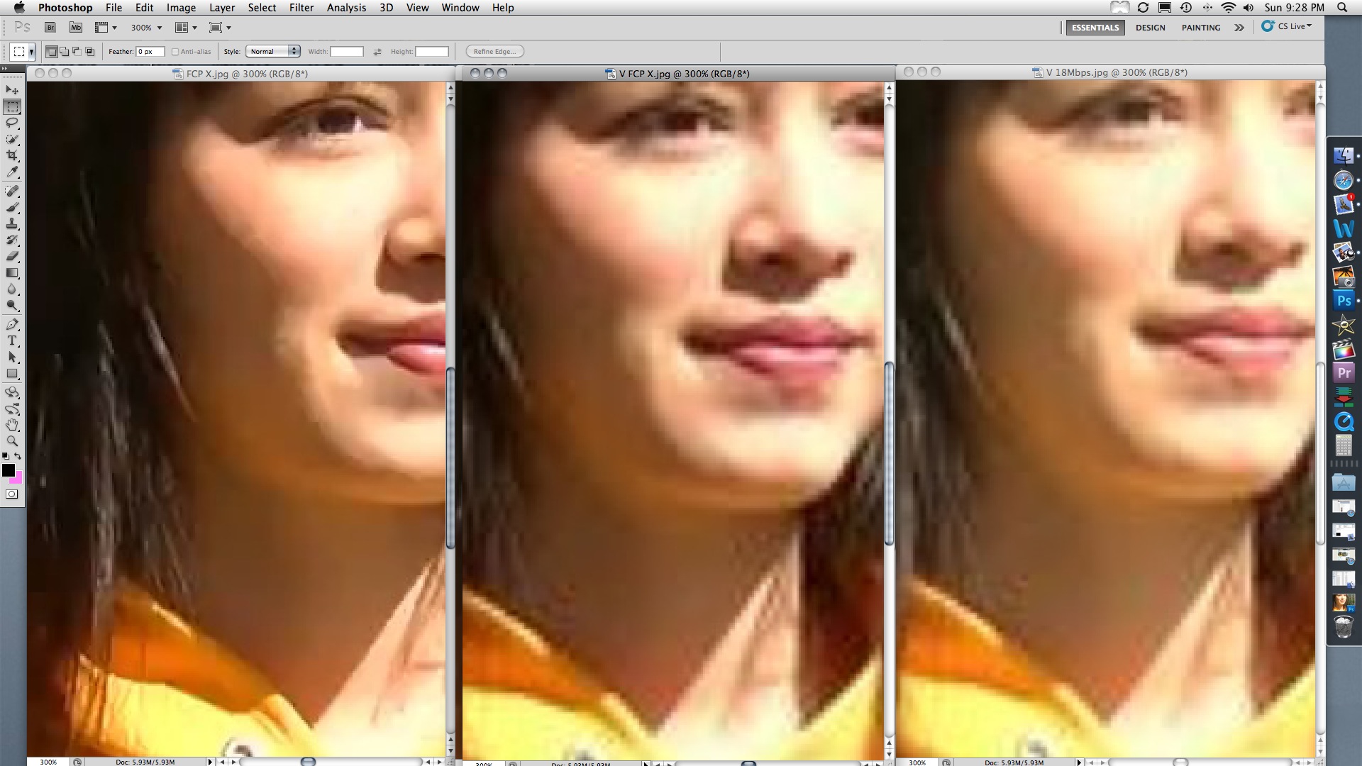

You Tube and Vimeo -- types of upload

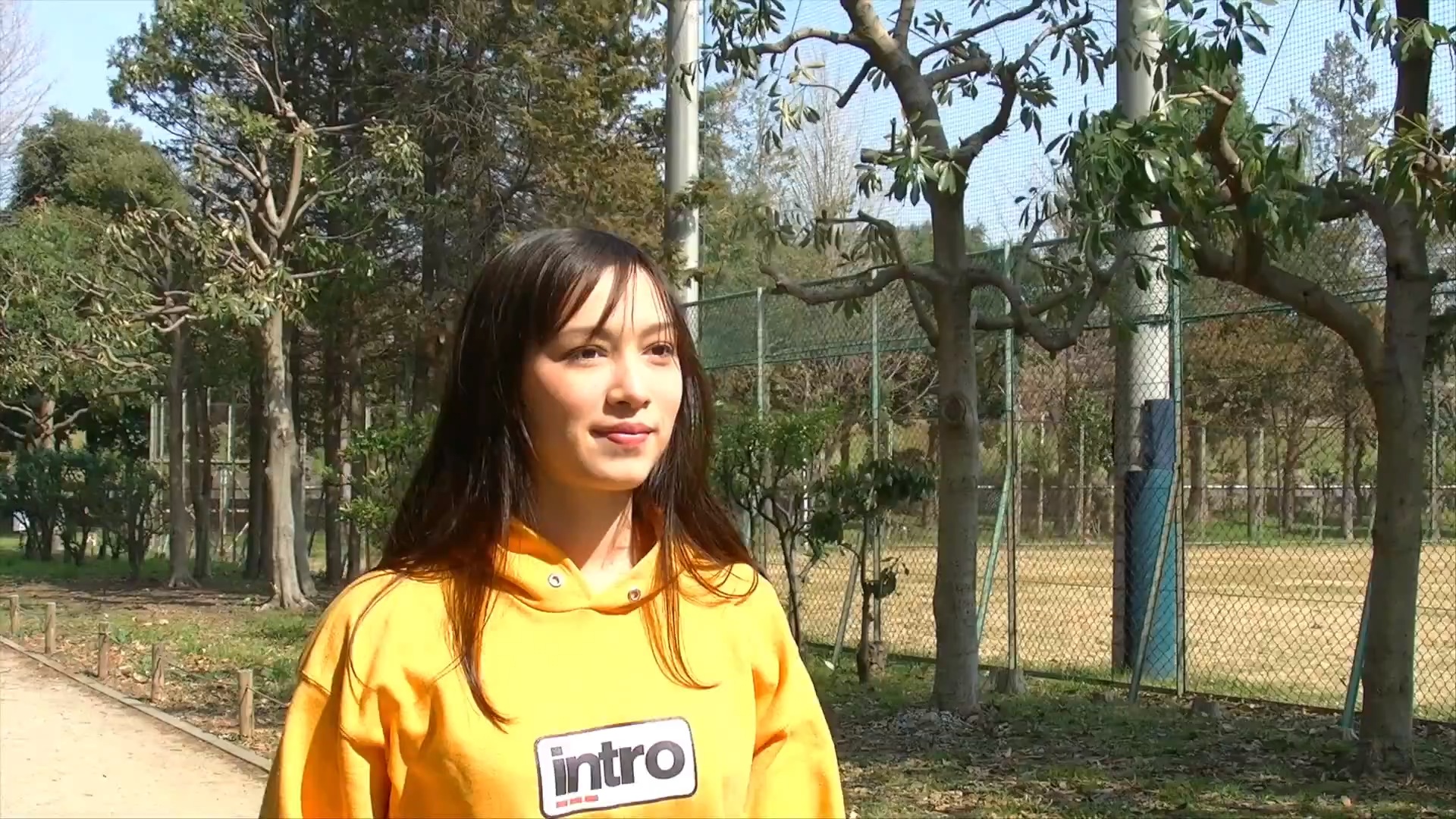

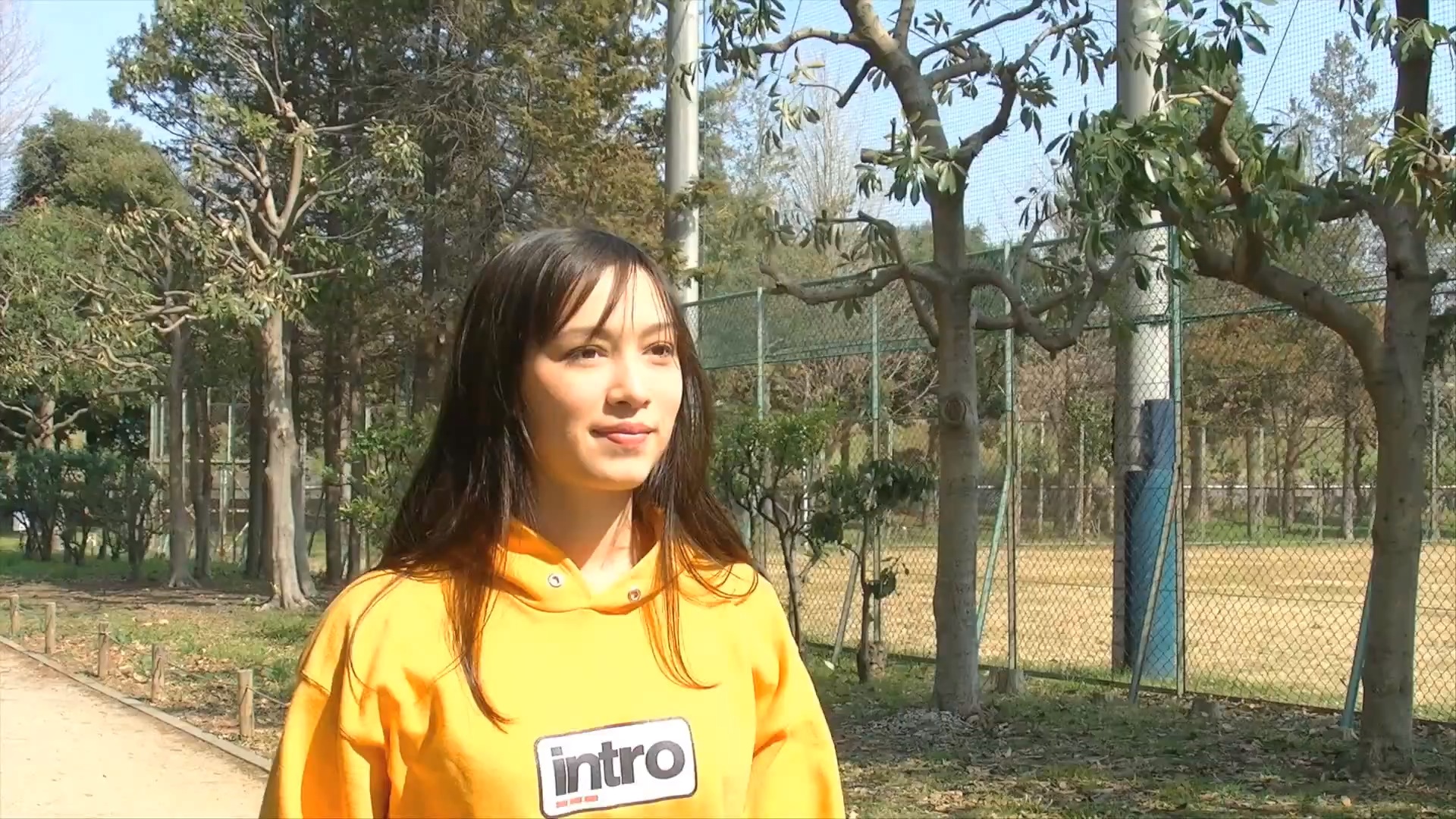

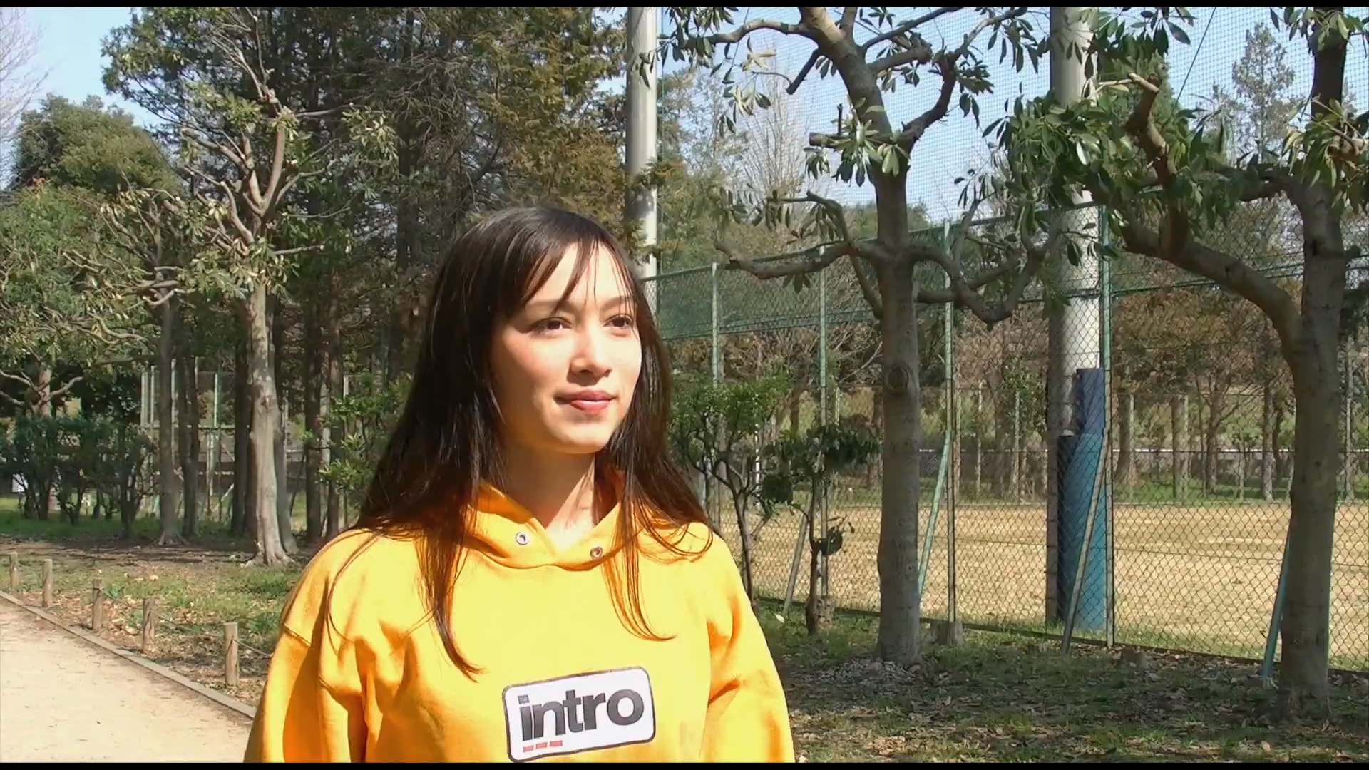

Should you compare cameras using YouTube or Vimeo? Should you use either?
How should you upload?
I'm now working with FCP X which can SHARE to both using the Apple H.264 codec.

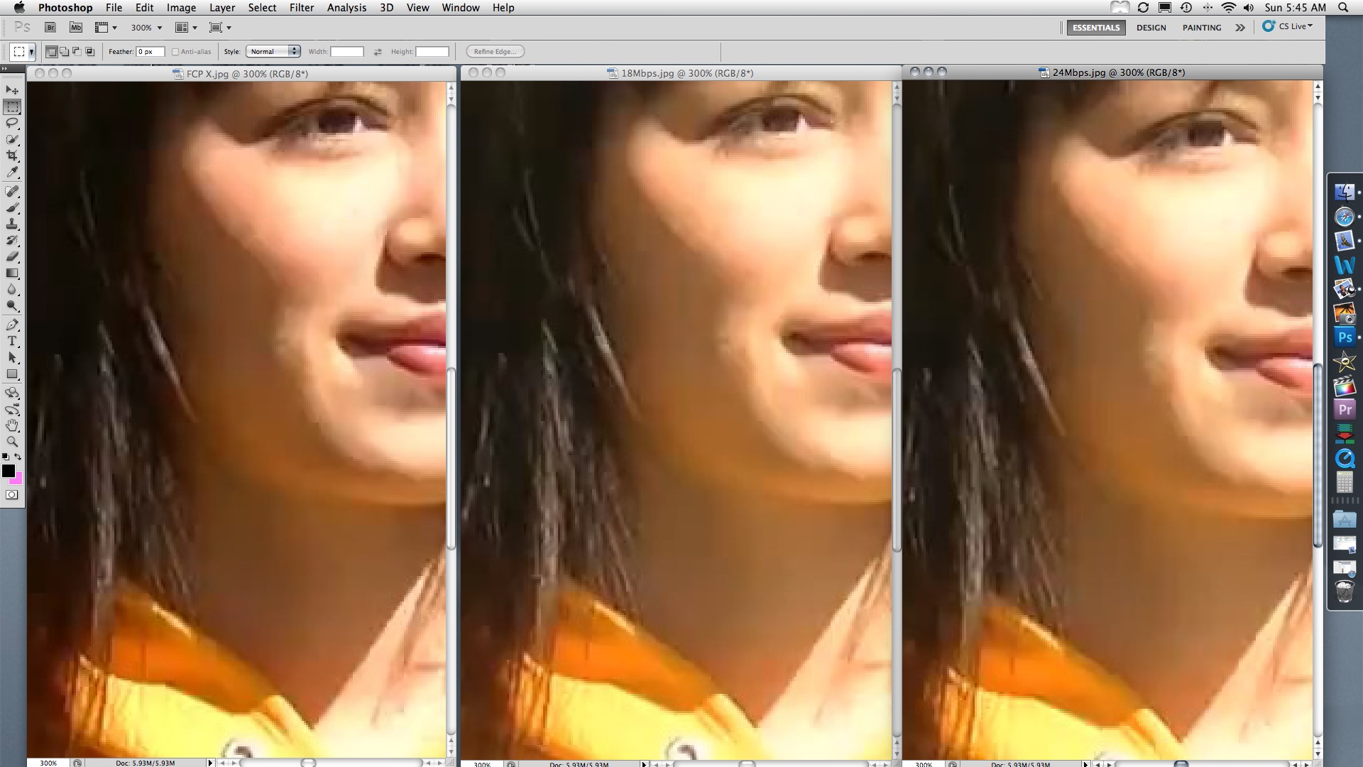

Is it worth exporting using the X264 codec before uploading?
Export to X264 at 18Mbps or 24Mbps?
If YouTube looks good to you -- my estimate is YouTube, viewed on a 63" HDTV, has only 60% to 75% of the resolution of AVCHD to a DVD. This explains why when I see VG10/VG20 camera tests on the web the cameras are SO soft compared to what I see at home!
You Tube and Vimeo -- types of upload-fcpx-u.jpg   You Tube and Vimeo -- types of upload-fcpx-v.jpg
You Tube and Vimeo -- types of upload-18mbps-x264-u.jpg   You Tube and Vimeo -- types of upload-18mbps-x264-v.jpg
You Tube and Vimeo -- types of upload-24mbps-x264-u.jpg   You Tube and Vimeo -- types of upload-u-compare-all.jpg
You Tube and Vimeo -- types of upload-fcpx-u-fcpx-v-18mbps-x264-v.jpg   You Tube and Vimeo -- types of upload-fcpx-u-18mbps-x264-u-18mbps-x264-v.jpg

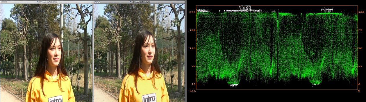

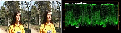

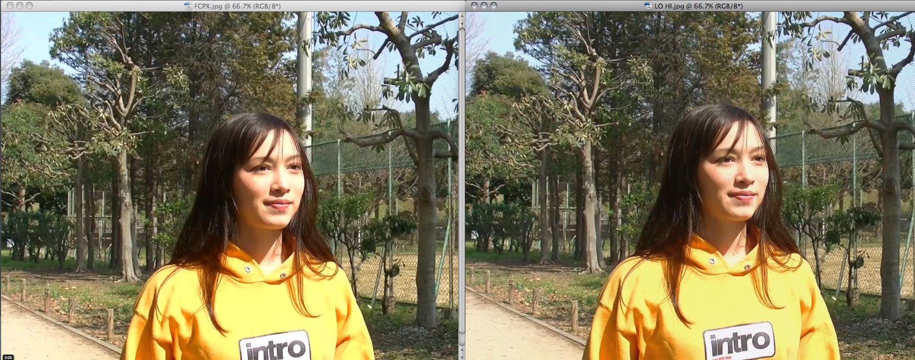

For those who noticed the shading difference between direct FCPX and export and upload of X264, I found that setting a Compressor Preset to:
RGB HIGHLIGHTS = -10%
RGB SHADOWS = +6 or if you prefer more compressed shadows, = 0%.
Looking at the vectorscope, the Preset nicely keeps peak white at 105% rather than 110%.
PS1: these data were obtained with a RGB SHADOWS = +7 which I've no cut back to +6 so blacks touch 0%.
PS 2: There would be nothing wrong in using 36Mbps.

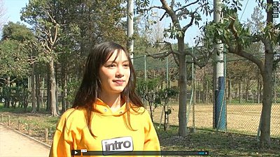

You Tube and Vimeo -- types of upload-fcpx.jpg   You Tube and Vimeo -- types of upload-lo-hi.jpg
You Tube and Vimeo -- types of upload-screen-shot-2012-02-28-12.17.27-am.jpg   You Tube and Vimeo -- types of upload-screen-shot-2012-02-28-12.59.26-am.jpg
