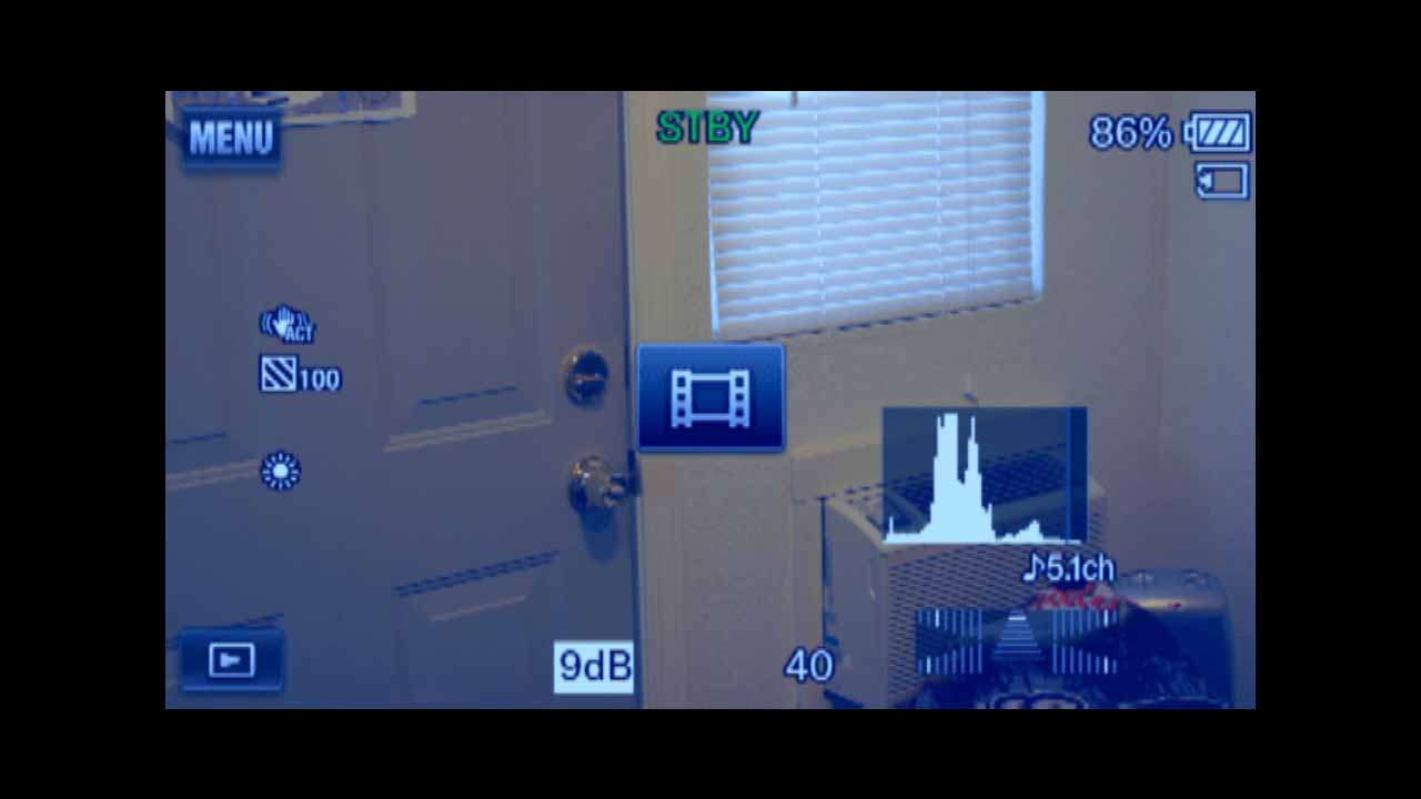

I just tried the photo mode you suggested out to my HDMI TV and note that when I was pointing camera at grating on an air conditioner, using any of the photo settings, the image suffered much more from moire and aliasing. A lot worse than in video mode. I do have a Black Magic Shuttle which captures through HDMI cable. The file attached here is from a file I shot on the shuttle. Starts in photo mode, switches to video mode.

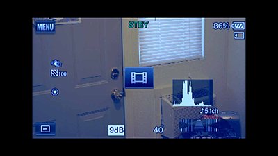

There is obviously something wrong with your video i took a screen shot of your settings and i think you need to make some adjustments and maybe choose a better subject matter that is properly lit and redo the test

Suggestion ? What setting do you recommend ?
Point of this test was that I shoot this same test in this same place with my all my cameras, and this is worst aliasing and moire I have seen on any of them. (Canon HV20, Sony FX1, Canon 5D Mark II, and the T2i.
I think its pretty clear that the HDMI output in photo mode does nothing to address aliasing/moire issues. I suppose I could set up a well lit scene, but that won't change the aliasing moire problems. AS you can see from the graph, exposure is flat and right in middle of where it needs to be and only at 9 db
