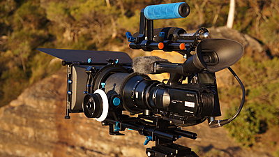

Yes, as they have a traditional 'video camera' form factor whereas DSLRs were designed to snap still images, not to shoot for long periods without additional stabilisation equipment. One of the VG20/30's greatest ergonomic features is a movable eyepiece with large rubber eye-cap so excellent when shooting for long periods indoors/outdoors and in brightly lit areas.
I use a VG20 professionally but exclusively with a collection of classic 35mm full frame Carl Zeiss lenses and a Metabones Speedbooster. In my opinion, the so called 'film look' is often more a function of using film lenses than anything else and my combination far exceeds the asthetic 'look' of the Sony kit lens. If you already have an investment in Canon 35mm film lenses, you'll see a marked improvement in picture quality with a 'Speedbooster' fitted than by just using a dumb adapter as the Metabones device compensates for the change in field of view, adds 1 extra stop but more importantly, improves contrast and seems to reduce sensor moire by correcting the aberrations cause by the low-pass/infrared/sensor cover glass filter pack when using ‘film’ lenses on digital cameras.
For covering live events like weddings, etc a zoom lens is probably mandatory and Sony's new constant aperture 18-105 F4 servo zoom is worthy of consideration as it is reported to offer a genuine servo zoom instead of the usual 'pretend' offering we usually see in the prosumer market.

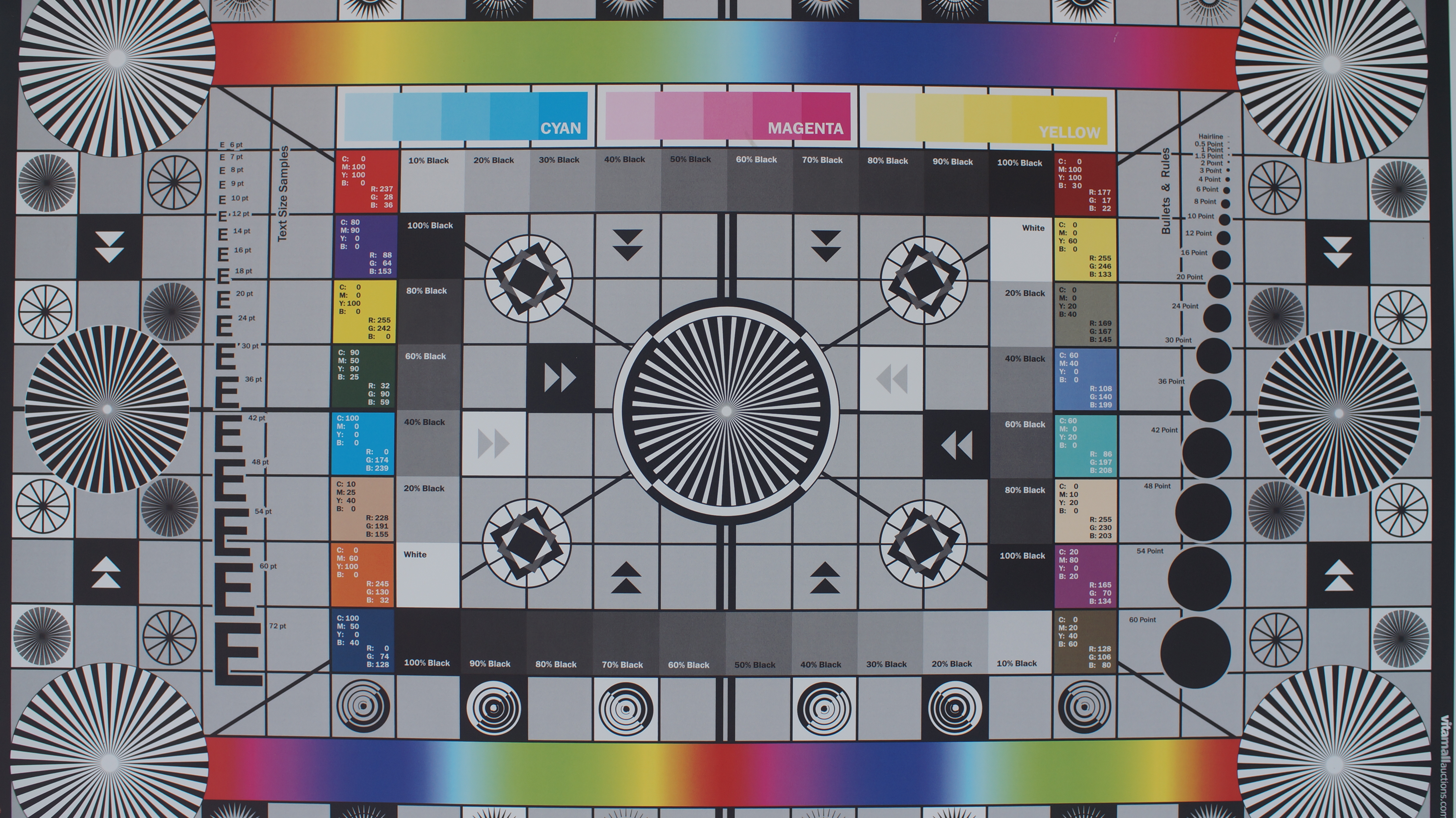

In two years working professionally with the Vg20, I've never noticed any undue moiré and aliasing issues. If you were to shoot clothing with fine lines, I'm sure you would see it but my advice to you is not to trust anything you see on the net unless you know precisely the workflow used to achieve it. There are just too many variables and lens combinations can affect this.
I recently sent some original 8bit 4:2:0 AVCHD 50P 'test pattern' pictures via my Dropbox account to a freelance broadcast television engineer who I commissioned to carry out some quality tests. I also included some VG20 RAW still pictures as a comparison. (These were confirmed as 16bit RGB, not 8bit as suggested by some forum ignoramus. A 16:9 JPEG of the 'test pattern chart' is attached to this document)
My test setup was shot in a controlled 'production' situation under studio lighting and consisted of the Vg20 and Carl Zeiss Contax 50mm F1.7 lens connected via the Metabones C/Y to NEX 'Speedbooster'. He ran my test clips through his system which includes some very expensive broadcast quality waveform monitors and vectorscopes and the result was he was truly amazed at the quality of the AVCHD stream from a Handycam! My files showed no 'illegal' luminance or chrominance issues and as it complied with Australian broadcast requirements, he had no hesitation in accepting my images for future broadcast. (Note: 50i is the preferred format for PAL broadcast in Australia.)
PS: The uncompressed 8 bit 4:2:2 signal from the VG20/30 HDMI output will offer even better quality but you must decide whether the additional cost and complexity of a 3rd party SSD field recorder is worth it.

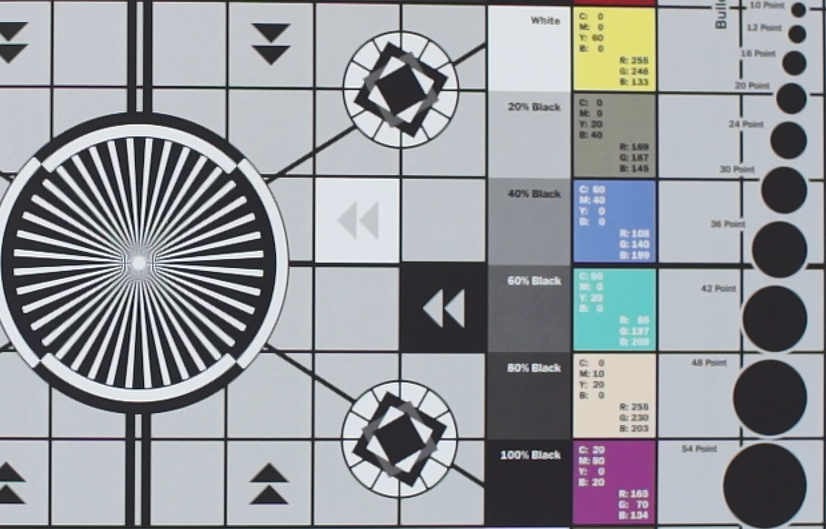

Cliff, you are correct in your statement that a 'hybrid' sensor with 16 megapixels will always have the potential for moire issues compared with the sensor on your FS-100 which is optimized for HD video but I have found certain lens/adapter combinations can reduce this to more than acceptable levels. As stated previously, I have confirmed the Vg20/30's .ARW (RAW) still images are indeed 16bit RGB. FYI, here is the quote from my engineering associate who carried out the test cited above:
"Just to be clear, I noted the (RAW) Tiff as an RGB still at 16 bit colour depth on all channels (R G & B). At 4K resolution it looks as it should. RGB stills such as this would and do use full picture dynamic range. That is to say, black is at 0 whilst pure white is at 255 units. Graphics animators and designers generally design their images in this range to utilise reference colours supplied by clients so as to maintain the overall look and accurate colorimetry from print media to on screen media. Photoshop users in particular get a bit funny if they are asked to deviate from this standard. Adobe provide all their monitor setups in SRGB standard and insist that this is the correct reference. Video people however are generally working with YUV based material or to put it another way R-Y, B-Y, & Y. The dynamic range of YUV which differs from RGB, is specified as not exceeding 16 (Black) to 235 (White) units."
I have attached a random frame-grab from an AVCHD 50P test pattern recording performed on my VG20 coupled to a Zeiss Contax 50mm prime lens and Metabones C/Y Speedbooster. If moire and aliasing were going to be a major issue, it would show up here. Compare it with the camera's .JPG 'still image' I posted earlier in this same thread.

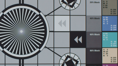

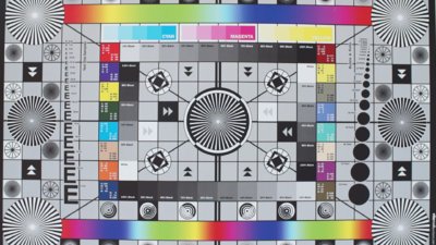

Hi Cliff, Yes I understand the line skipping issue precisely but I use the VG20's still image capability as much as I use it's video capability so with a matte box and Schneider glass filters in place, breathtaking still images can be captured with just the flip of a switch. I am considering the RX-10 (unfortunately, a fixed lens) and the new BMD 4K Cinema Camera with its global shutter as my future upgrade path.
Here are two examples: the first is 16 bit uncompressed 444 off the sensor and the second, 8bit compressed AVCHD 4:2:0. The differences are obvious and to be expected but a more interesting comparison would be to use a BMD Hyperdeck 'Shuttle' to record from the Vg20's HDMI 4:2:2 output, not to ProRes or DNxHD but 'uncompressed'.
