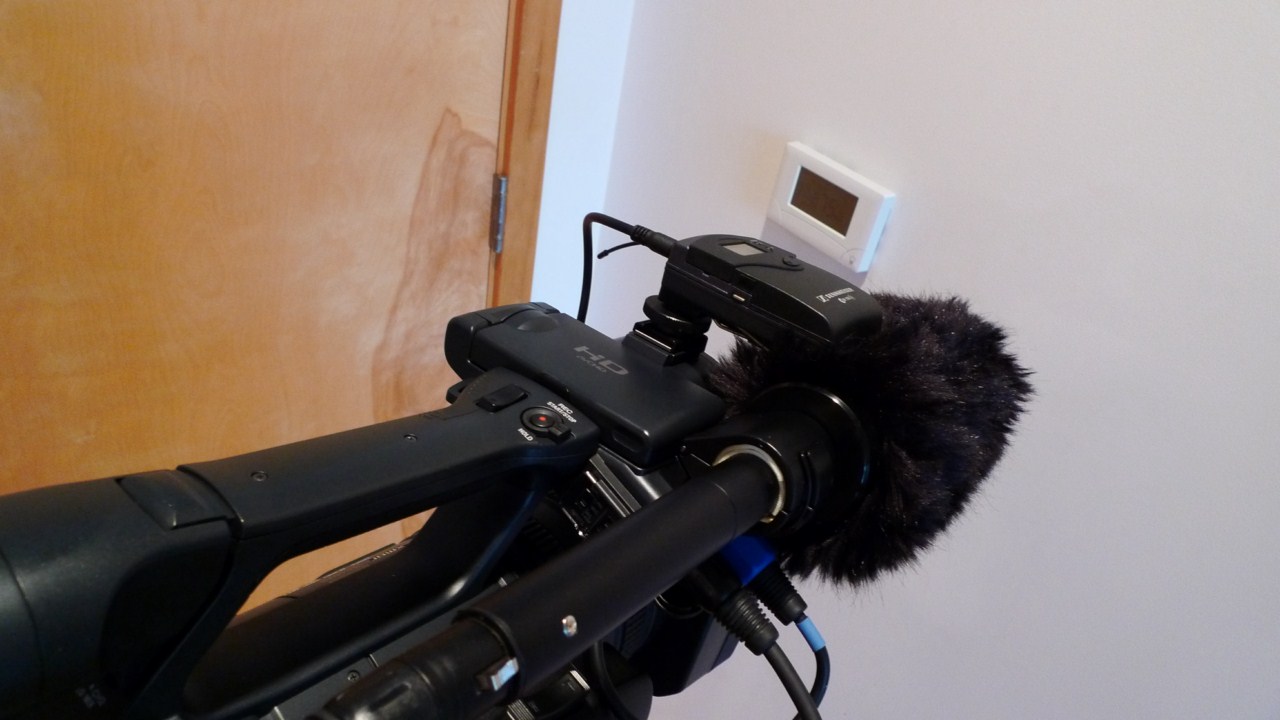

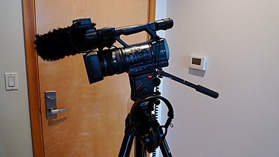

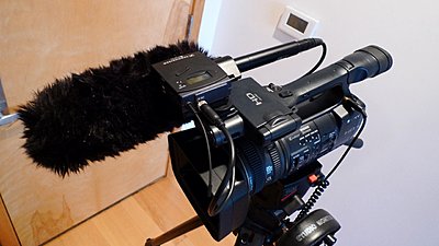

Picture of my rig with the G100 receiver and ME-66 Shotgun:
Initial thoughts on the Sony HDR-AX2000 from a newby-ax2000_rig.jpg   Initial thoughts on the Sony HDR-AX2000 from a newby-ax2000_rig_2.jpg
