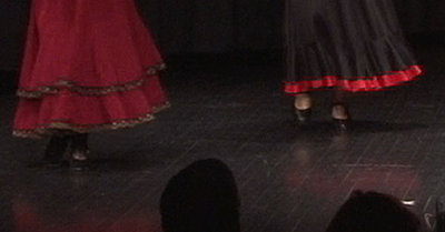

Now for the bad news. I noticed a problem with some NX files I was testing today where red colors in the footage were producing lines that looked a little like interlacing effects, except that the footage was 720p. I was seeing these lines in the Media Browser even before importing. Worst of all, these lines are present in the exported ProRes files. The same files looks fine when viewed with Movist or when imported into FCP. It's clearly something with Premiere and these AVCHD files.
I'm pretty new to Premiere so I'll start a thread in the Premiere forum and see if anyone can figure this out. I don't think it has anything to do with the various playback settings, which are all on full, since none of those should affect exporting to ProRes.

Problem Footage
Here's a still of the problem I'm having. So far it's the only footage I've seen this with but I'll keep testing and see if I can reproduce it. This is from my wife's dance recital in a theatre that was not lit for video, so I was fighting against hot spots all the time, but none of the red was overexposed. As I mentioned, the clips look fine when viewed outside of Premiere or when transcoded to ProRes in FCP.

When you export an edited sequence from the Premiere Pro timeline, does it look okay or does it still have the weird semi-interlacing going on?
My first impulse is to suggest that perhaps since editing AVCHD is so processor intensive it gives you a scratch quality preview in the editing application but will output just fine.

hey matt, had a similar problem with nx5 footage in final cut that was output as rgb 8 bit then reimported to the 10 bit project that created it. is your timeline set to 8 bit by chance?
for me, the problem has been avoided in final cut by keeping everything pro-res until the last minute then outputting as 10 bit using compressor.
i used to have the same issue with my dvx100b in final cut so for me at least it's not the nx5 that's causing the issue. something mysterious in the way the editing software handles rgb files (i assume! you can never seem to find a straight answer on things like this...)

It's the same when I export from the timeline, whether to ProRes at matching settings, or to h264 at 30p. The sequence is set to the AVCHD 720-60p preset which matches the footage, but I don't think that has anything to do with it since the lines are appearing in the Media Browser, which previews the mts files straight from the card, even before importing. The problem was also replicated on a MacBook Pro.

Looks like the problem I was getting is a known issue with Premiere, apparently a chroma bug:
http://www.dvinfo.net/forum/adobe-cr...hroma-bug.html
