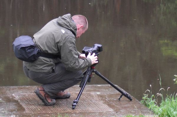

OK... so that was kind of weird.
I know I've seen the NAB demo, the CVP video with the cam-shower, but standing out in the rain today with the NX70 exposed to the elements... just felt weird!
All was good though. Exposure is going to be a problem, like any of the small cams. It was very easy today to get up to F9.6 and be overexposed (gain was at zero), so I had to bump up the shutter speed to compensate. I ended up leaving the cam on auto a lot of the time and it coped really well. I have yet to review the footage, and I need to wait for CS5.5 before I can edit it!
I've just received a fixed ND filter, so that will get tried out next.
It's hard to tell from the photo, but it is absolutely chucking it down with rain!
