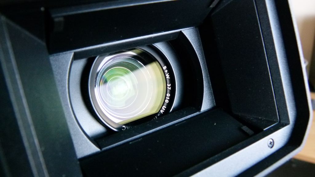

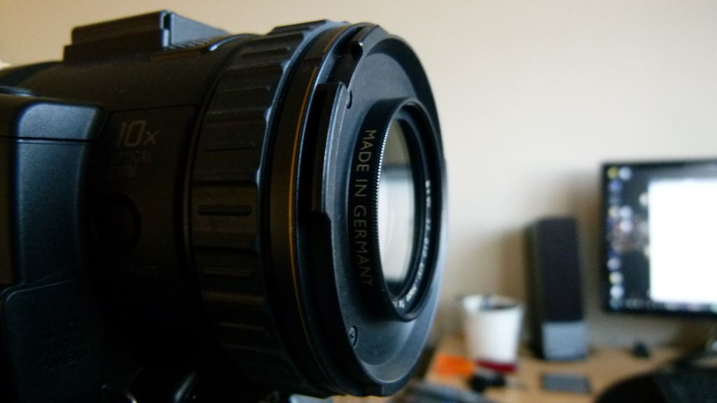

Just a query for Mike Beckett. I have had an HVR-A1P for some years here in New Zealand, and it was a great peice of kit. However I have decided to replace it, and have ordered a HXR-NX70P. One of my biggest beefs with the A1P was it had no ND filter built in. The sun here can be quite harsh and I overcame this by removing the standard hood and fitting a stepup ring and ND4 filter with a rubber hood. This worked well but lost the use of the standard hood. So I was interested to see you apparrently managed to fit a filter to the filter thread between the hood and the lens if I understand correctly? This was not possible on the A1P as it had locating fingers so the hood stayed horizontal. Can you confirm this is now changed on the NX70. Am really looking forward to the new cam which should arrive early July. One final thing can you post a still photo from the cam photo mode of say a house or something to judge detail, cheers.

Yes, I can confirm I fitted a standard B+W UV 37mm filter under the hood - not a slimline filter. I have also tried a Tiffen ND filter. They both fit fine, with a little room to spare. You just about can see it in some of my photos. I think there's only space for 1 filter at a time, unless you get slim filters (which I haven't seen for 37mm filter threaded cameras).

I forgot about the filter pics. It's actaully kind of hard to take a useful photo of the filter inside the hood, but I tried!
