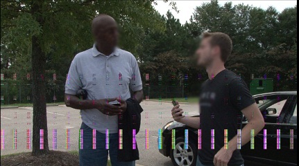

I am noticing a flickering noise problem during playback of clips recorded in full HD 30p and 24p in my Sony NX5U. The problem is not noticeable in the viewfinder when I am recording, only when playing back. Also, the problem does not occur with full HD 60i or any other recording format, its only with 30p and 24p clips. Visually this noise looks like an electric flickering noise and its apparent throughout the entire length of the clip.

This is the exact problem Im having

I had the same problem with my NX5U last year.
You have to send the camera to a Sony Service Center to replace
the lens assembly and main circuit board.
