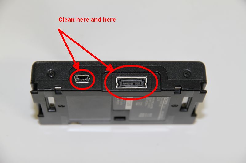

Silly question. More than lightly but have you cleaned the contacts on the FMU 128 ? They are buried in the multi-pin socket. In the past, FS700 days, I had a couple of record issues that were corrected when I cleaned these contacts and the ones in the camera. To do that I used a soft piece of old cotton T shirt material soaked in a good brand of electrical contact cleaner, like the techs use, and got the contacts moist in FMU and moist on the camera. I then went through a number of insert and remove cycles on the FMU and the issue never reappeared.
I have also heard though not confirmed that a couple of re-format cycles can sometimes fix buffer problems. Take that for what it's worth. Good luck with it!

Most hobby electrical stores have electrical contact cleaner available in a spray can. I use an old worn out bit of T-shirt as it is pretty fluff and fiber free. Cotton swabs can do the job just try to get the best ones that don't tend to shed fibers when being used.

No sir not the good old WD40. I am thinking something much more along these lines. Permatex 82588 Electrical Contact & Parts Cleaner. Can be purchased from most good electrical hobby stores and electrical component suppliers.
https://www.ebay.com/itm/3-DAY-SALE-...EAAOSw8-tWaypQ
A more elegant and more subtle cleaner than WD40. WD might work but something that has a fast evaporating base is best.
