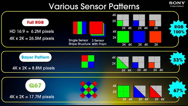

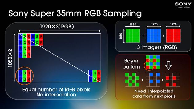

From the presentations on the Sony's 2K/4K sensor developments
http://pro.sony.com/bbsc/video/chann...rder_training/
PS I watched/listened twice, but couldn't figure out where the current S35 (as per the F3 and FS100) stands in this...
FS100 and F3 workshop at NAB-s35-rgb-sampling.jpg   FS100 and F3 workshop at NAB-s35-4k.jpg

Are the captured pixels contiguous -- meaning are columns and/or rows dropped from the pixels on the chip? If not contiguous -- what is the skipped/discarded ratio? When pixels are skipped/discarded chroma aliasing results. Very not good for the F3 at it's high price. And, obviously demo material will have been carefully chosen to not show aliasing.
Moreover, since we know the capture aspect ratio is 16:9 -- what is the aspect ratio of the chip? What are the Effective and Gross pixel counts?
This simple information has never been hidden before. Why now?
Imaging Device: It's got a BIG chip that's "Super" and yet not as big as "Full."
OK Steve - your doubts are well founded (especially in the light of BBC's Alan Roberts' report). I am an engineer, but have nothing to do with optics/electronics - so please forgive the naivety of this question:
- why "skipped/discarded"? Why not "accumulated"?
If you accumulate many tiny "photosites" into a single "pixel", you'll get the high S/N and sensitivity Sony claims...
Just a thought,
Piotr
