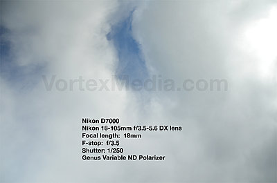

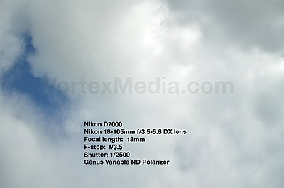

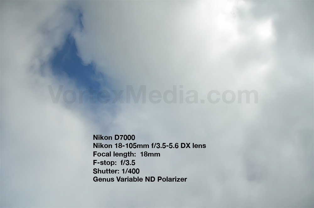

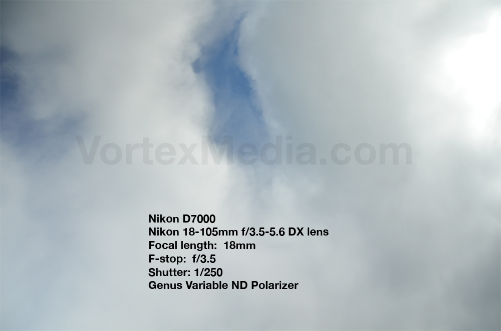

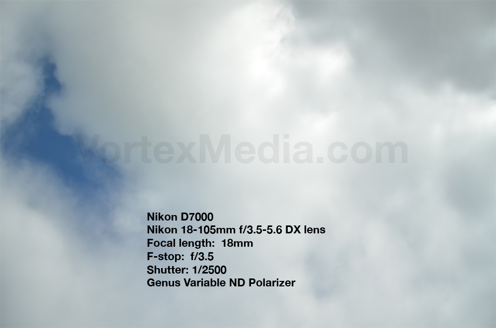

The main thing that Mr. Moritz's blog proves is that he does not know how to use an ND polarizer properly. Yeah, I can show a lot of vignetting too -- if I misuse the filter. In the proper hands, the vignetting is neglible and would only be a problem in the most extreme examples.
You seem to think that a DX lens is going to reveal all kinds of problems, so I pulled out a 18-105 DX lens that I have never used before and would never use under ordinary circumstances. It came as a kit lens on a D700O I own. Can we agree that the sensor size of the Nikon D7000 is approximately the same as the FS100? It would be nice to have an FS100 for a test, but since we don't, I've used a Nikon D7000.
Here's series of three shots, all taken at 18mm within seconds of each other -- as you can see from the cloud pattern. The only thing that has changed was the rotation of the filter and the shutter speed that the camera chose to compensate for the exposure change. There approximately a 4-stop difference between A and C.
Yes, there is some vignetting, but keep in mind that this is a worst case example. White clouds on a flat sky. If this was typical video/photo of a person, landscape, etc. with shadows, shapes, etc. the vignetting would not even be noticable. As the video I posted at the start of this thread supports.
I can live with these results. But if it bothers someone else, then they should look into using real ND filters or find another camera to buy. The polarizer is not perfect, but it is a quick and easy way to adjust the exposure in most common shooting situations. Anyone who says an ND polarizer is unusable is dead wrong. And the Genus I have is the cheapest one you can buy. I wonder if a more expensive filter would look even better?
Whether or not this lens or filter would show vignetting on a full-size sensor camera is irrelevant, since the FS100 is not full-size sensor. This is an FS100 forum.
NEX-FS100 demo footage shot for NAB-test-1a.jpg   NEX-FS100 demo footage shot for NAB-test-1b.jpg

Doug, it has nothing to do with user operation. It's simple physics.
The reason you don't see vignetting on your 18-105 is because it is not wide enough. Please read my earlier post carefully. I mention 12mm for APS-C and 24mm for Full-Frame.
The issue here is the image circle produced by different lenses. I'm sure you understand that a lens designed for full frame camera produces a larger image circle than a lens designed for a crop sensor camera at the same focal length and that the image circle will differ between manufacturers at the same focal length for the same format.
As far as I understand it, and please correct me if I'm wrong, but the FS100 sensor is S35 sized, so if I can see vignetting on on a 7D at 12mm with a Tokina 11-16mm lens then it stands to reason that I will see even more vignetting on the FS100 because the sensor is bigger.
The reason variable NDs suffer particularly badly from vignetting on wides is because they are effectively two filters. Any stills photographer used to working with filters will know that stacking filters can be problematic with some lenses at certain focal lengths. In fact you can see the rim of some variable ND filters with some lenses at certain focal lengths. The new Tiffen variable ND looks promising because it has a lower profile than most of the others and is certainly worth a try.
The work around is simple enough - use a larger filter with a step down ring, but that can be a pain too, bringing more flares and ghosting issues into the equation.
Anyway, I don't want to derail your thread further, I've only answered this again because I think it's important that people make the right lens/filter choices with this camera. I think I've said all I can on this matter, you can choose to disagree, so be it, no hard feelings:)
Here's a useful chart for comparing sensor sizes (it doesn't have FS100, but does have F3 - which is the same size):

No hard feelings at all. I enjoy the debate, and you have not derailed the thread. Topics weave and evolve all on their own.
As for me, I won't ever be using a lens wider than 17mm on my FS100 (when I get it) and my filter is 77mm, so I have already established to my satisfaction that the ND polarizer will work just fine for controlling exposure while keeping the lens wide open and the shutter speed right where I want it. Naturally, other people have their own unique needs and expectations. I think we have both given people some food for thought. Thanks.
