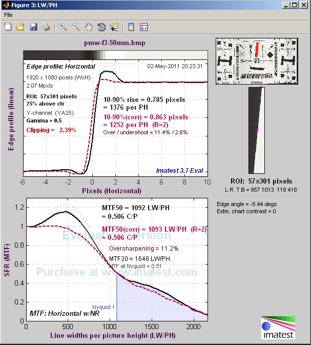

For a true idea of actual achieved camera resolution MTF50 is normally reliable and more importantly easy to measure repeatably and accurately. These are corrected MTF50 results for some of the cameras being discussed here, as measured by myself and Tom Roper. Units are LW/PH. Ultimate resolution in all cases will be higher than this and it's best to look at the charts to get a feel for extinction point resolution.
Canon 5D MkII 623 H, 756 V.
Sony PMW-EX1 931 H, 1109 V.
Sony PMW-F3 1093 H, 776 V (results from test with 50mm Nikon Lens, 24th April)
I did also test the FS100, but I suspect the lens was softening the image (I had a vari ND on it), until I can re-test I would not read too much into these figures as I believe they should be the same or similar to the F3.
Sony FS100 772 H, 756 V
Any resolution above Nyquist (1040) will lead to aliasing artefacts and is generally undesirable.
I am somewhat surprised by the difference between the F3 and FS100 H results. I wish I had an FS100 to hand to repeat the test and double check.

Posts: 4,957

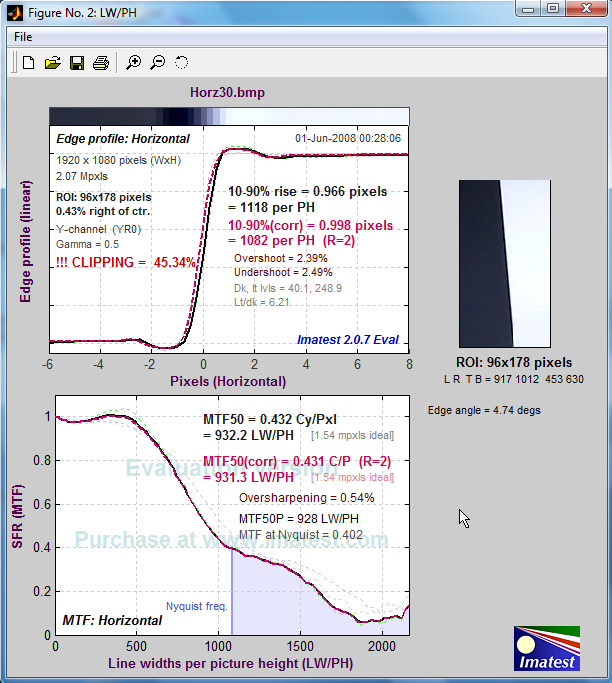

The numbers I have posted here all all taken from Imatest MTF50 tests. I have posted my FS100 results, but with the caveat that there was a VariND. It, may or may not have effected the test, however I would have expected to have seen closer numbers to the F3. I had not planned on measuring the resolution when I had the FS100, but as I did shoot a suitable chart I was able to subsequently take a look at the chart with Imatest and those were the numbers produced. As I don't have the camera anymore I cannot re-shoot the chart without the VariND to confirm the results.
If you look at my MTF50 test for the F3 attached and compare it with Tom Ropers EX1 test you will see remarkably similar results. I see no real reason why the FS100 resolution should be significantly different to the F3.
Upcoming hands-on comparison of F3, FS100 and AF100 from Philip Bloom-f3-h-mtf.jpg   Upcoming hands-on comparison of F3, FS100 and AF100 from Philip Bloom-ex1horz30.png
