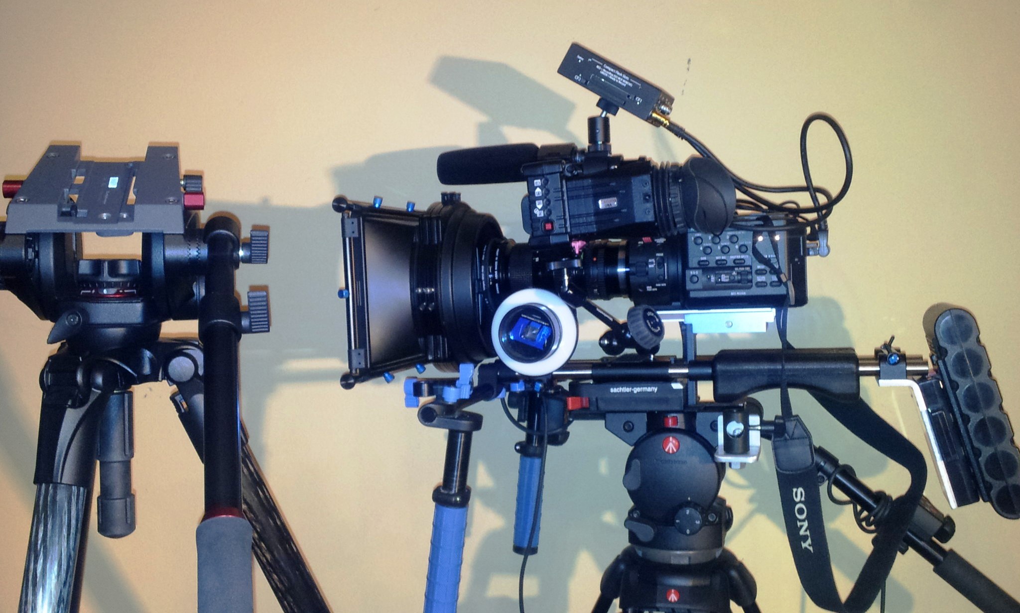

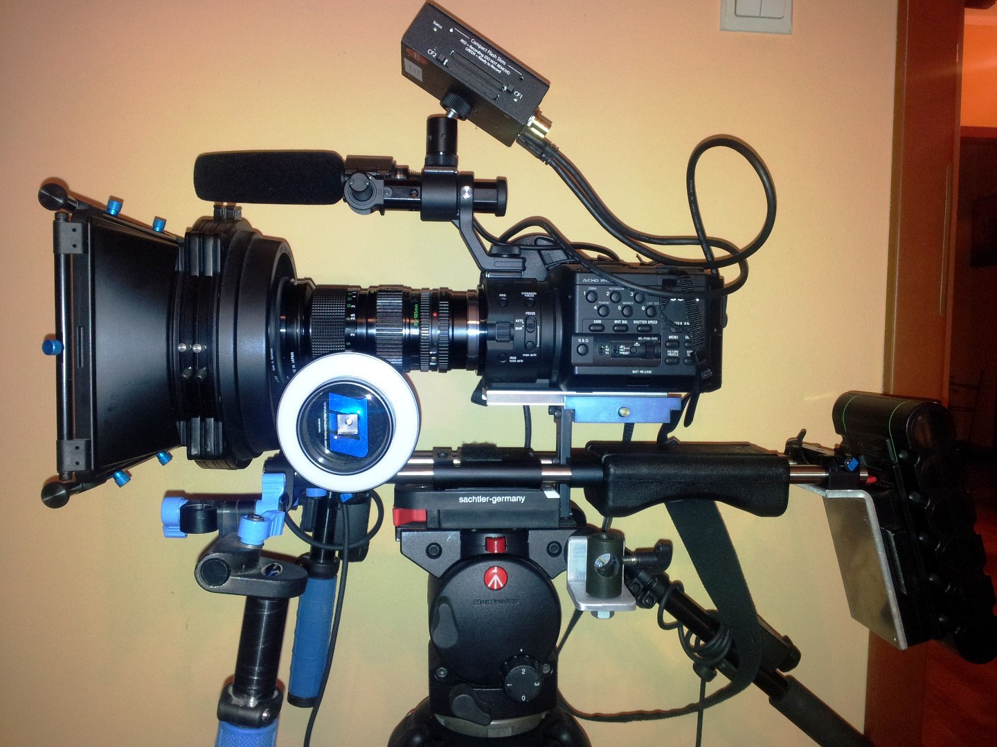

In the below pictures, my FS100 rig under construction
The idea is to get the shoulder pad underneath the camera (in order to balance it better on the shoulder, and make the rig shorter). This was achieved using my old Letus riser v.1 (still must go down some 10-15mm, to get in axis with the mattebox). Speaking of the latter: as can be seen, the RedRock mattebox is way too large (not to mention, heavy) - will probably be getting the Proaim MB-600, or even MB-300, instead. Apart from being smaller/lighter, they can be moved along the rails freely to accommodate the changing length of the lens - while one of the RR MB's shortcomings is it can not go backwards beyond a certain limit, as it would collide with the rails ...
As a side note: In the foreground, the surprisingly good Manfrotto 504HD head on the 535 CF legs - very smooth, and lightweight tripod. Ideal for camera-only usage! Its payload though is just 7.5 kg - not enough for the rig depicted...This is comfortably seating on the biggest Manfrotto head, the 526, which is rated at some 15 kg.
PS. Looking at my rig, please suggest a better way of attaching the nanoFlash... Mounting it at the hot shoe via a ball joint is only temporary, as it's unnecessarily high this way and spoils the rig's balance !
