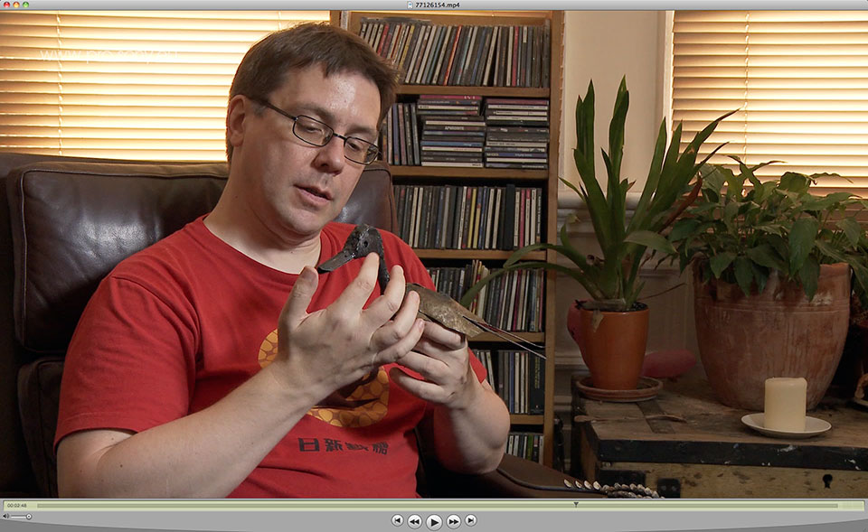

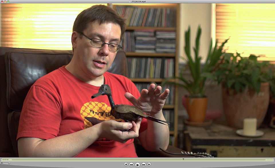

Having worked with the 5dii and 550D/T2i, I'd say that the FS100 is going to give you a more detailed picture, more tonality in the blacks, no aliasing or moire to speak of (though you can find it if you torture it), but you'll have slightly less of the 'Full Frame 35mm aesthetic' if you're into wafer thin Depth of Field.
Canon does a bit of magic on skin tones that the FS100 does not.
Canon have no problems with skin highlights, the FS100 does - and it gets 'fugly' quickly. Not as much as another camera I've come across, but it's why I'm trading up to the FS700. It's a very specific thing with highlights and the red channel clipping, but it's the difference between the two images (I assure you the Canon did the same as the EX1).
The FS100 provides a lovely slick 'corporate' image which can do 'indie' too when treated carefully. The Canons, the 5Dii especially, have a look but it's hard to steer them away from that. The foibles such as recording length and shadow detail mean that my shooting style is better addressed with the FS100, but nothing does 'talking head' quite like a Canon.
As far as sharpness, and the lack thereof between 5dii and 5diii, you can put that back with sharpening in your NLE (which is where it should be done if you have the time). There's something approaching 'trepanning' that you can do to your 5diii to improve its sharpness, but it looks too scary in the resale department for me.
I switched from EX1s to FS100 last year, and had a little run with EX1 jobs this month. I'm looking forward to going back to FS100 in terms of image and lens quality. Having done a series of interviews around Europe and Middle East with a T2i earlier, 'rustic' black and shadow handling, and golfball grain in low light, makes me wish I could have taken the FS100 instead (job required 29.97 throughout and I bought a PAL FS100 - irrelevant now, of course).
NEX-FS100U compared to Canon 5Diii-highlights-fs100.jpg   NEX-FS100U compared to Canon 5Diii-highlights-ex1.jpg
