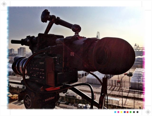

2) EVF on a Noga or similar jointed arm - I have a Zacuto EVF which either 'hangs off the back' in R&G mode (see image), or droops down to the side on a high tripod if doing conference records (i.e. long periods of filming stuff that doesn't move much).
I've stopped using the 'chimney' hood altogether. The FS camera body has to be seen as a lego brick, the basic first unit in a system you'd build up per job. Which is my weasel way of saying that an EVF is, IMHO, a sort of essential accessory, and cheaper than physiotherapy on cricked necks.
