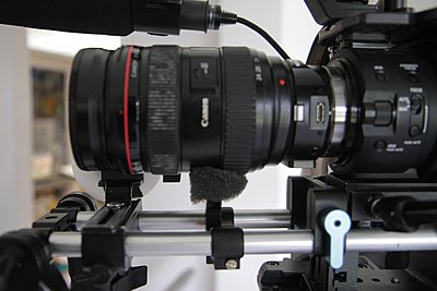

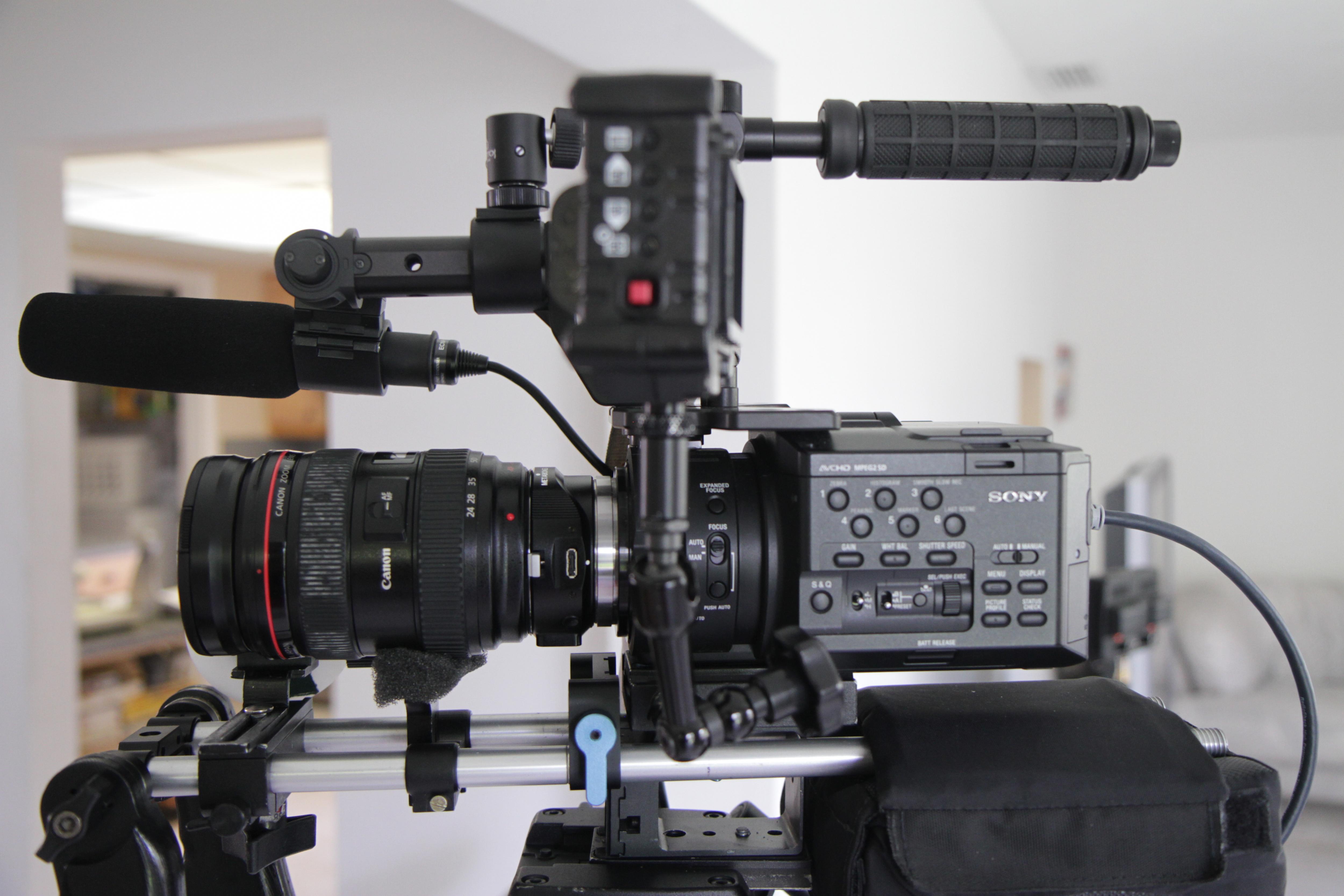

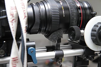

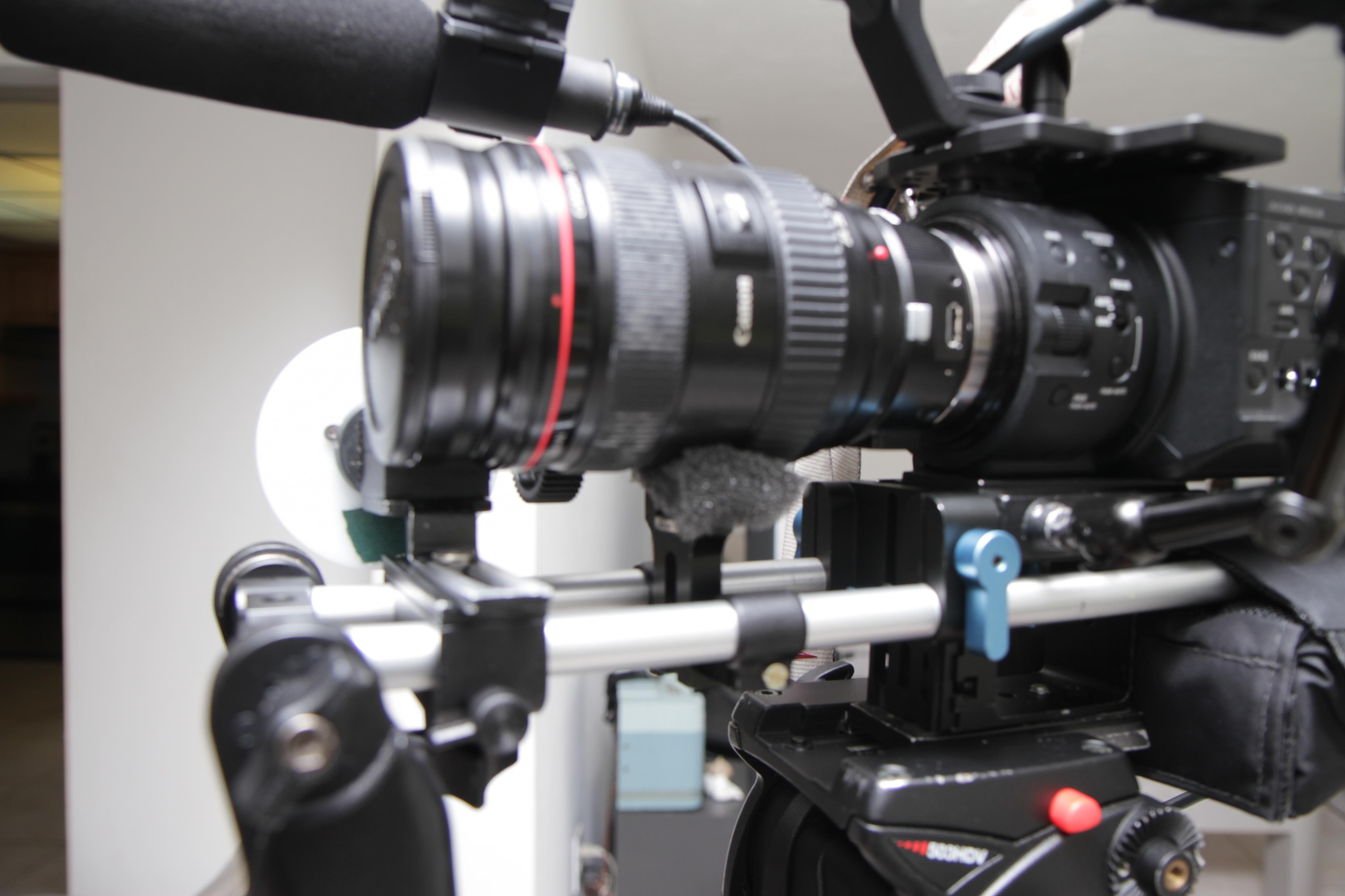

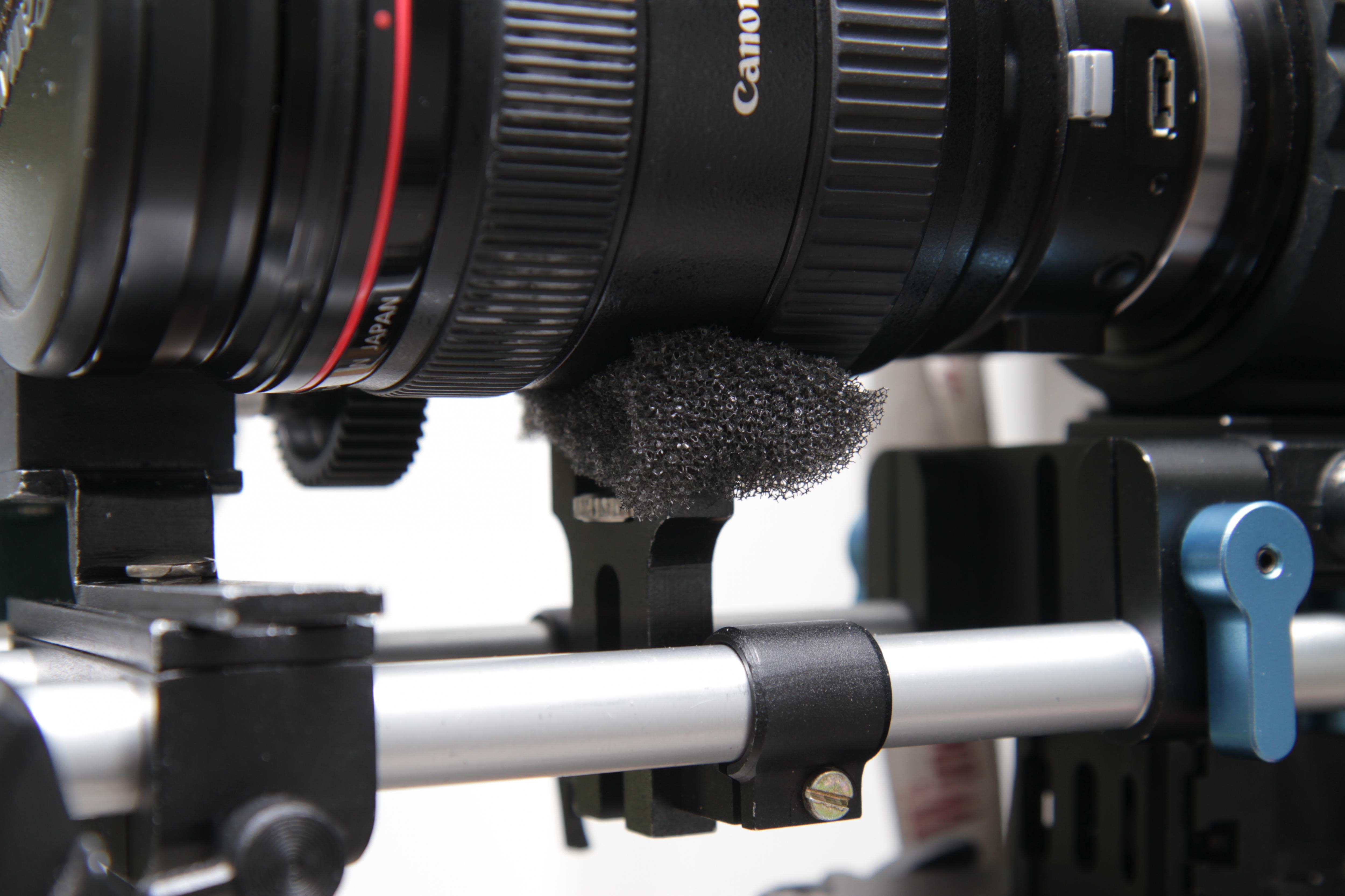

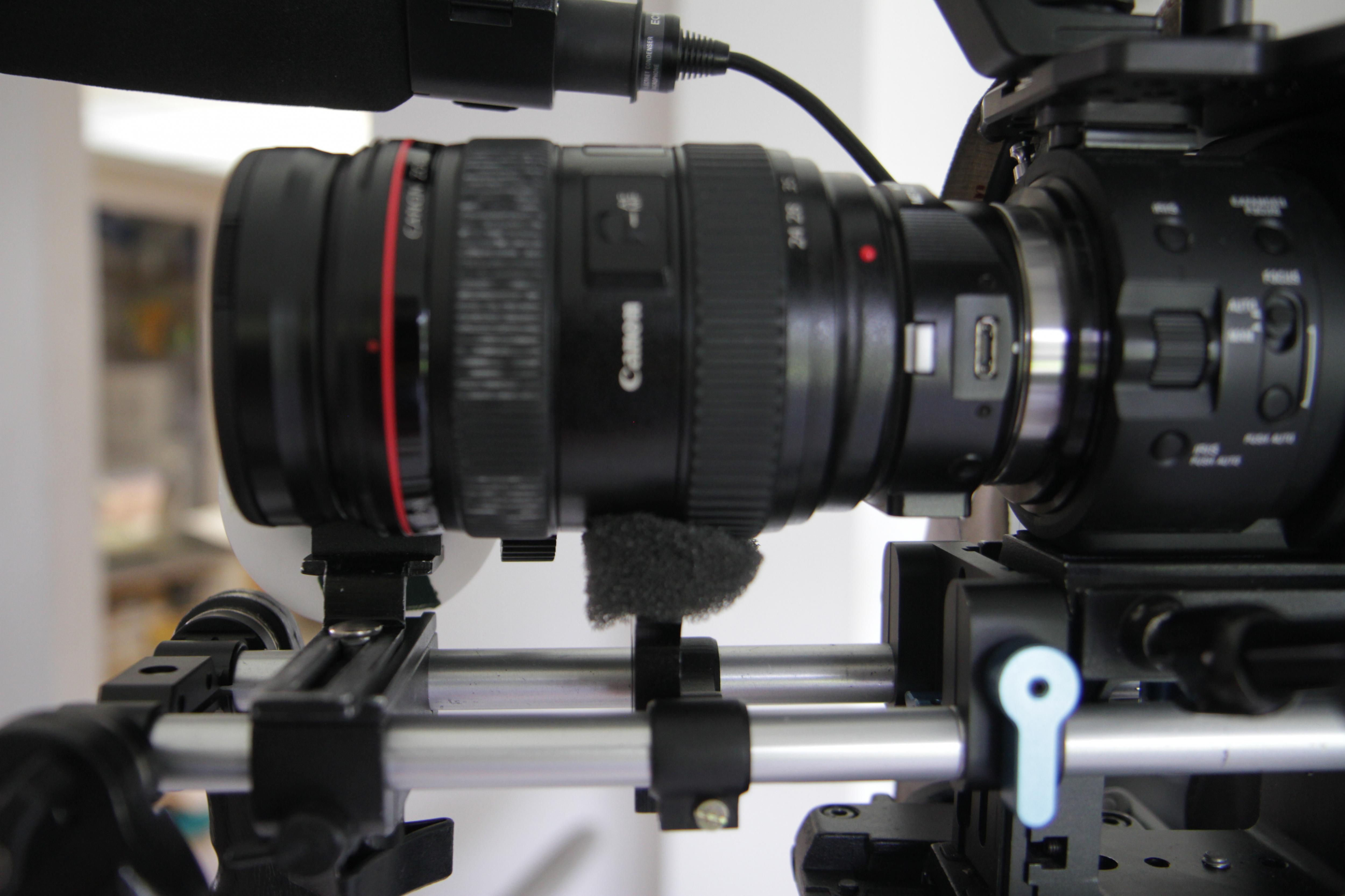

Here are some pics.

Let's see if this works.
What you see in the picture is my basic rig ( thanks Jean Phillipe) which is made up of
1- A genus mounting block
2- rails
3- Cavision handles
4- Indian follow focus
5- a potabrace pad
6-berkey system mounting plate and handle
7- Small hd mounting arm for Zacuto monitor
8-Zacuto monitor and z finder.
9- Lens support that I bought originall from dvtech in Isreal with another rig.this support slides onto the rails and gets tightend down, then height adjusted.
10- Metabones adapter for Canon lenses.
I borrowed a friend's Canon 24-70 f2.8 lens ( beautifull) but very heavy. The lens support slides on the rails and is height adjustable. It also has a thumb screw for additional micro adjustment. To protect the lens from the tightening bolt scratching the finish, I wedge a little pice of foam between the support and the lens. I didn't need a follow focus ring for this lens , because it's wide enough so that the ffocus gear reaches the focus ring on the lens itself. I wouldn't risk mounting a lens this heavy ( opr my 70-200 f2.8) without support. Maybe it's overkill, but I'd rather be safe than sorry.
