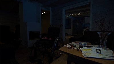

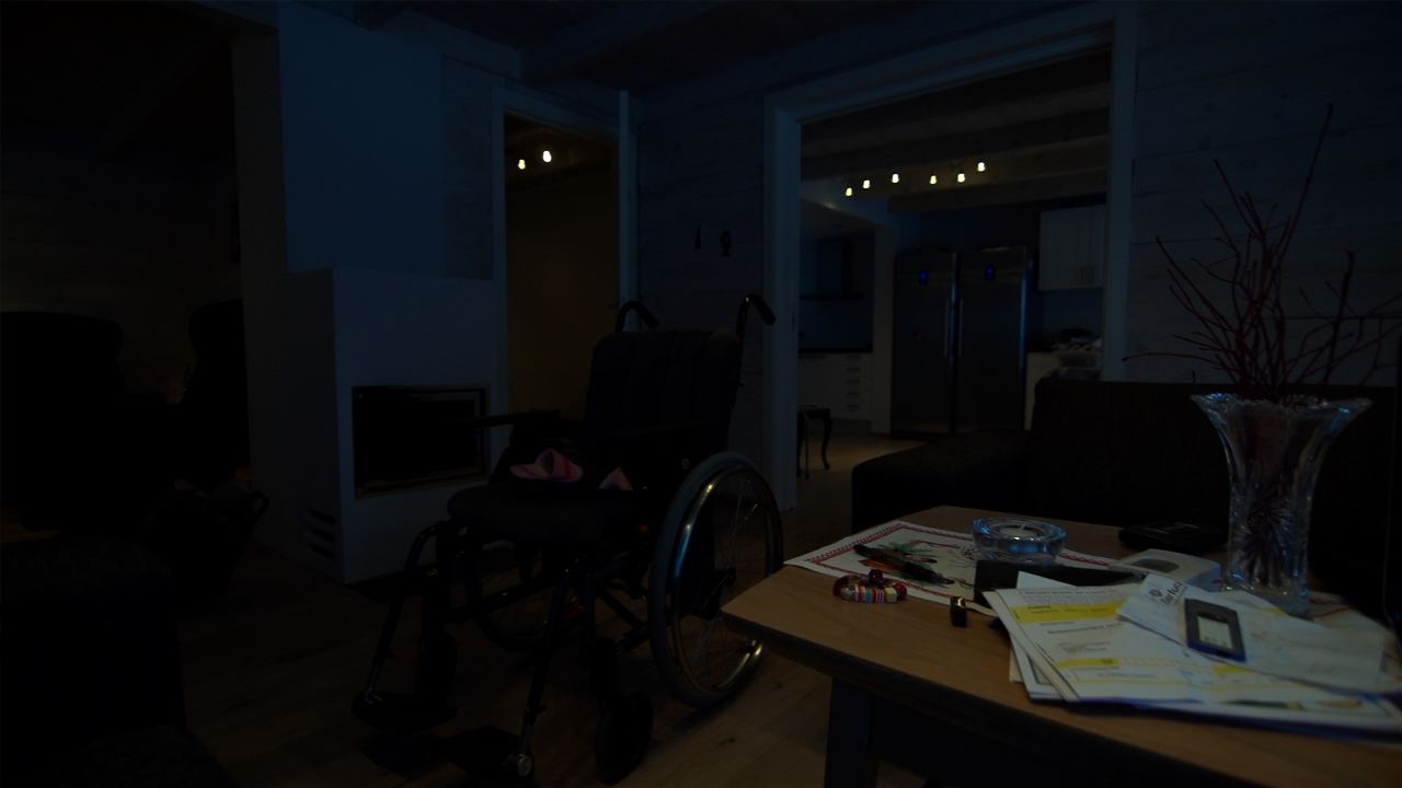

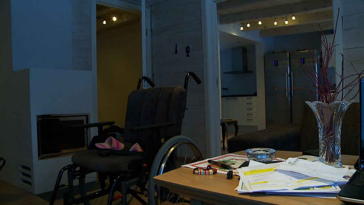

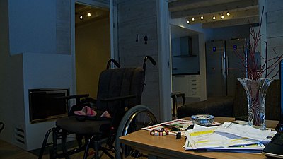

Hi.
I am wondering if my FS 100 has a low light problem or if there are some settings I don`t understand. Shooting with my EX1R alongside my FS100, my EX1R gives me a brighter image when set to default settings. I have attached to JPEGs to try and explain.
The EX1R has the following settings:
F2.8, 0db,1/60, Doug Jensens Picture profile ( from training DVD )
The FS100 has the following settings:
F2.8, 0db,1/50, Doug Jensens Picture profile ( from training DVD ), Metabones Adaptor, Tokina 11-16
It was my understanding that the FS 100 would be the King of low light. Is there something about the gain I don`t understand?
Any input appreciated.

No, there is no ND- filter on the FS100. Or, well, there is a variable ND- fader filter from Genus on the lens, but that was set to minimal or no ND.
If I turn the gain up it is better than the EX1, cleaner image, but I sure wouldn`t trade my EX1 at this point for an FS100. I would just add lights.
6 db is as high as I would go on the EX1, 9db is acceptable, but doesn`t look nice. Or at least that is my opinion.
On the FS100 I can go as high as 21db, but that was connecting my camera to my 32" Samsung TV via HDMI and just looking at the image. Not sure how that would hold up in post.
I believe I read somewhere that the native ISO on the FS100 is 800. Not sure what that means in db. I wonder if a firmware upgrade would improve? Maybe my FS100 should be set at 9 db, maybe that equals 0 db on my EX1. Maybe the db settings are just"off". Just a tought as these are different "families" of cameras.
As of right now I am a little frustrated as I don`t know what is wrong, or if this is as good as the camera gets.

Umm....sorry to break this to you but there is NO zero setting with ANY variable ND!!!
That's one of the disadvantages of having no built in ND, there is NO 'off' setting on
any ND filter you put on the lens. The Heliopan gives you 1-6 stops of ND, in other
words, when you turn it to the 'minimum' it is still giving you a stop of ND. The Genus
on the other hand, gives you 2-8 stops of ND, so in other words if you have a Genus variable ND
on the lens, even when you set it to 'minimum' you are STILL getting 2 STOPS OF ND! Take
that variable ND off the lens and look at the difference!!
Gabe Strong is offline   Reply With Quote
Old January 8th, 2013, 04:05 AM   #7
Location: Fidjeland, Norway
Posts: 289
Re: Low light issue FS100 vs EX1
Gabe.
I feel embarrased. You are completely correct. I bought it as a package. When the lens arrived I put the ND- fader filter on, then attched the Metabones and then the lens. I did this on a bright day, so didn`t notice anything wrong. Till I wanted to shoot inside.
What a relief....
Here I have been messing with picture profiles, gain settings, trawling the web and.......
Thanks. Thank you so much. I didn`t realize the filter went from 2-8 stops. I just bought it and was happy to have found a solution.
Looks like I will be buying a mattebox instead.
Svein Rune Skilnand is offline   Reply With Quote
