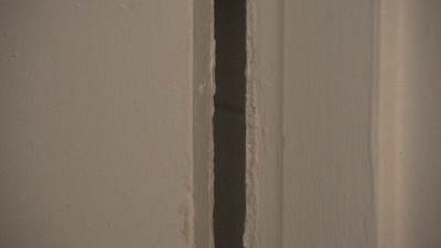

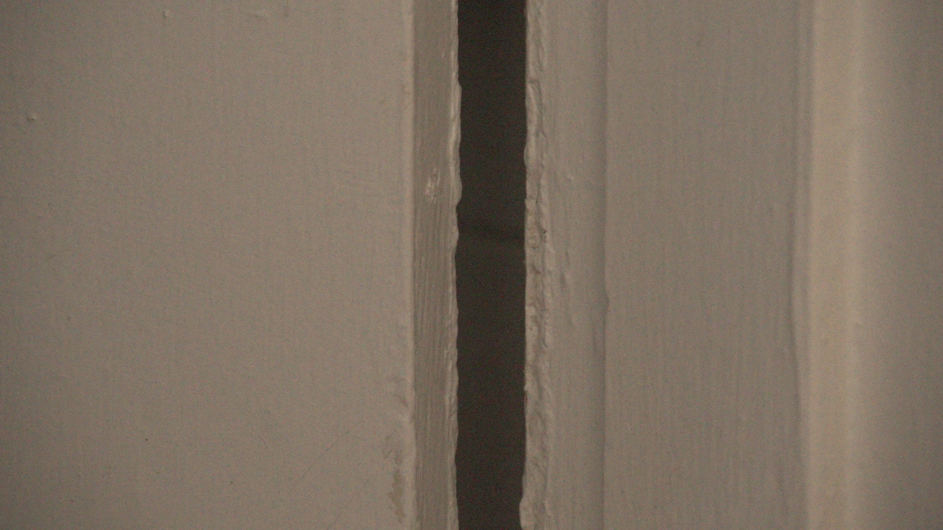

I had a nanoflash hooked up to an FS100 and did unsystematic tests for a few days, and the difference in the grain quality was very significant. I specifically shot stuff at 24 or 30db in smewhat bright situations (stopping down the lens and using ND filters) to see how things looked like -- the grain was very attractive to my eyes, not distracting at all, and made the footage less unnaturally perfect. In low light the difference was also very clear.
Very sadly I don't have that much to show you aside from a couple of screen grabs (first at 30db, the second at 24db) from my brief experiments. The FS100 HDMI connection is not secure, and nanoFlash can't read its time-code or be triggered, so in the end I gave it up. (The Ninja, which can be triggered by the FS100, is too bulky for me.)
And in regards to motion rendition, I still am not sure what is meant by it (I am aware that it's an important but hard to define thing from many forum discussions), but I remembering finding the nanoflash footage more attractive with sudden drastic camera movements as well as sudden transitions between light and dark, and these probably pertain in some way to motion rendition.
