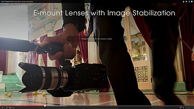

The factory mic mount / grip is frankly ridiculous. I don't believe anyone has ever really used it as a real grip since that unreasonably tranquil cinematographer in the Sony promotional video (screenshot attached). It makes me laugh.

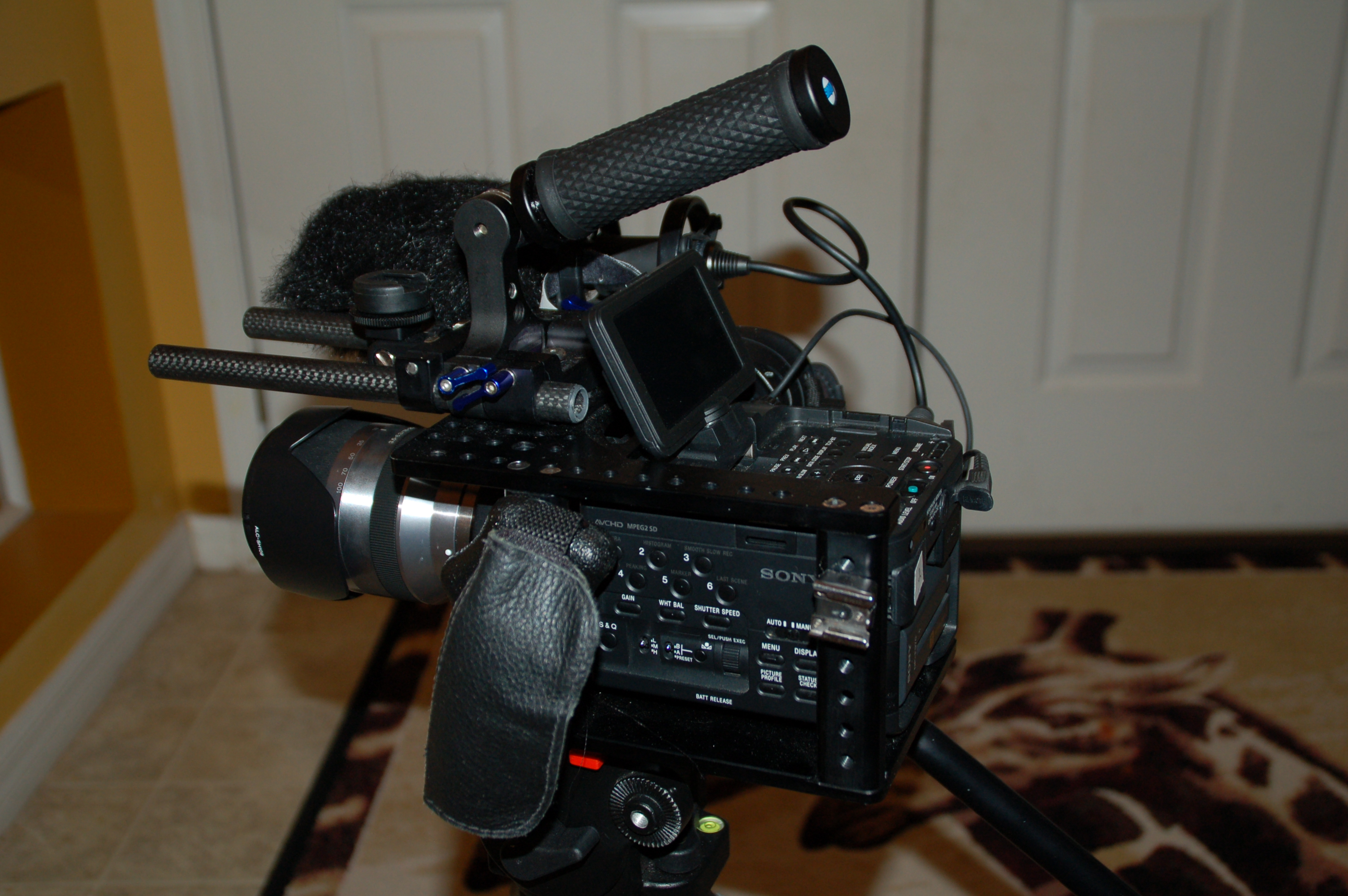

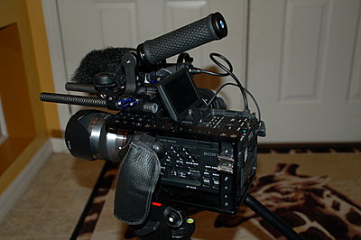

I got this cage and added a few of there accessories. Master Cinema Series :: MCS Cages :: Letus FS100 Non-Powered Cage -
Dan
