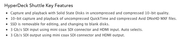

It's going to have to be 50 or 60p. Not many will want to wait 80-90 seconds before being able to shoot another shot. The Gemini and Hyperdeck Shuttle 2 can do it. My full review is online now A Second Look at the Sony NEX-FS700. | XDCAM-USER.COM
Alister, are you sure the Hyperdeck shuttle 2 can do it? When looking at the specs I only see a normal HD-SDI input, not 3G. Don't you mean the Hyperdeck Studio?
You are correct Cees. The Shuttle 2 cannot do it. In BMD's press release they say it can, when in fact it can't.
