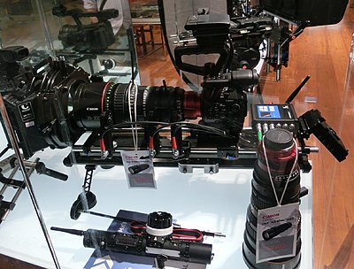

If money is no object...
Spotted this C300 at the mall with a Chrosziel Aladin MKII 3-Axis Wireless Lens Control System.
